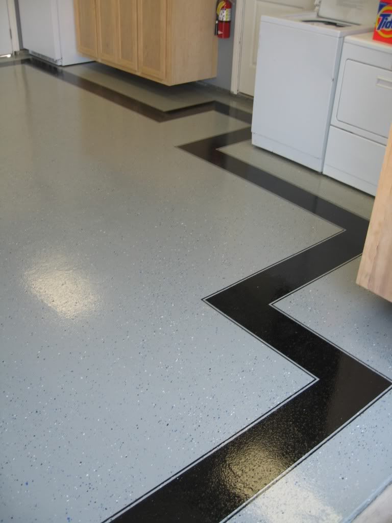

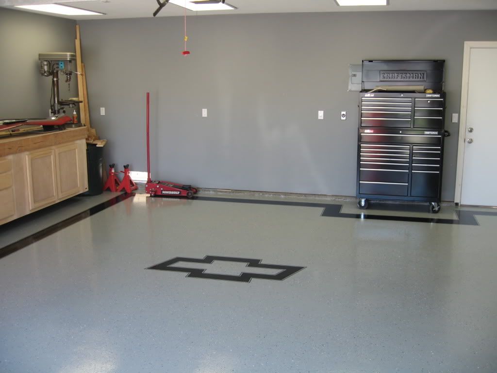

these were right after i was done about 5-6 years ago.....

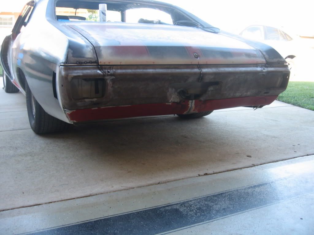

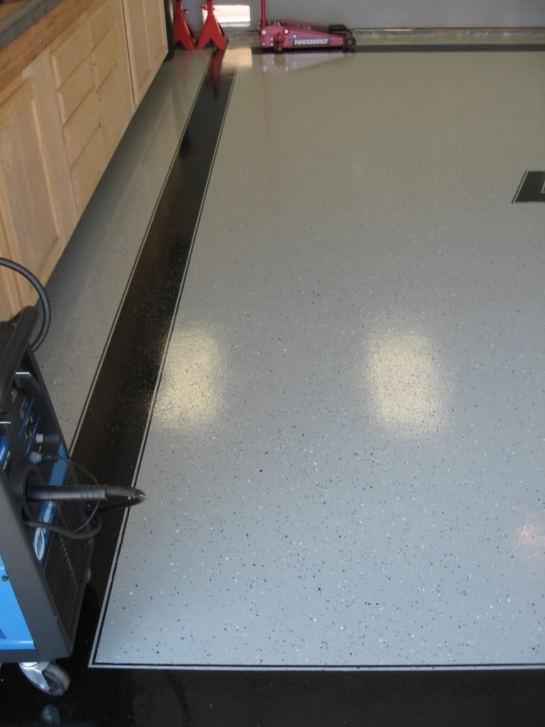

and heres an example of what it looks like today. the last couple inches sit outside the garage door and dont have clear anymore and you can see how the color has yellowed and gotten all scuffed up. its still better than nothing, but i will redo them when the car is done.
