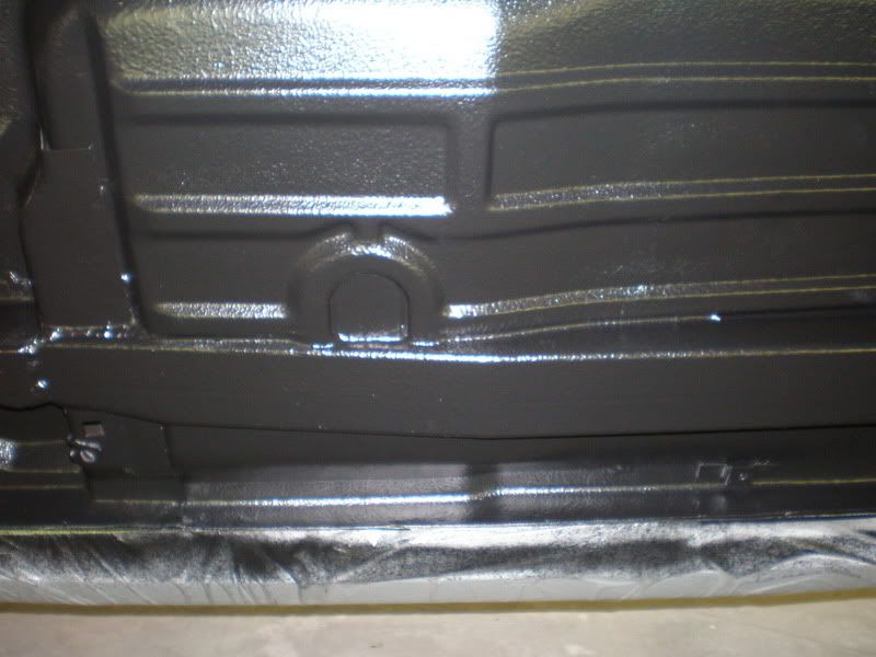

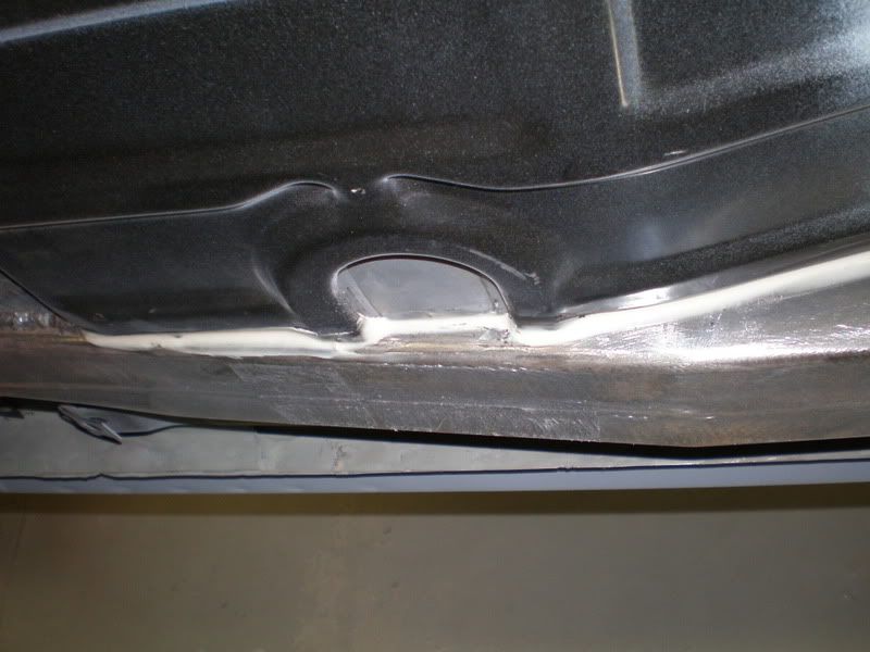

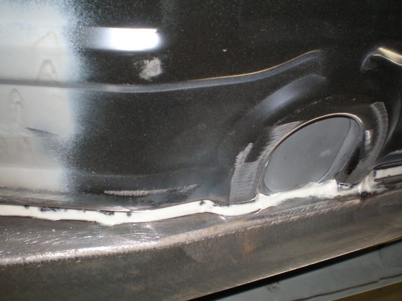

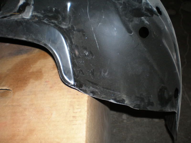

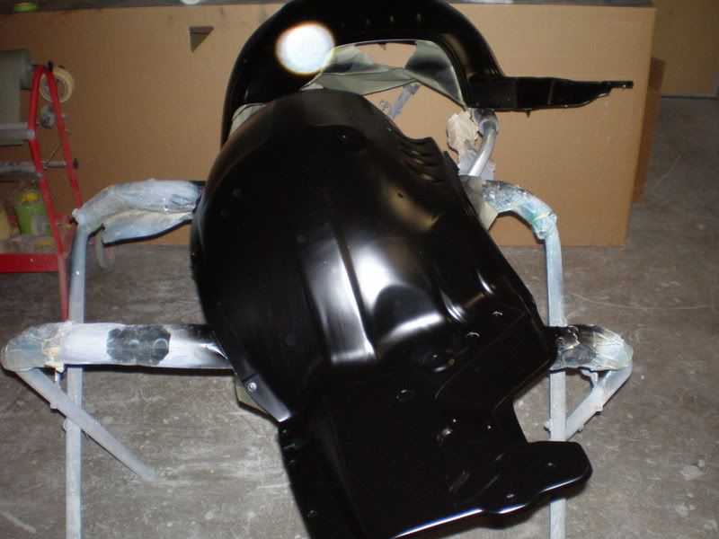

Not too much or too exciting, but a little progress. Most of the time has been spent on little assembly tweaks here and there, final blocking and getting ready for the paint booth…
Couple of earlier/missing mock up pics
Clearanced the inner fenders
Drain plug cut/weld install and seam sealer where possible…

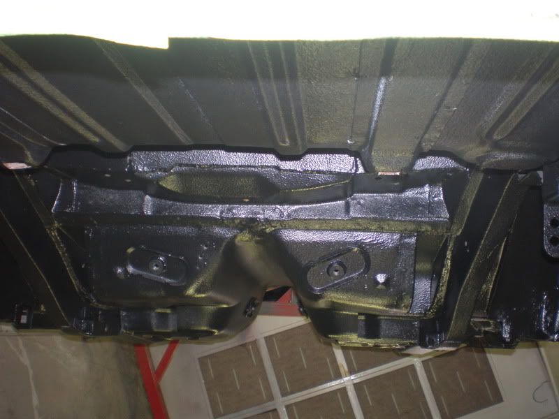

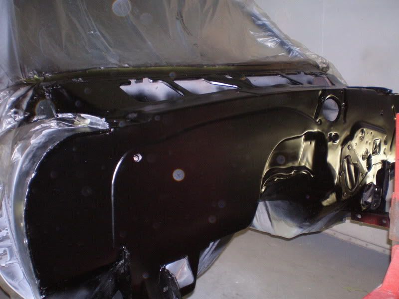

We decided to shoot the engine bay first…
And masked off a clean line at the bottom of the firewall for UPol. We reduced the UPol 15% to get a little smoother finish
We’re at the point where the body gets final checks for highs/lows and into the paint booth in a few days. I cannot wait…
