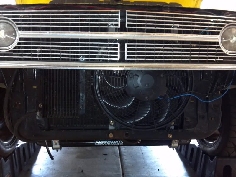

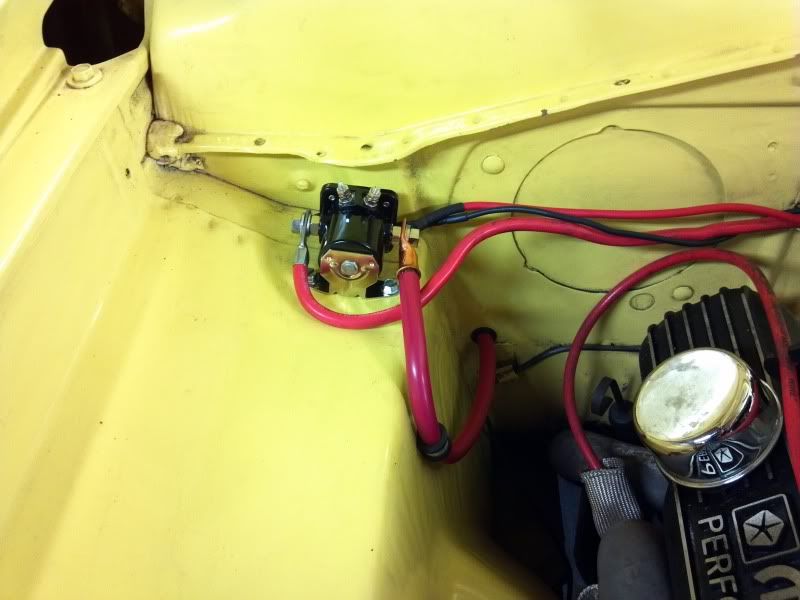

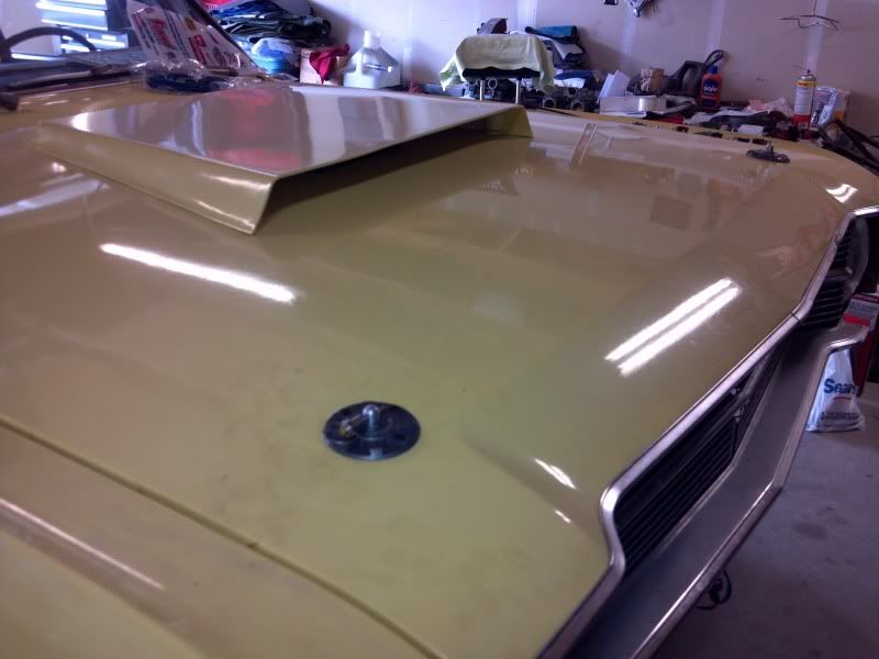

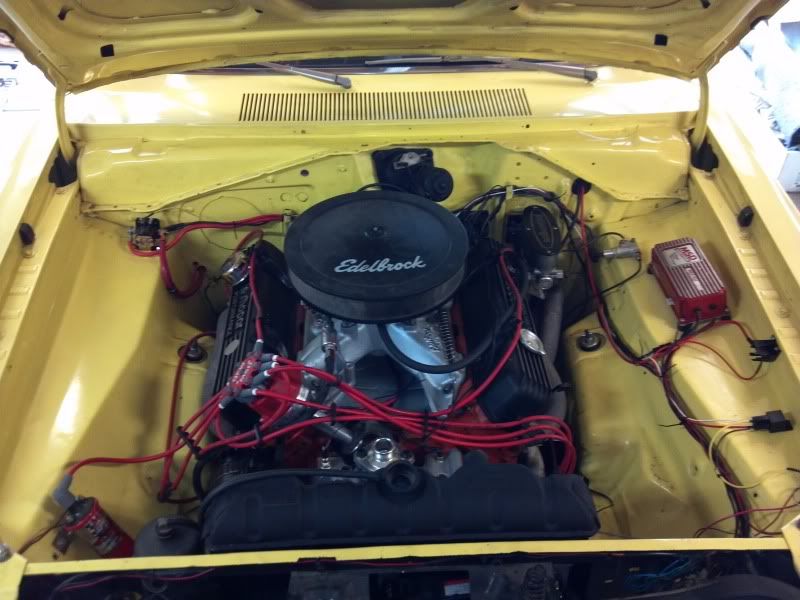

Its been a busy week getting everything ready for RTTC3 and the Mopar open house at Hotchkis. Here is a bit of a recap:
The cluster came back from Redline Gaugeworks
And this gets taken care of...
More work on the coolers and fans, as well as some touch up on the radiator.
More wiring work under way.
Some flair.
