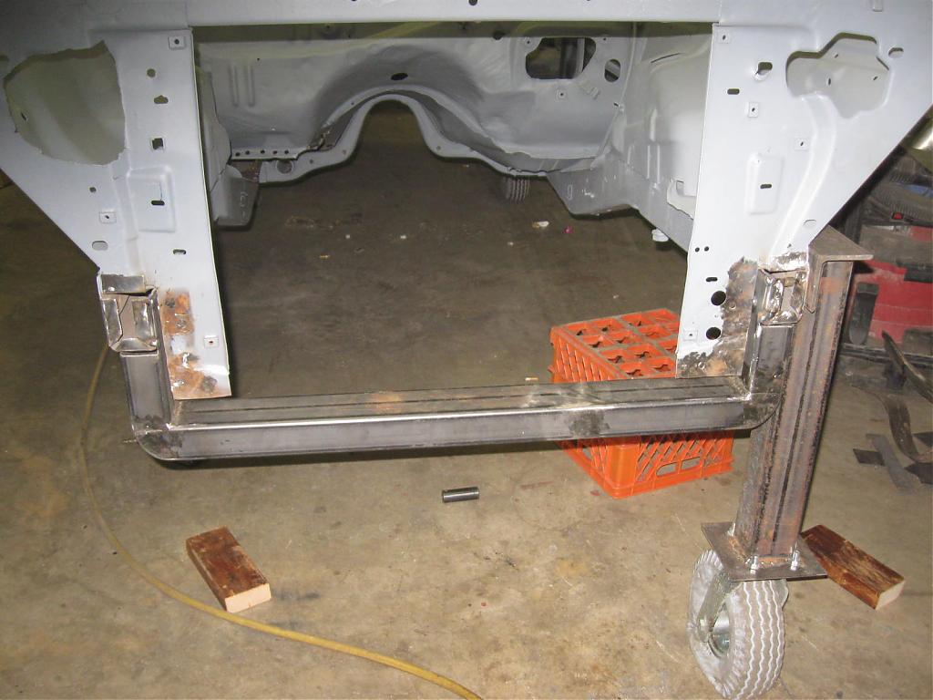

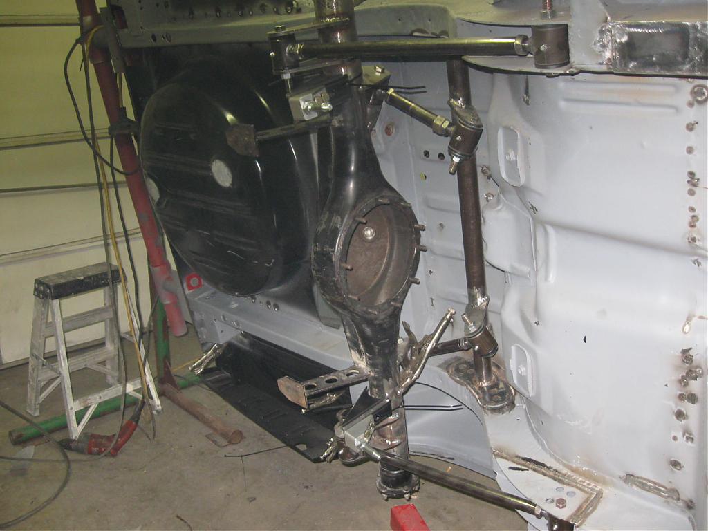

nothing good to post pics about right now... Just basic panel replacement, frame rail connectors, new front lower rad support, new floor pans, new trunk floor, triangulated rear end..... Here is the final design I am working towards... Next phase will include installing the Alterkation front end which has been sitting in my living room for a couple months now. New 1/4 panels, door handle mods, new rear wheels will be bought... I already have the tires.. Then cut a huge hole in the cowl for the GEN 3 to sit in there and start a whole part of the build of how to make it work..
