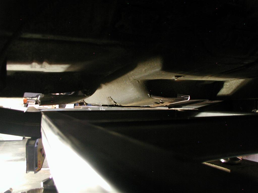

Cut the rear inners out and chopped the subframe back so I could fit the rear tires in. I also stripped the 914 last weekend so I am going to get plowing forward on this project with some more steam now. Will start fitting suspension next. Here are a couple quick shots with the race wheels and tires that will be on the car roughly fitted and blocked up to actual ride height. I can tip the front tires at -1deg to -1.5deg and keep the bottom out for track width while getting enough clearance from the fender to turn the tires enough to get around a track. Won't be busting U-turns with it unless they are 3 pointers but that doesn't bother me for a hot rod.
I think it will look pretty bitchin' even at the higher ride height. Still need to figure out how I am going to get the rear tires off with the IRS, I will have to make it so it can easily detach limiting straps so it can drop down 4" per side. I will also have to lift the rear as a unit so the sway bar droops. PITA making a car that serves two purposes v. just a track car - I would just get fiberglass rears and Dzus 'em on.

Plan to run my NASCAR dual core double pass radiator and keep it low and slanted as shown in the pic. Keep all the weight as slow as possible. I will need to find a good body guy to make a front spoiler so I can duct air from below the bumper into it as well. The oil coolers will mount low in the front as well. I will just block off the upper part of the stock opening. Maybe I will just cut the core support a bunch and skin it, we will see how motivated I am to do that in the future.
