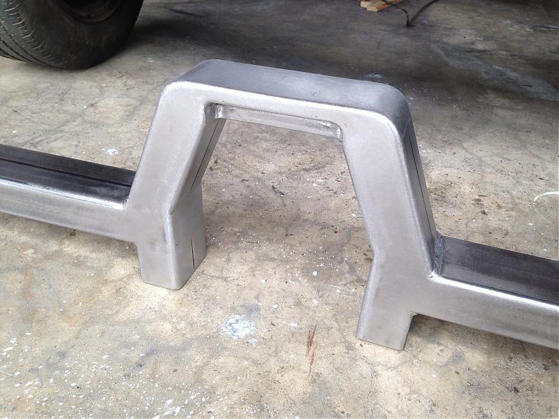

Added the notch on the bottom side of the top center.

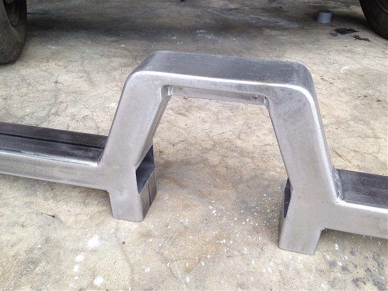

Filled in the inside open ends with some 1/8" plate. Should be ready for permanent installation.

At this pace you'll be done in no time. Cross member & frame connector look good
Thanks Frankv11. What do you think of the notch? Does it look like it will work? I'm going off of pictures and posted measurements as I don't have a T56 yet. I notched it 1".

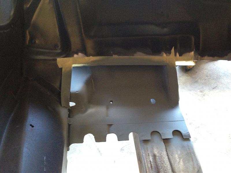

I cleaned up the toe kick structure and torque box before the floor went in for the final time.

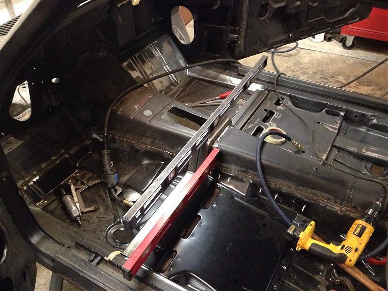

Final crossmember install. I used blocking under the car to make sure the seat pans and crossmember were level before tacking
