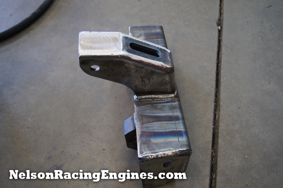

Slick sway bar mount, did you get a new fab guy?
Actually Chrysler had the stupid offset to clear the power steering box. Lazy bums. LOL
Actually Chryslers had the stupid offset to clear the power steering box. Lazy bums. LOL
Thanks Vince yep the Hemi was way offset .We currently have our fab positions filled but are looking for another Master sheet metal man

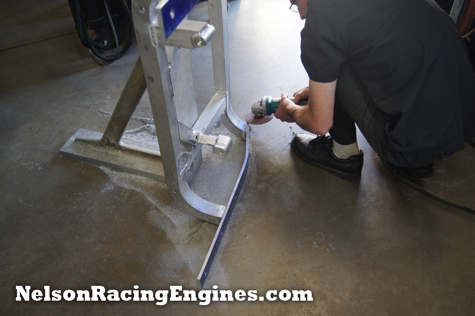

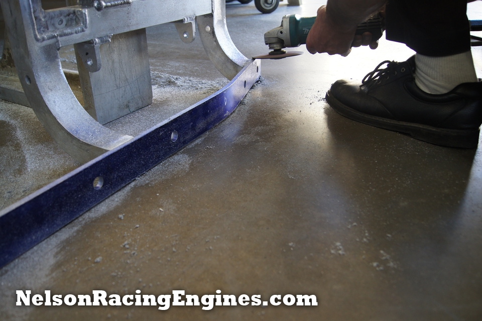

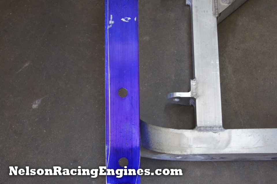

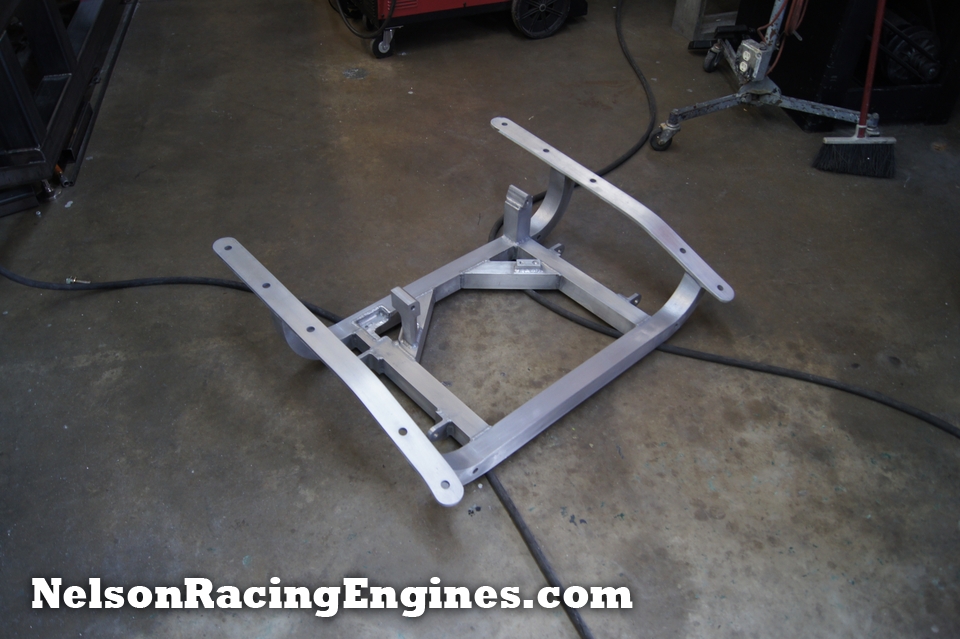

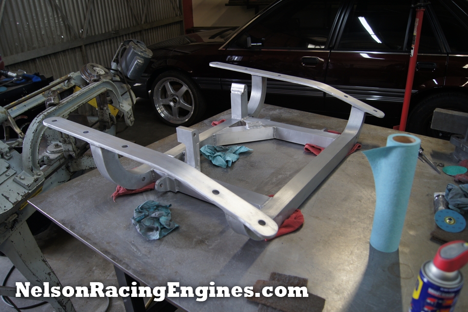

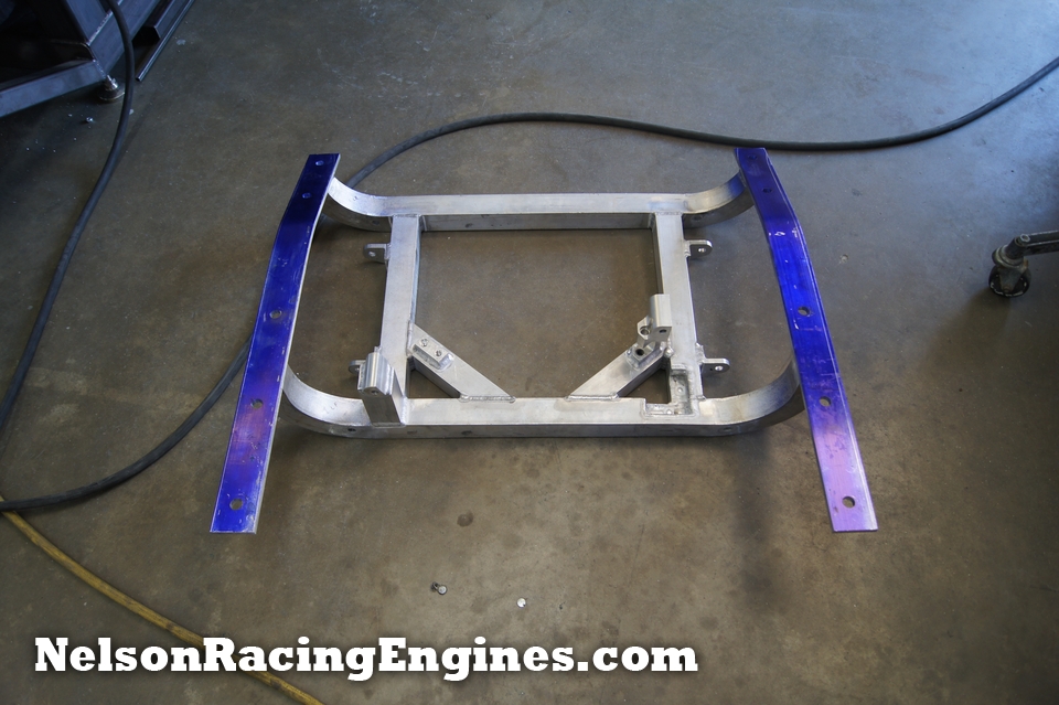

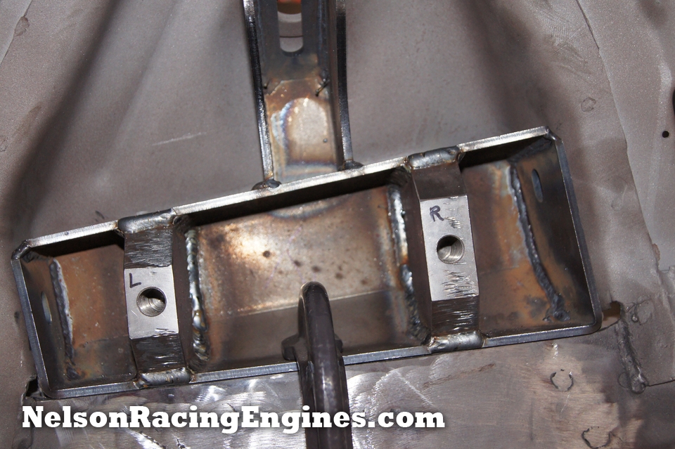

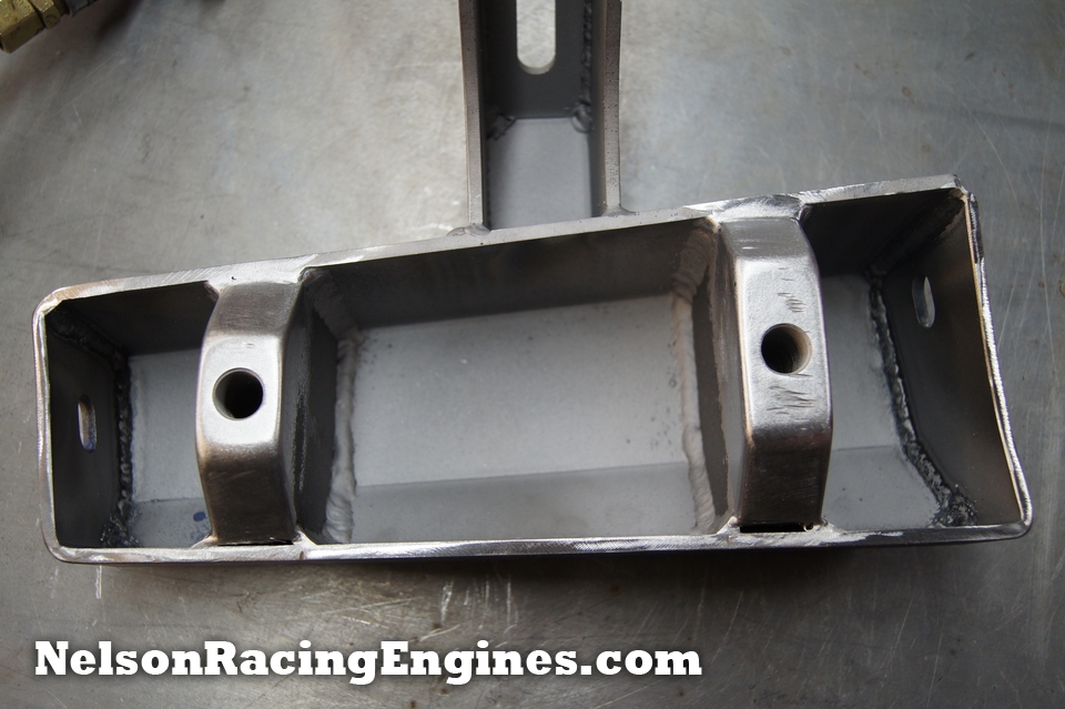

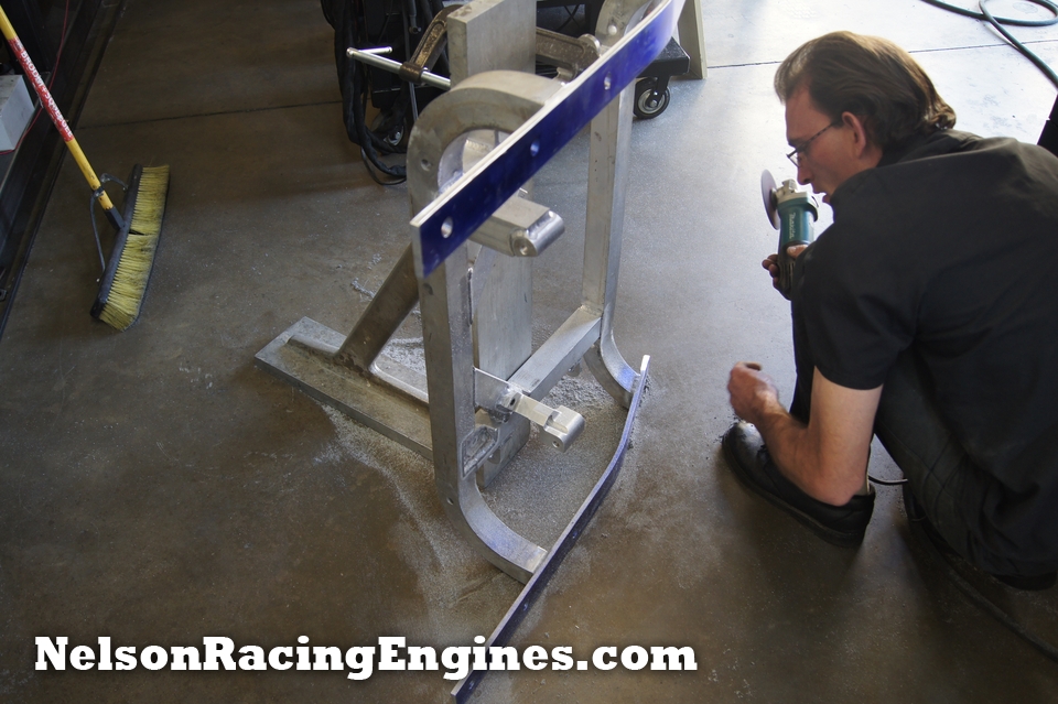

Here's some shots of the front suspension and us dressing it up a bit We got a Xv Subframe with Billet arms and Vette spindles pretty cool stuff just wanted to gussy it up a bit before we installed it.

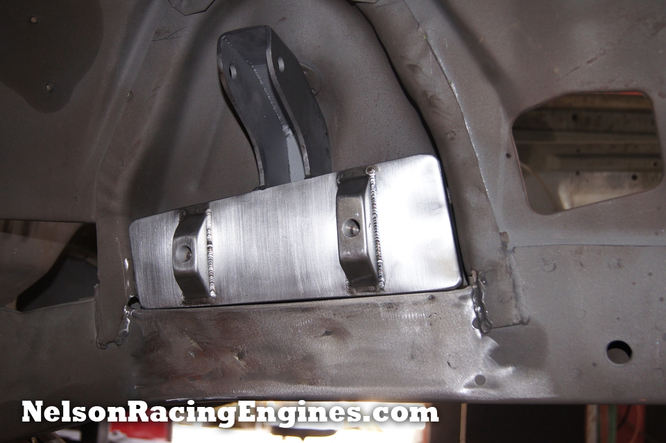

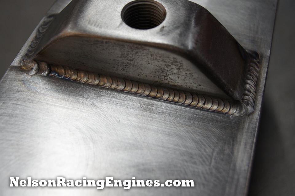

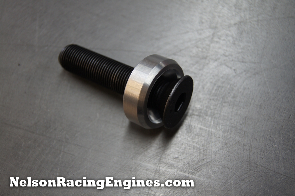

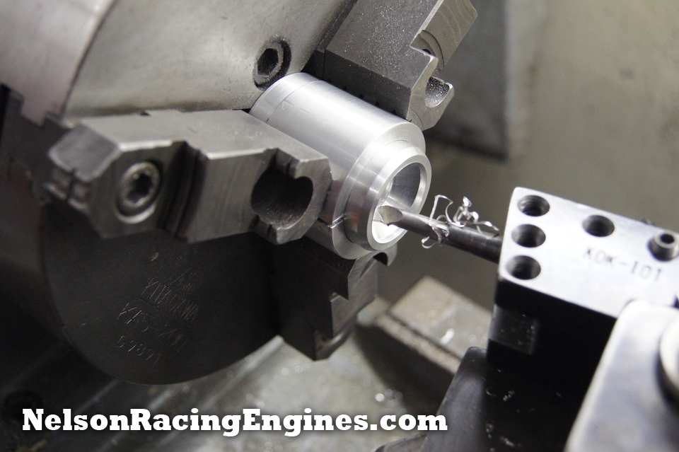

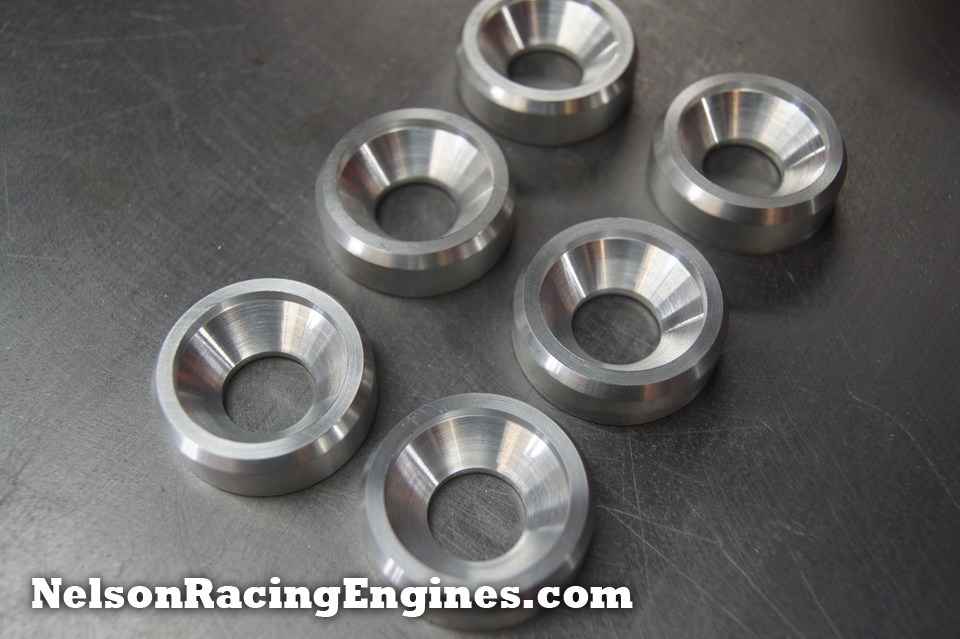

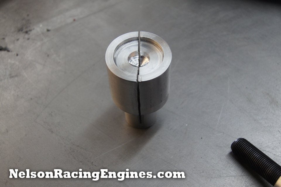

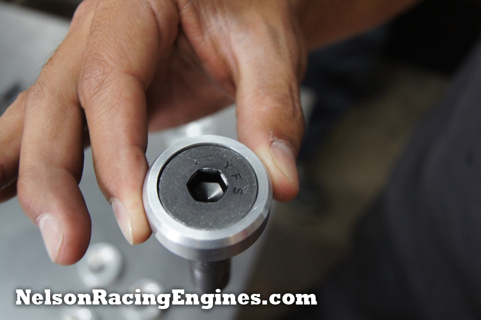

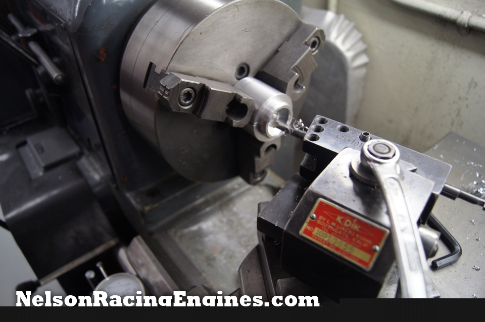

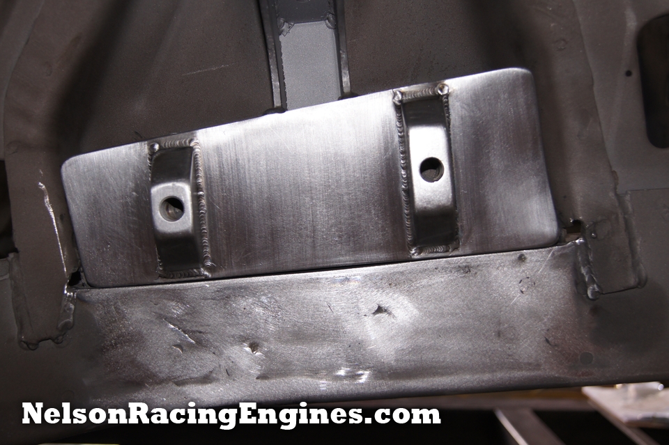

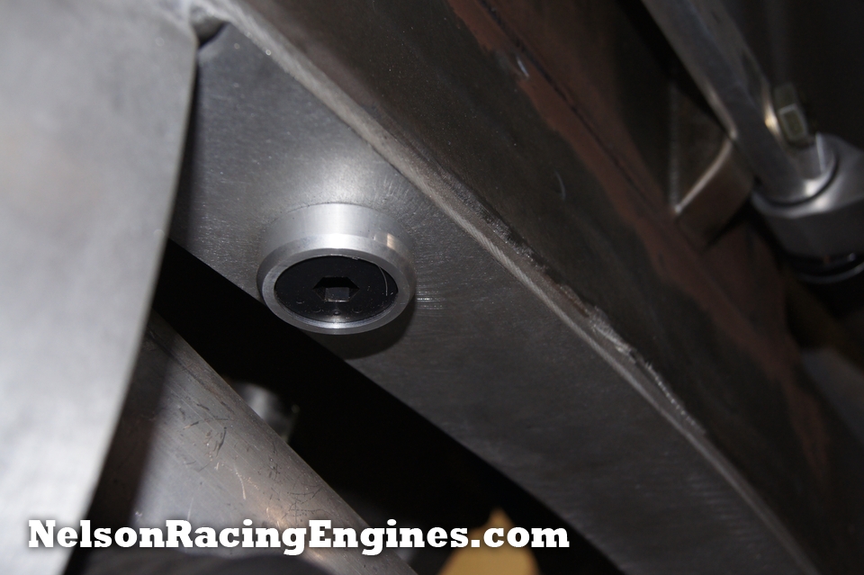

Some neat washers we made to bolt up the subframe we also welded in solid threaded insert in the frame so you would not see the thru bolt from the top side of the frame.

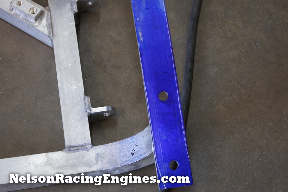

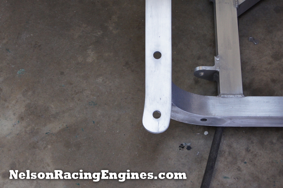

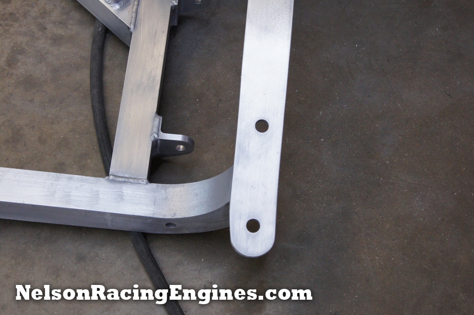

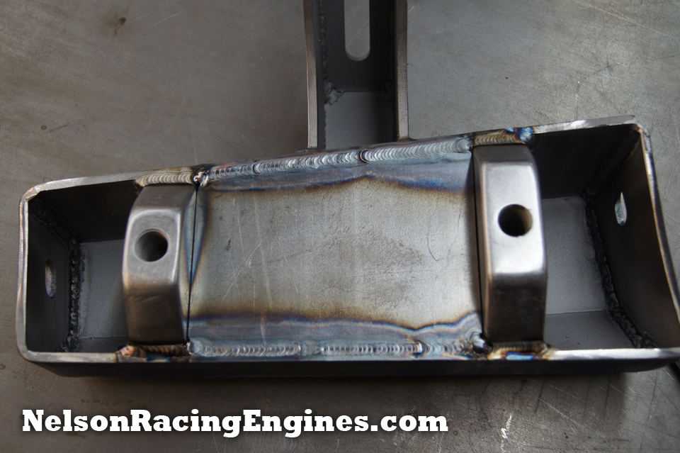

Heres a few more showing how we contoured the K mamber to match the car frame and how we fastened it to the frame Thanks guys for all the positive comments
