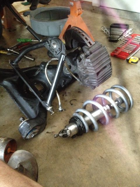

A little more of the progress
Cleaned up the fuel lines, reinstalled the fuel tanks. I rerouted the battery cables and fuel pump wires from under the car to inside the car. I also had to extend the driveshaft 1.5 inches to fit the new yoke.

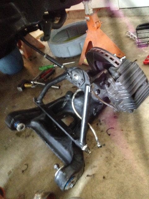

Finally, I also spent a little time pulling the front suspension off. My buddy is going to buy all my hold stuff (front, rear and wheels/tires) for his 73 Bird so it really helps my budget (or lack there of). This week I hope to get the spring pockets cut out for the Chicane kit so I can prep for the next round of parts.

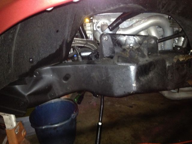

Front Suspension fully removed.

I forgot to mention above that I also bought the high clearance front sway bar as well to fit the big meats. Next big picture post will be all the new front end pieces.
