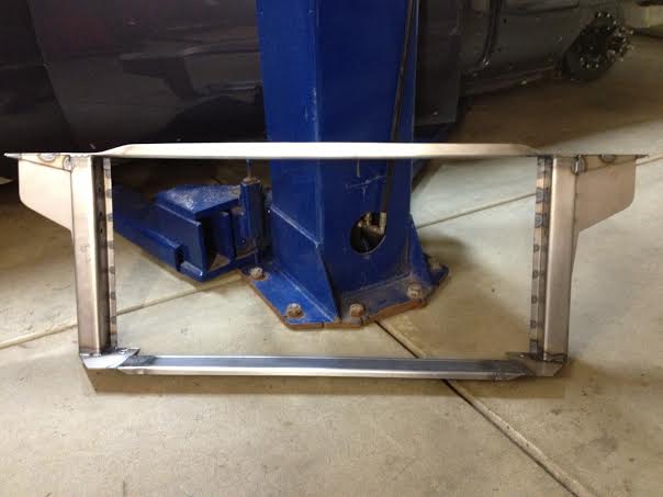

Thanks!!! A bit more progress. I built a new core support which gives me a bigger opening for a radiator.
Now using dual fans from a 2010 F150. One 15in fan and one 14.5in fan and they flow a ton of air.

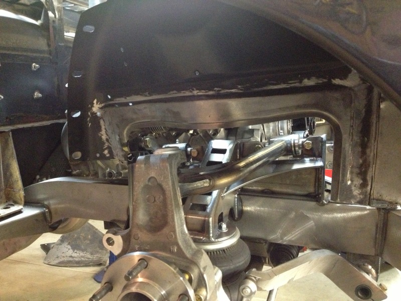

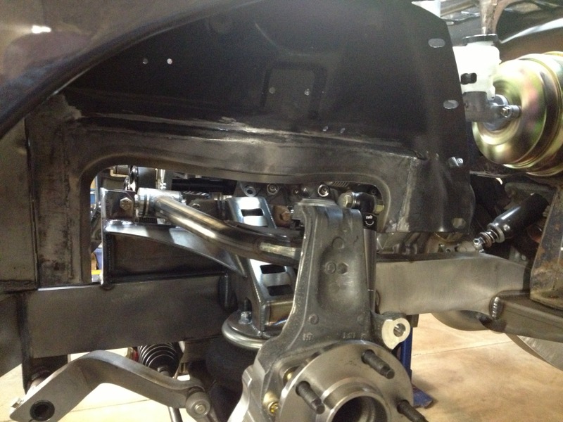

Didn't get much done this weekend, where does the time go.
Modded the inner fenders to match the RS front suspension-
