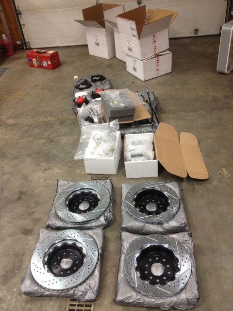

Default brakes
still working on getting the rotors and calipers installed...
thanks for your interest!

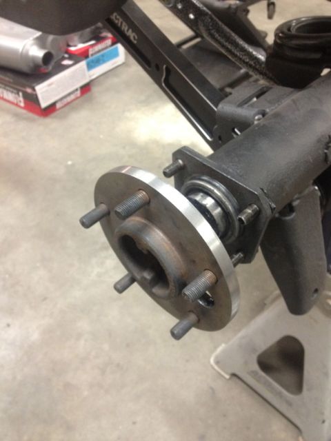

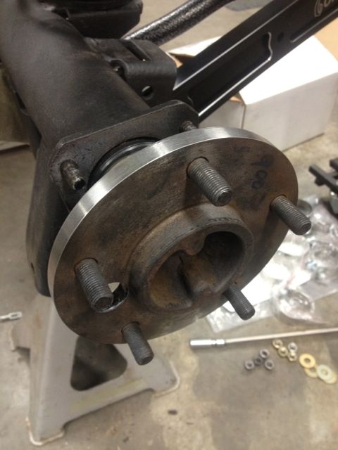

Default axle shafts
the flanges on the rear axle shafts were almost 6.5" in diameter, but baer specs a max dimension of 5.9" for proper fit within the rotor.
the machinist turned them down with his lathe yesterday.
it looks to me like there is enough material behind the wheel studs for this to work alright, but i'm certainly not an expert.
does anyone have any input on this one?
thanks so much for your help.
danny
