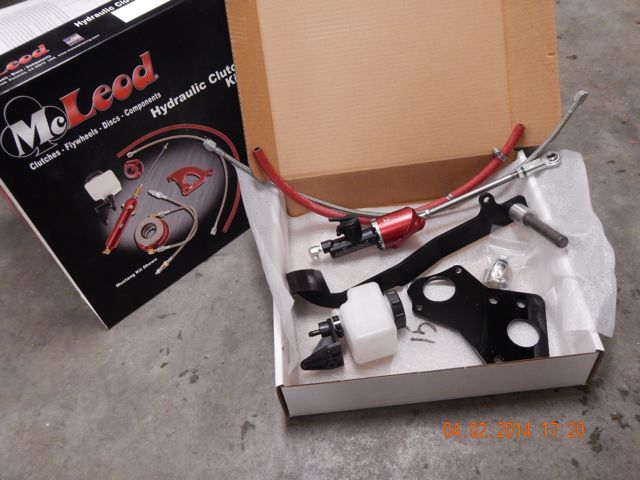

Default mcleod clutch kit
these look like good quality parts.
i'm not sure at this point that it will fit my application, but when i asked about the return policy i was told "if it doesn't fit just send it back."

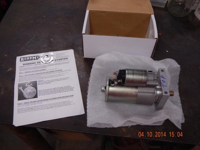

Default robbmc mini starter
this looks like a very high quality unit with the added bonus that the solenoid is adjustable through 360 degrees on the housing, so i can put it wherever i want.
these guys also get big props for supplying a very good set of installation instructions.

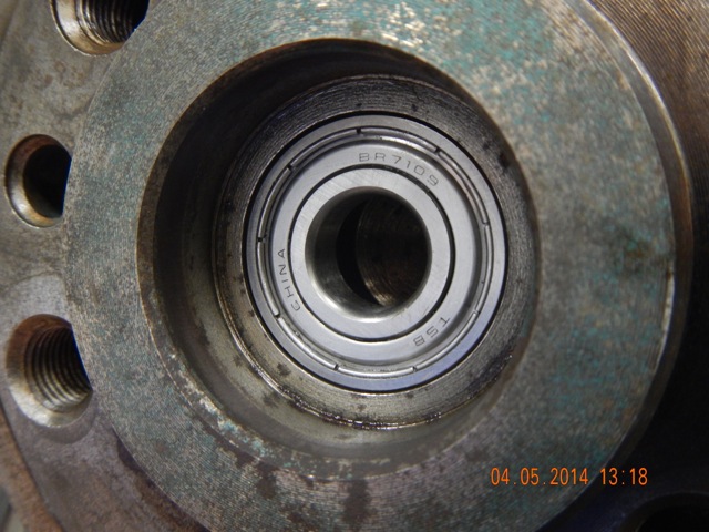

went back through the driveline and got it all put together for good, starting with the pilot bearing...

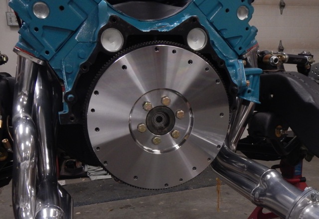

this is mcleod's neutrally balanced steel flywheel.
the ring gear has 168 teeth.
it weighs about 30 pounds.
i ordered the mounting bolts to go along with it but they're 7/16" and my crank is machined for 1/2" fine threads.
thankfully, the holes in the flywheel were large enough to accept the 1/2" grade 8 bolts i bought at the hardware store.
i used a star washer under each bolt, applied a good amount of blue thread locker, and torqued them down to 85 ft/lbs using the conventional criss-cross pattern for a six-bolt flywheel.
after bolting it up i cleaned the friction surface thoroughly with dupont low temperature surface cleaner.

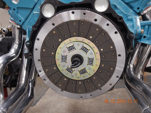

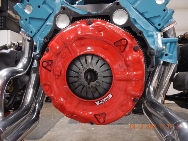

this is mcleod's 'street pro' clutch and pressure plate kit.
my bellhousing measures 6.25" so this setup should work fine with the bolt on hydraulic throw out bearing.

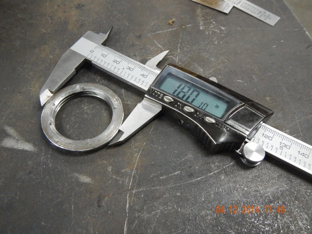

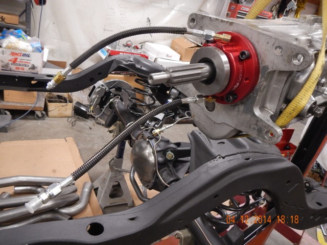

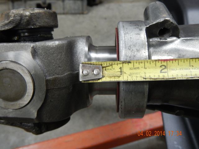

in order to use this hydraulic throw out bearing with the muncie, the diameter of the slider nut on the input shaft needed to be reduced from 2.00" to 1.80"
it was pretty easy to do that with my table mounted grinding wheel.
Size:  115.0 KB Name:  slidernut.jpg

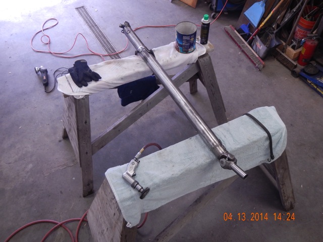

got the driveshaft cleaned up with the pneumatic wire brush.
i really like the way this polished steel looks with a little clear coat on top of it.

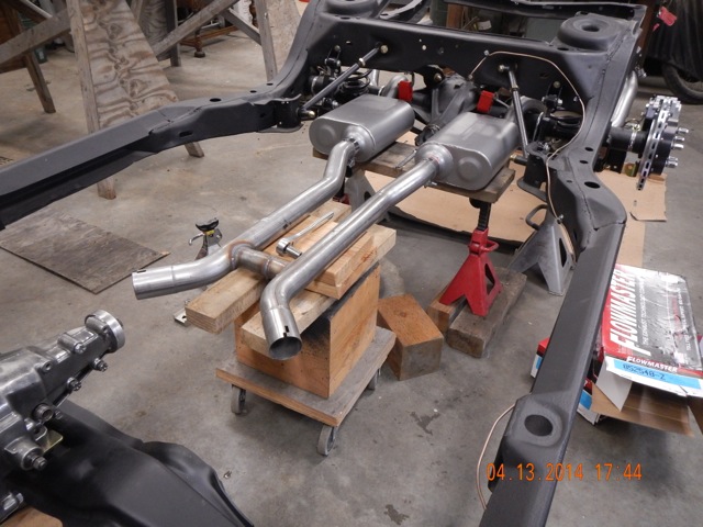

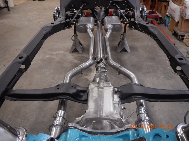

this flowmaster exhaust kit has been very easy to work with.
the mandrel bent stainless tubing appears to be very good quality and it all looks like it's going to fit my application pretty well.
Size:  108.8 KB Name:  exhaust2.jpg

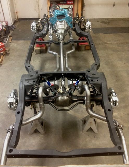

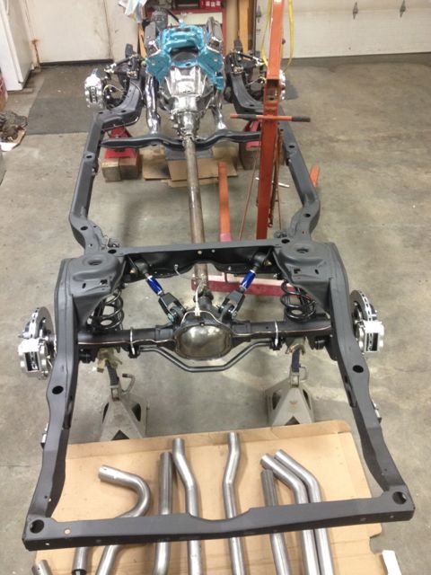

it's really exciting to see this all coming together!
