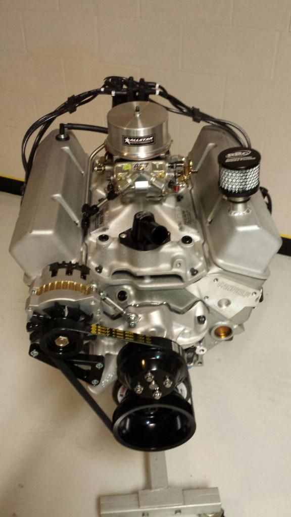

Thanks. I am still building the motor, but I plan to video it on the dyno in the coming months. Here are the specs on the new motor.
GM Performance Bow-Tie Sportsman Block (4.125 bore)
Callies crankshaft (3.48 stroke)
Oliver 4340 rods
JE pistons (13.5:1 compression)
Cam Motion solid roller (268/[email protected])
Canfield 218cc heads full CNC-ported with additional hand blending by Nelson Competition Engines
Crower severe-duty lifters with HIPPO
Jesel Sportsman shaft rockers
Wilson Manifolds Victor Jr. intake
ATI balancer
Cloyes double-roller timing chain and quick button cover
Melling oil pump with Moroso pan and pickup
I'm still deciding on a carb for it.

The motor is coming together now. The long block is complete. I'm currently setting up the shaft rockers and waiting for pushrods. Still need to decide on a carb.

Love the new wheels. Nice engine build. For carb, Im thinking Holley HP Ultra 850 minimum. Maybe new dominator?

I had some delays with parts, but the motor is finally finished and heading to the dyno next Tuesday.
