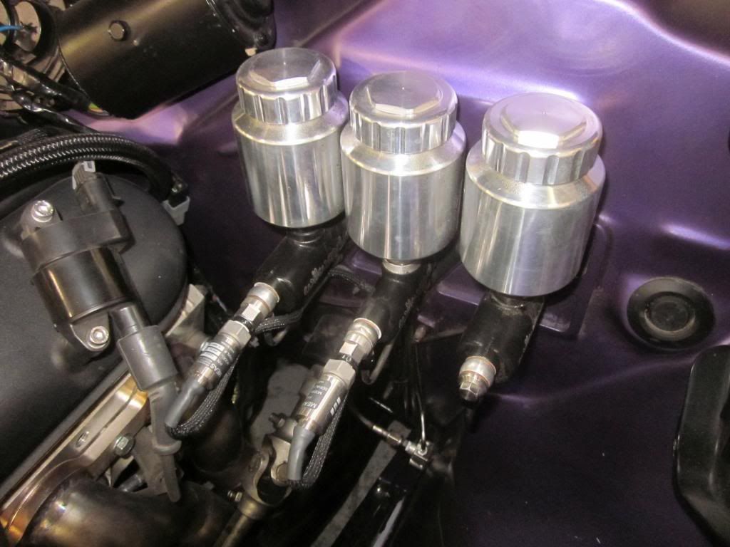

We have no brake issues with the Challenger! The brakes work good but want to make it easier to drive on the road course.. The Booster is not a band aid but an enhancement to improve on driving smoother & deeper into a turn to scrub off some speed.. Glad to see that your brake system works good for you on your Mustang..
Working for a brake company for 10 years.. I thought I knew a lot.. but when I started driving myself is where I finally realized that I had still much to learn.. Danny has taught me what it takes for brakes to survive a road course.. brake ducting, brake fluid, & most important brake pads.. Heat is your enemy on brake systems & deflection of components.. I continue to learn something new every day.. Karl is a pretty damm good driver & if I can improve his lap times with power brakes.. Then that is what he gets!
Everybody has different experiences or opinions with brakes & just like any other product that does not meet my needs or requirements.. I just take matters into my own hands! Sometimes manufactures make components so that they can be used in many different applications & the level of performance is not the same from one application to another.. I like components specifically to what my intended use is for ..
BTW- We have a full Aim Sports Data Acquisition that gives us brake bias readings..
