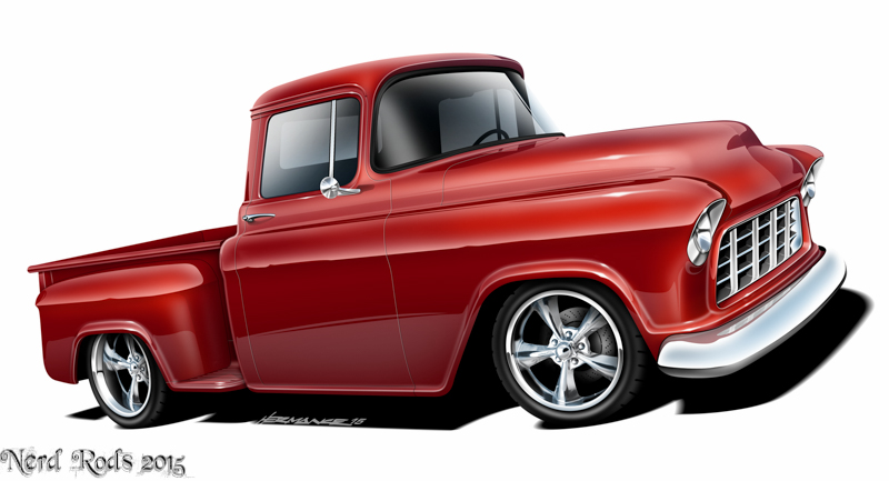

Logistics, logistics, logistics. Mainly on wheels for George. We finally had Ben @ Hermance Designs do a rending for him to try our several wheels after looking at some very expensive options he landed on the Showwheels and here we are.

rendering looks good, Beautiful job on the frame Russell.
