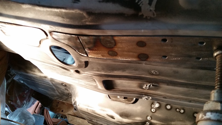

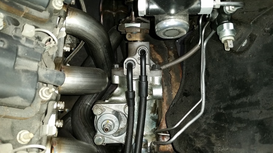

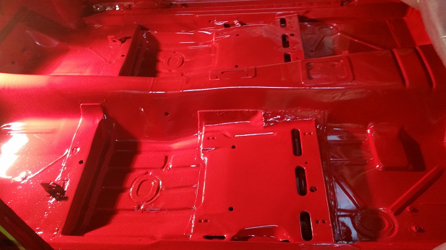

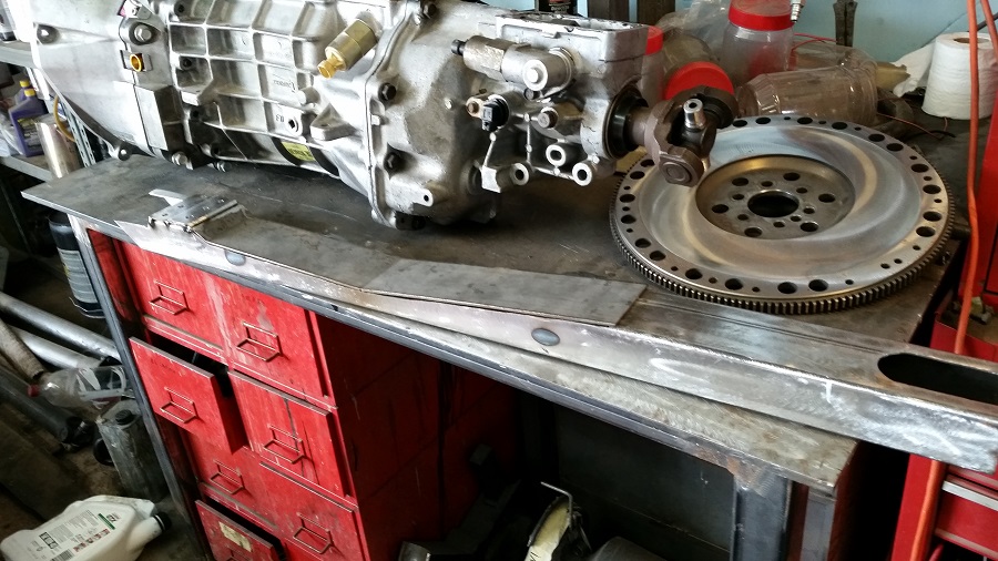

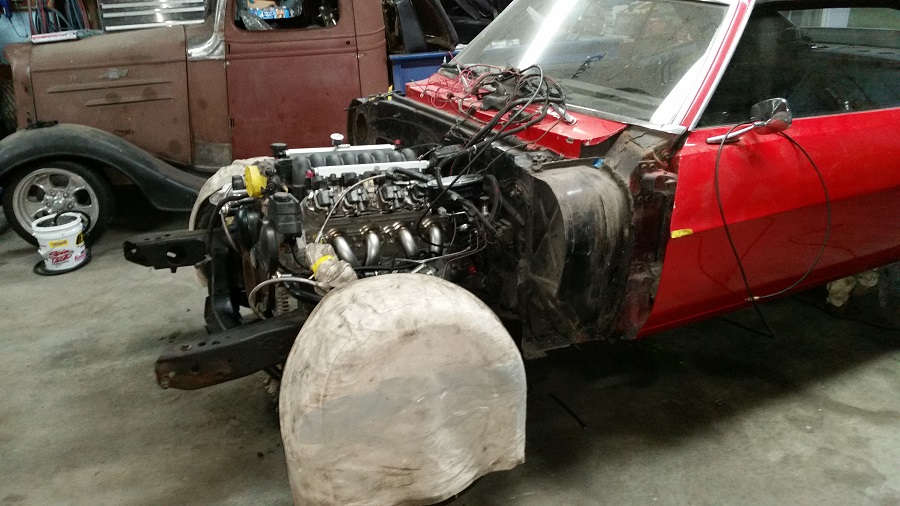

At this time I can report that I've finished up my TA suspension (although I've decided I do need to put it on a diet), installed a new floor pan, a new fuel system end to end for the LS, installed the LS and T56 with the Holley system (mounts, long tube headers, cross member that I altered to accommodate the front mount of the TA, and HP EFI).
I'm now in the process of setting up the DSE dash insert with custom Speed Hut gauges, adding the Vintage air Gen IV, finally installing the Ridetech AirRide compressor system (placing a 3 gal tank in the pockets at rear of quarters on both sides, been using simple valves to add air up to this point). I'll add pictures of this process when I can collect them from my shop camera.
Made my first trip to mom's on Christmas and can say I really like the LS platform! Its been a joy to drive as long as I stay away from parking lots. I've lost a lot of turning radius with the Ridetech Tru Turn system. Slowly trying to sort through that issue. At this time, I imagine my only option is to move the Muscle Bar rearward on the frame to allow more turn radius and maybe notch the frame as needed at the rear. As others have noticed, my front wheels are well behind the center line of the wheel opening, which is causing the rear of the front tires to rub on the inner fender well during turning. I fear that Ridetech may have sent me the wrong control arms.

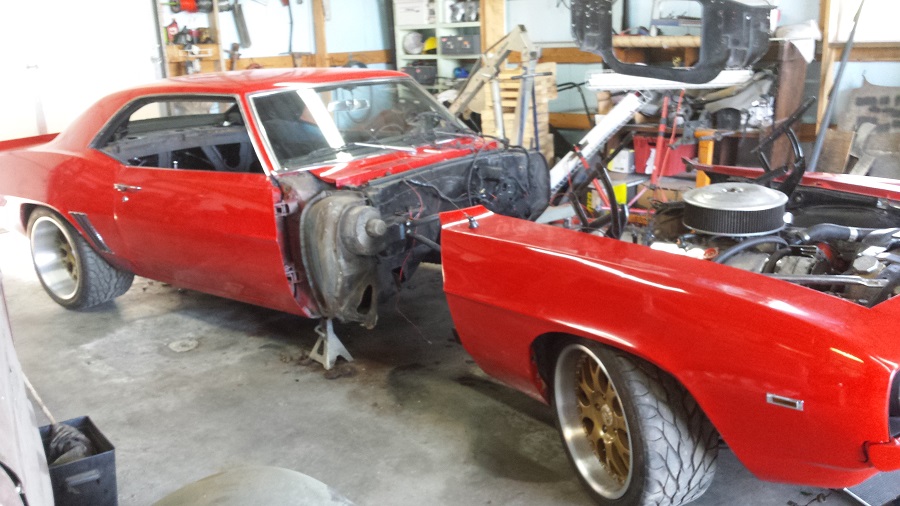

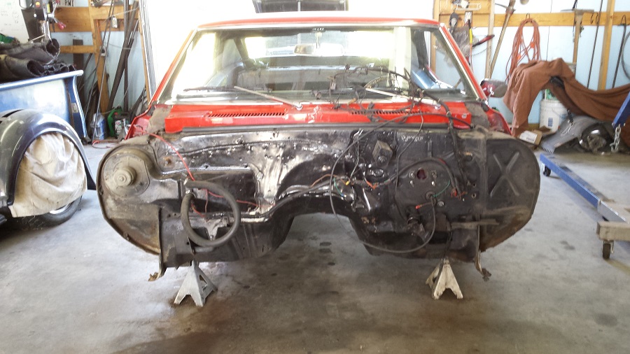

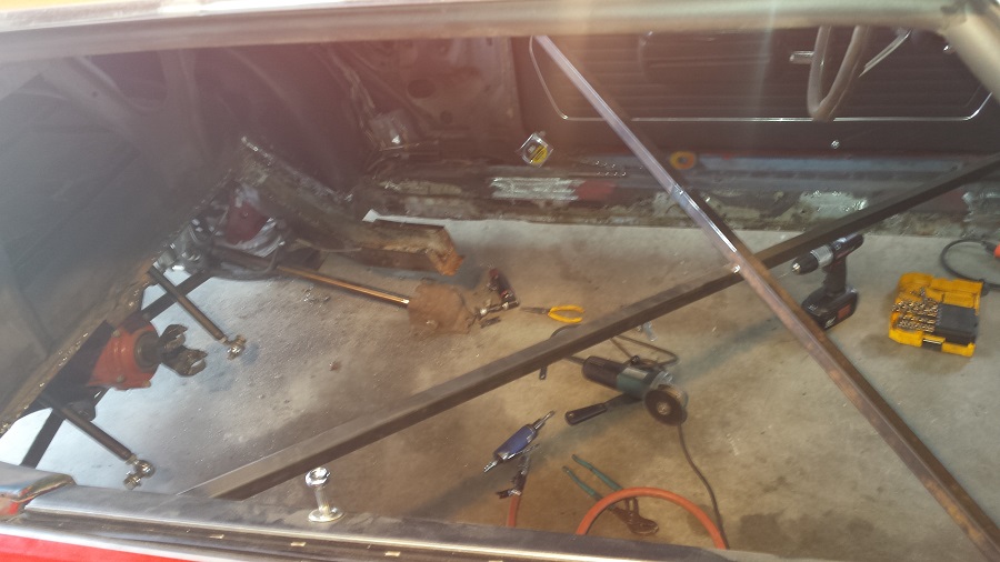

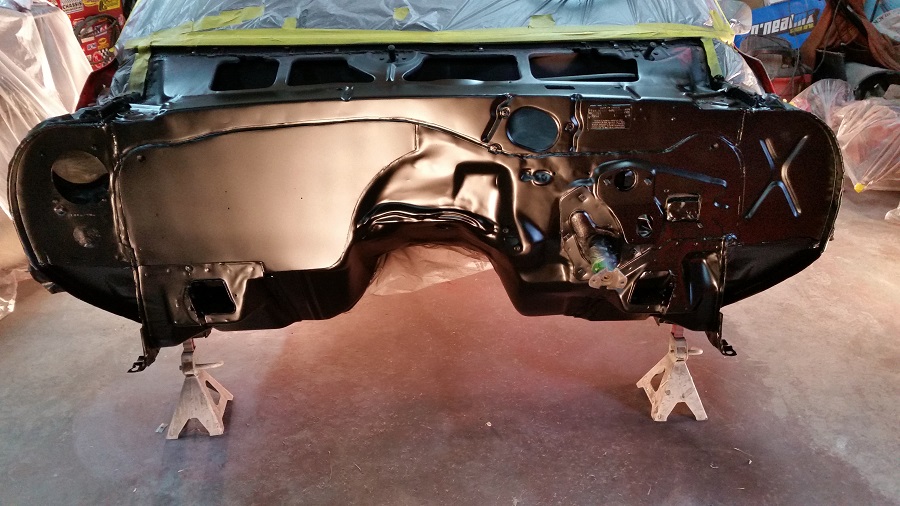

A few more updates
468 BBC, TH400, Moser 9" floater, True Forged Competitions 18x9.5 18x12, Kore 3 C6 ZO6 calipers 14" & 13" rotors, Ride Tech True Turn, Ride Tech Air TQ's, Torque Arm with Watts link, Moser CT Full Floater 9" with locker.
