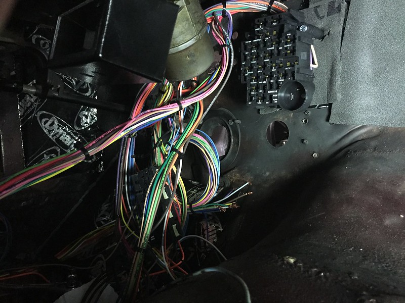

Started on the wiring using American Autowire classic update kit.
IMG_0905
IMG_0903
IMG_0904
Also got the booster/bracket from Steve's mustang and Lokar throttle pedal assembly installed to make sure nothing interfere with the wiring.

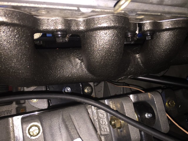

Had the engine in and try to work out the exhaust manifold set up. Tried the stock truck manifolds, and that did not work. The manifolds stuck out too far, and hitting the steering shaft. Finally rolled the dice on a set of Holley cast iron manifolds, and it fit.
Driver side, clears the steering shaft by at least 0.5".
IMG_1377
IMG_1378
Also I lowered the engine/trans as much as I can in order to minimize the tunnel work. Had to enlarge the steering shaft cut out on the driver side engine mounting bracket.
