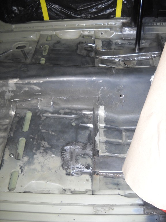

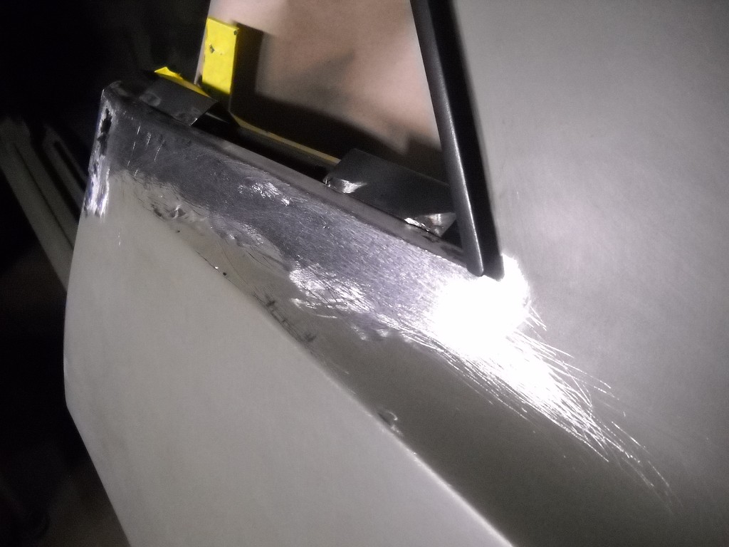

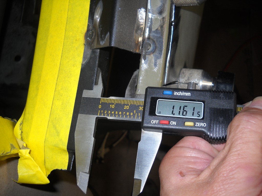

A little progress to show .... school is in session so I have allocated time to work on the Camaro. Welded the plates in the seat support back, and started fitting the outer AMD skin to the OEM window channel on the diver's side rear window. Left them screwed together and cut thru both pieces of metal at the same time ... came out ok!
I had previously welded on angle across the window opening for a reference ... the passenger side is a little wider and I have to put tension on the drivers side to get that gap ... so I'm just gonna put her back to where GM had it!
Take a look ...
Gonna spray some Eastwood internal frame coating on the underside!
Held in place ... gotta close the gaps a little!

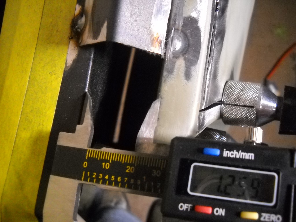

That's the pass side gap at the same spot against the driver's side gap... wider fer sure!
Think I'll leave her the way GM had it .... crappy tolerances!

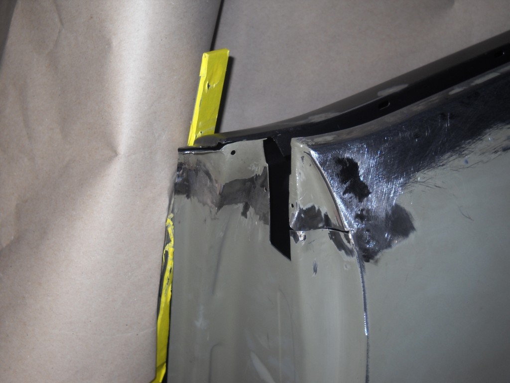

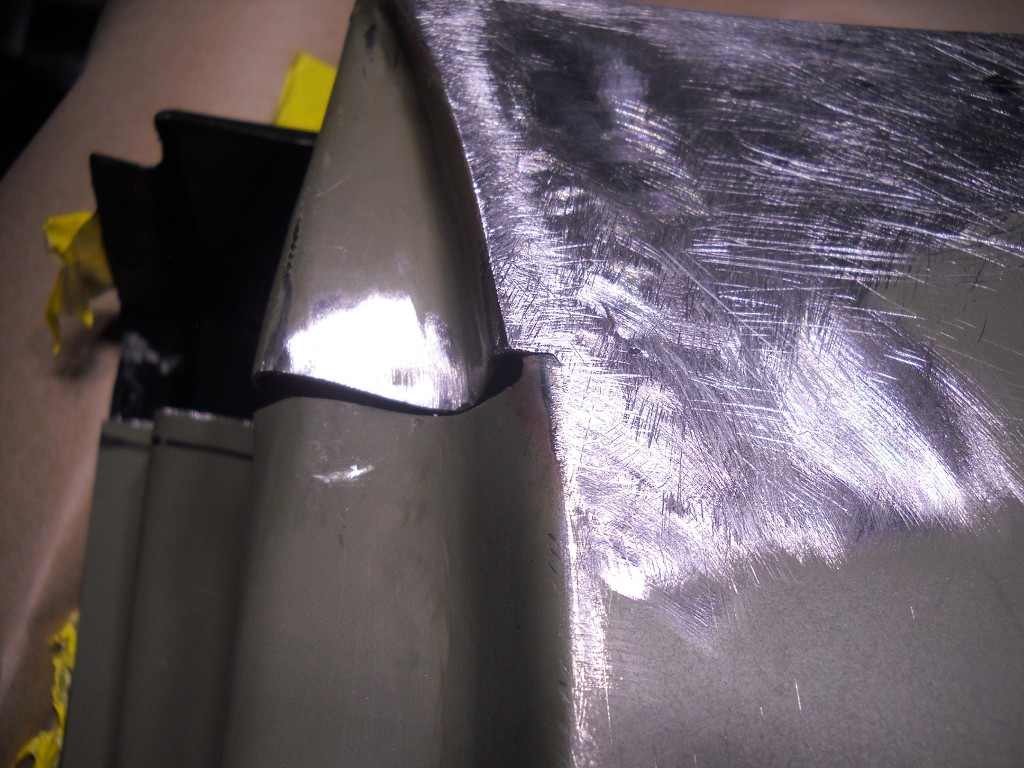

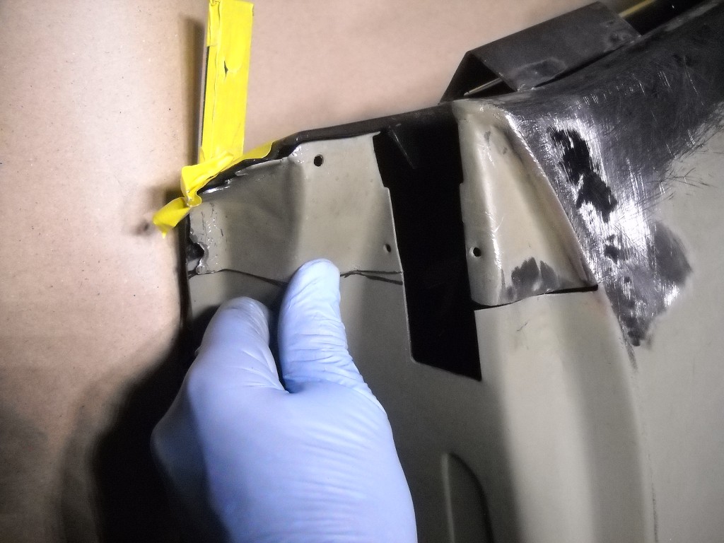

Anyway, got the GM window channel welded to the crappy AMD quarter , sanded and hand filed ... minimal skim coat of filler will be fine.
Now I have to weld in the GM corner piece here ... AMD stamping is crap!
MO BETTER!!! It even lines up with the original braces I welded to the inner ... yeah!

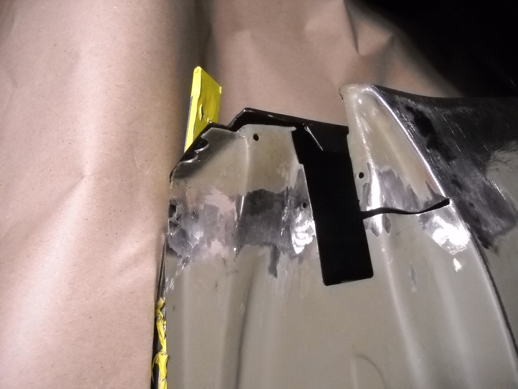

This is the next piece that needs welded in ...
I'll have to slice the quarter vertically and fix this mess ... that'll help w the door gaps too!
AMD ... this is what is supposed to look like!
Still plugging away between homework assignments ... hopefully I'll get that other inner corner welded in tomorrow and work on the vertical stuff later. She's getting there, just needed to TLC which AMD didn't bother to apply.

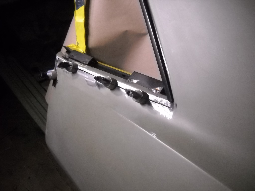

Greg, you are so right .... well did some more kicking, it's getting close now!
Looks so much better w GM corners!
Now to clean up the jamb area and work on the door gaps ... ugggg!
