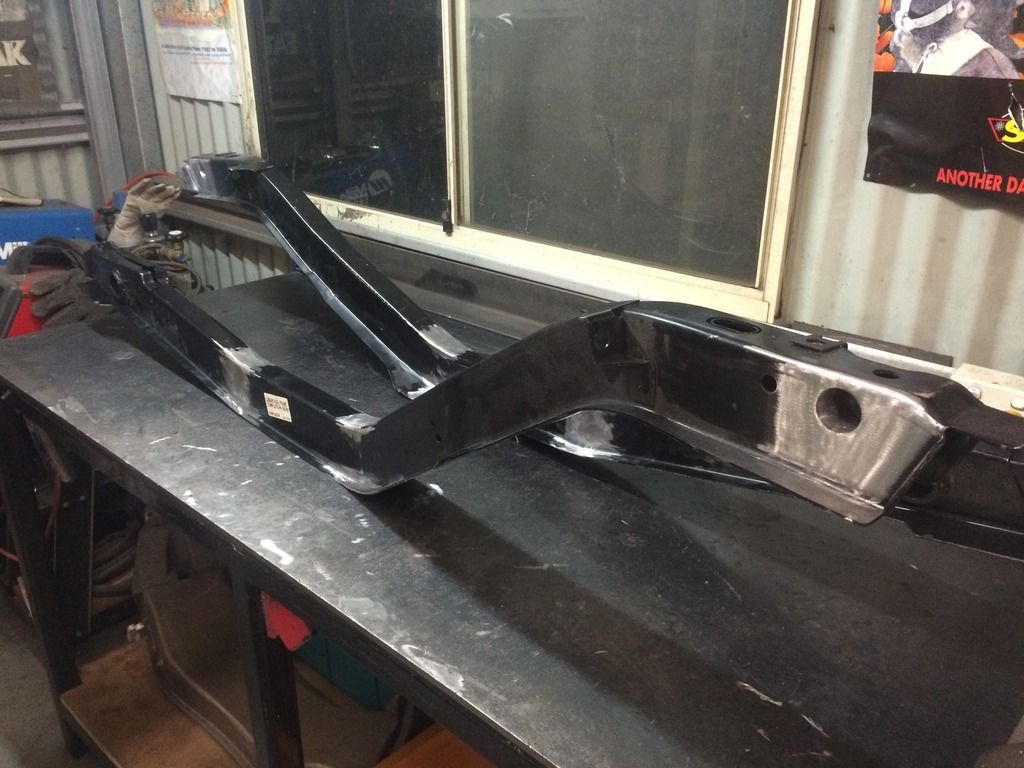

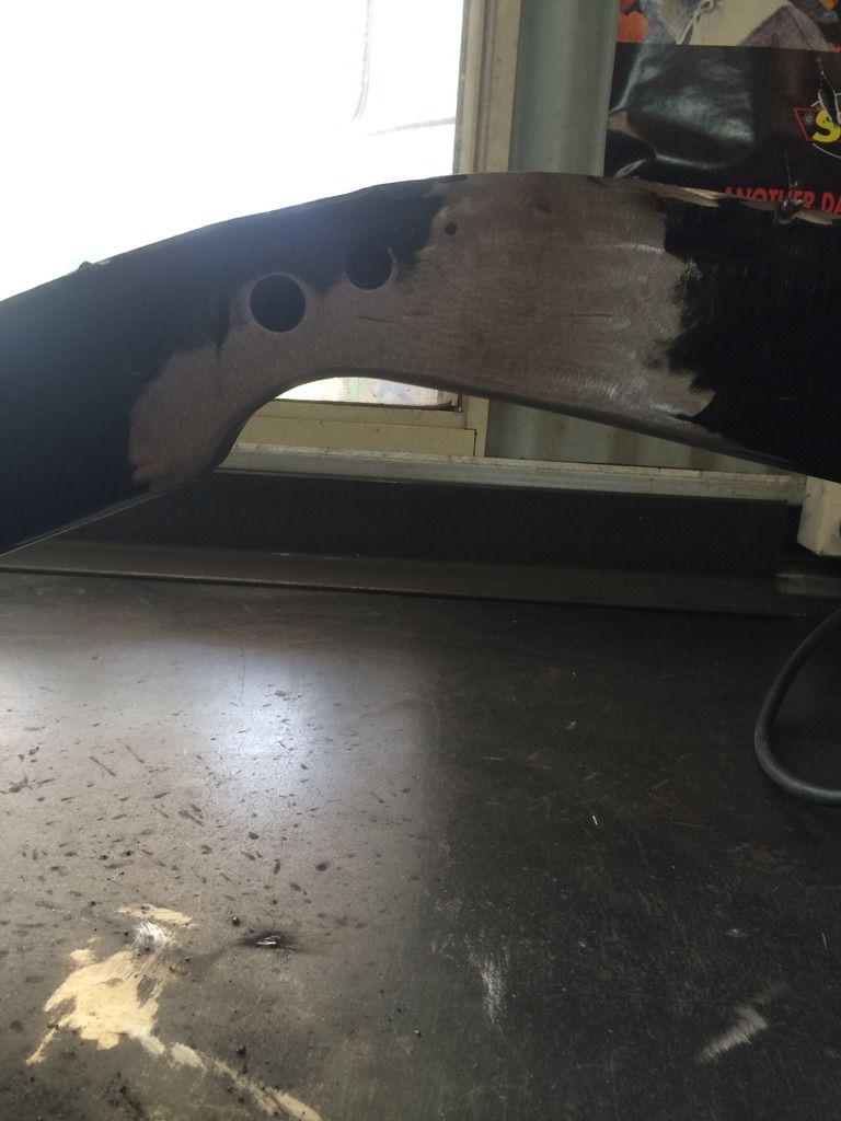

Speaksy got a bit more done this week. Rear outer tubs finished up with 5mm rod welded on outside lip.

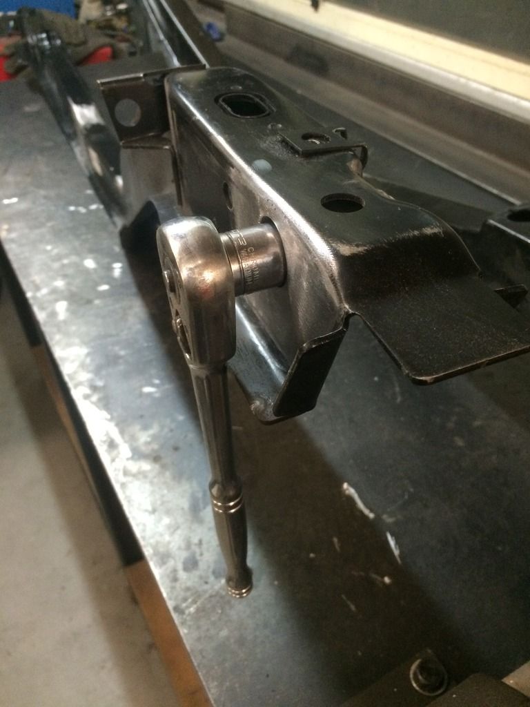

Pie cuts in rails all welded up and put a small notch in rails too. Welded in a sleeve where the bolt location is on the front hanger for link arms. This will allow us to be able to remove the arms without the need to remove leaf spring pocket too. Will weld pocket to the floor once in final position.
