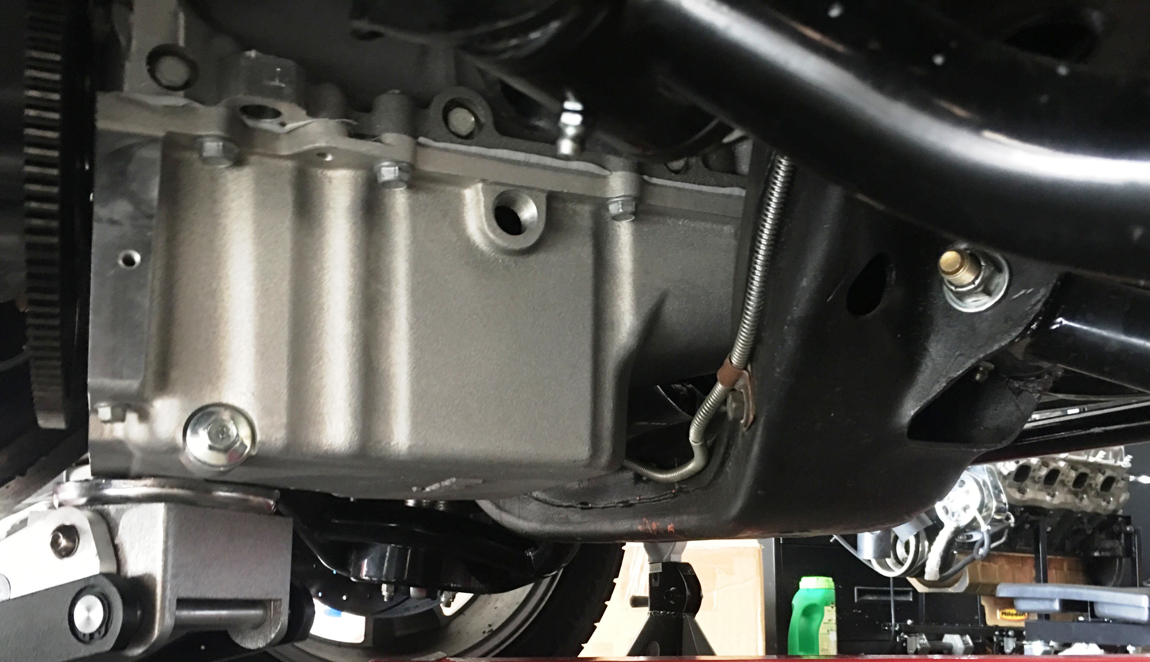

FYI, the Holley pan in the '70 Chevelle. Plenty of room.
