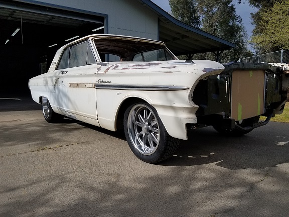

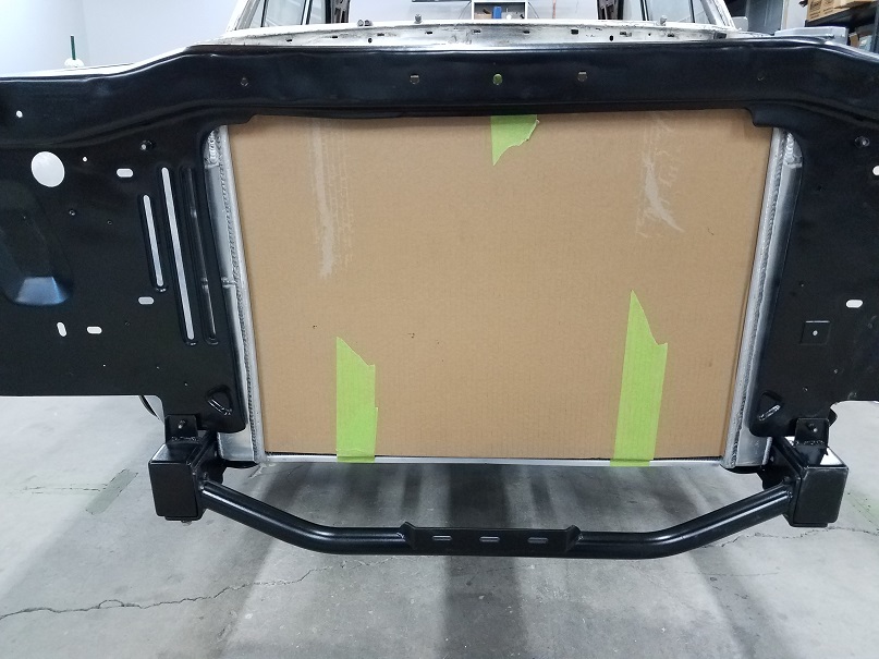

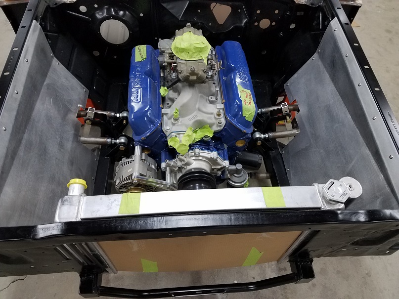

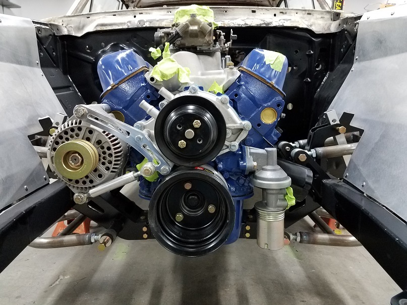

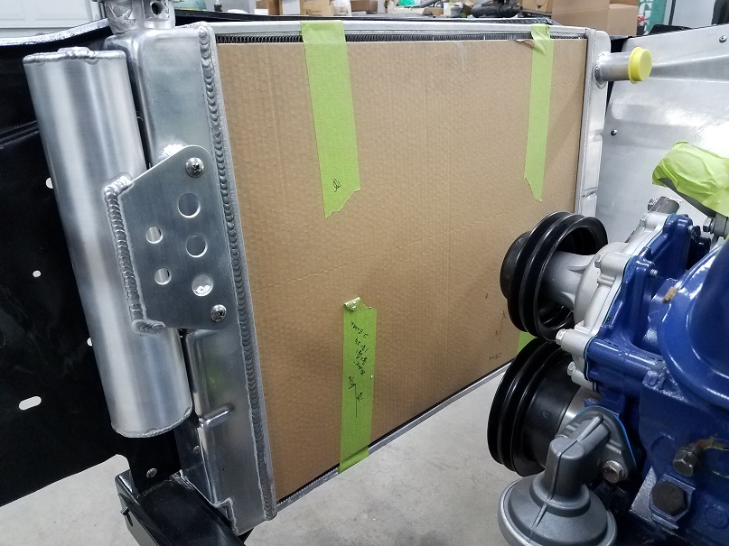

Engine and transmission are installed. All new engine components and new 30" wide aluminum radiator...dont think it will be getting hot.
Anyone with any idea as to what it is worth as a project?

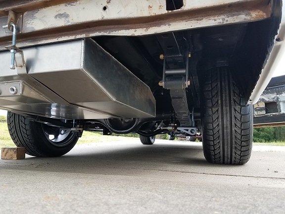

Rolled it out of the shop yesterday for the first time. I am just about out of time and will sell it as it sits. May loosely bolt some trim on it but for the most part, this is the way it will leave. Needs final body work, paint, interior, wiring and plumbing.

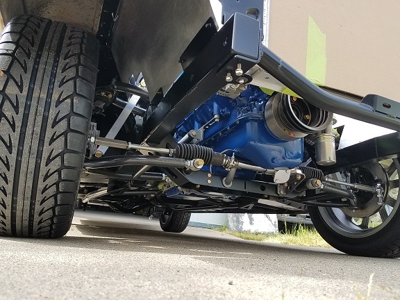

I also was able to get the inner fender panels made up. I made the steel parts to graft into the stock sheetmetal, punched the obround holes in the factory locations, and even put the VIN number in the original OE locations. From there, I made aluminum panels that span from the upper pieces down to the frame rails. Definitely cleans stuff up nicely. I dont think I will paint them as of now...

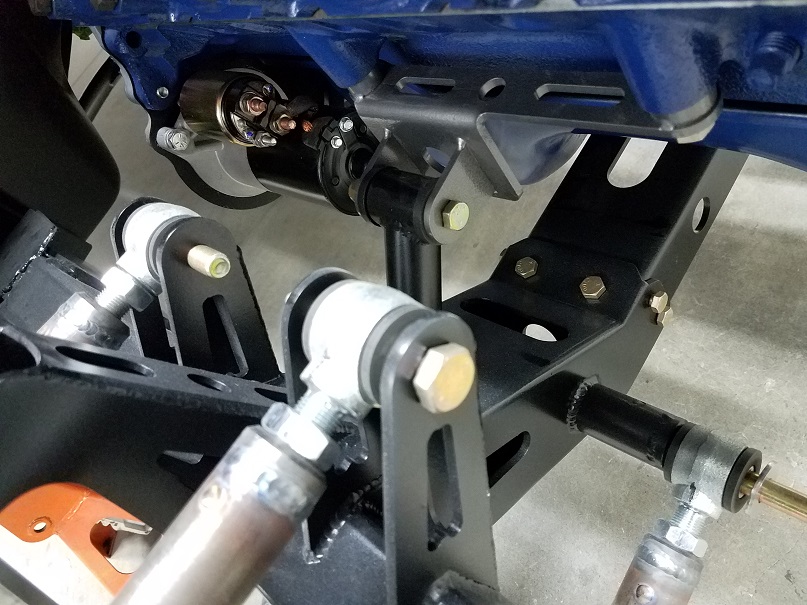

I also added a gusset to the front of the front leaf spring mounts, tying the 2 individual brackets together as one. It looks more complete and helps to keep everything together.
