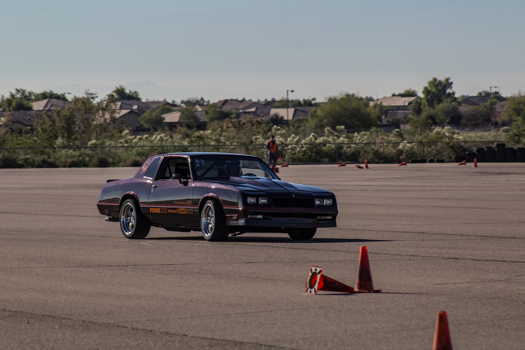

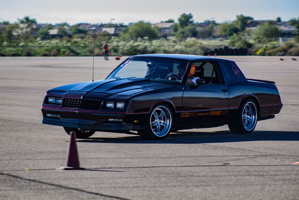

Did a little bit of photo editing this morning. Gotta thank Chris Niemeyer for grabbing these great action shots.
Look at that contact patch!!
Job well done Lance. That looks WAY better than before the new sway bar install!

Great pics, Lance. You really were flying around that corner all day. I did notice a lot of rear brake lockup though, especially in the lefthander preceding this sweeper.

Thanks Ric. I noticed that I could hear the rear tires sliding when I watched the videos back but never felt them cause a loose condition on corner entry. I've got the bias down to about a half turn between locking the fronts first or locking the rears first and locking the fronts first does cause a push. Depending on what the next course looks like I may put a quarter turn more on the fronts for a run just to see how it does.

Sure appears to run a lot flatter
