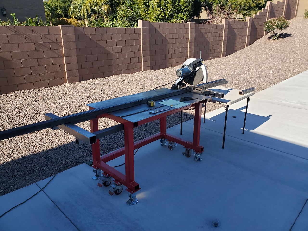

Started a new project today that required cutting up some 2" square tube. Perfect chance to see if I could get a chop saw to sit flush with table top. It did...
Bench worked like a champ. Now if I just wouldn't have run out of gas, I might have finished the project the same day I started it.
Happy New Year everyone!!
