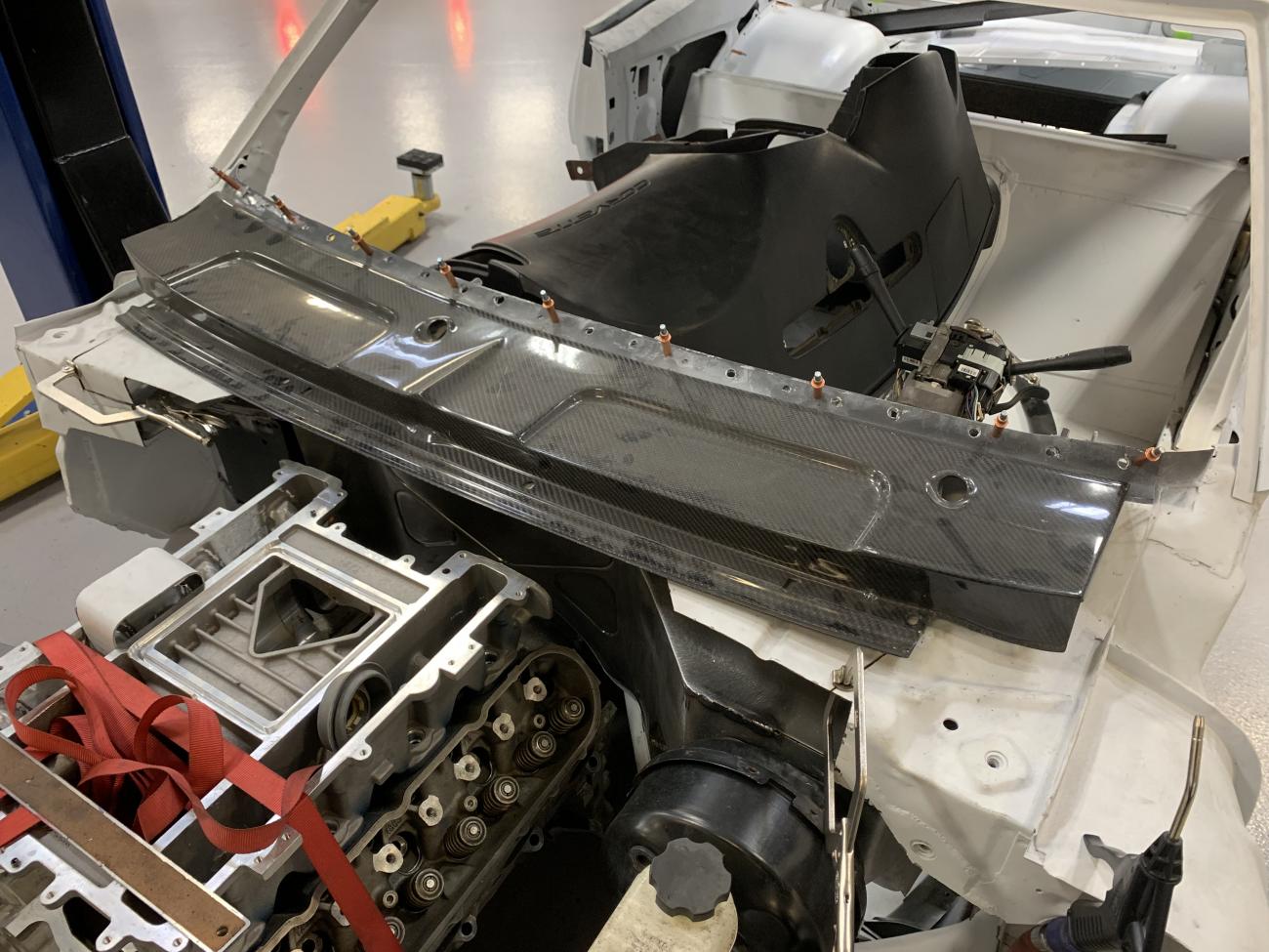

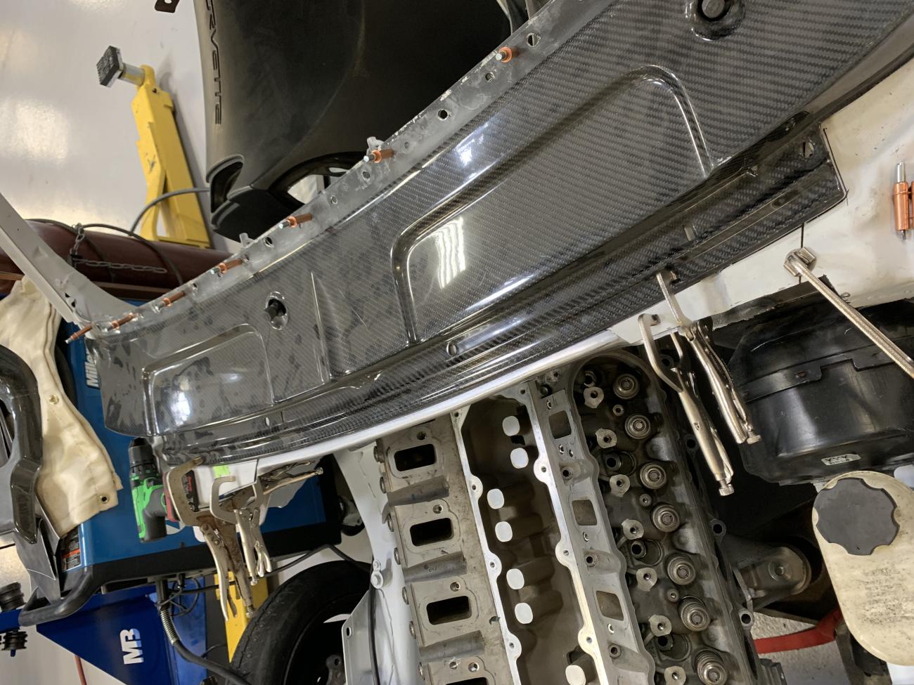

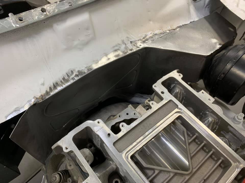

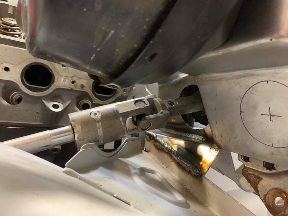

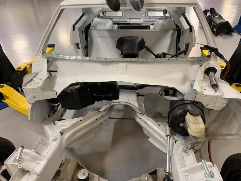

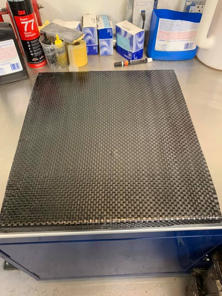

This week I got the driver floor bonded together and wrapped with 12k carbon fiber. I ran out of both epoxy and carbon so I wasn't able to get the rest of the floor panels done so I'll have to put that off until I get more.

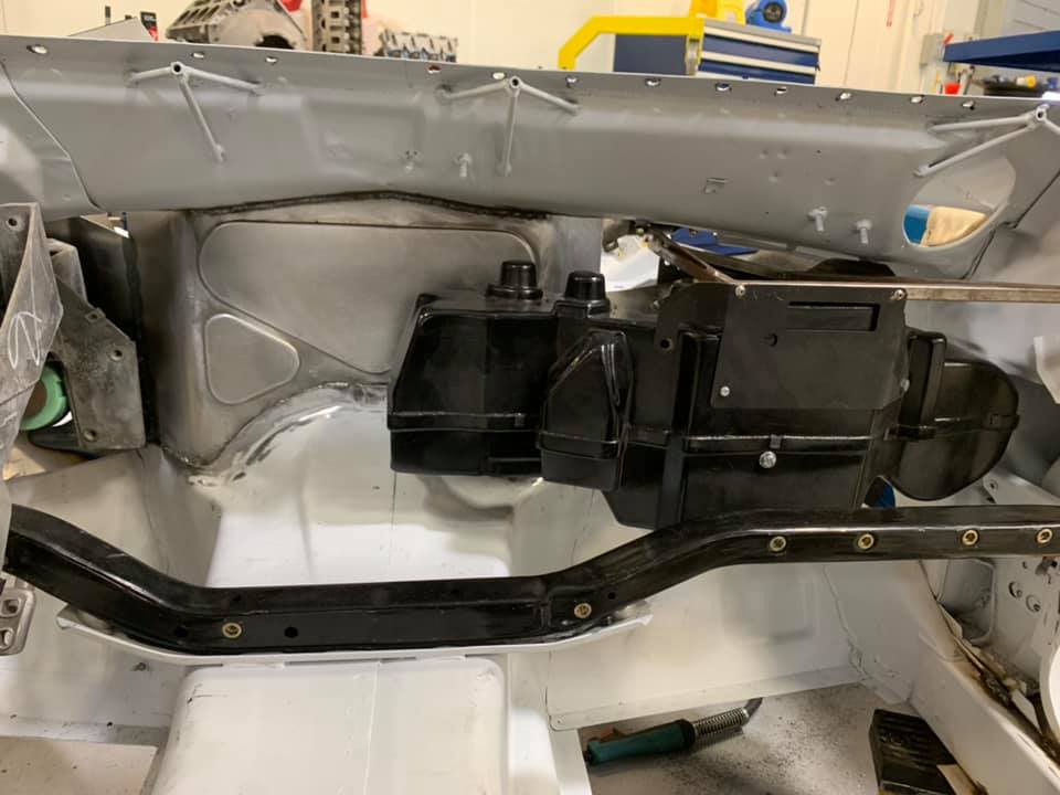

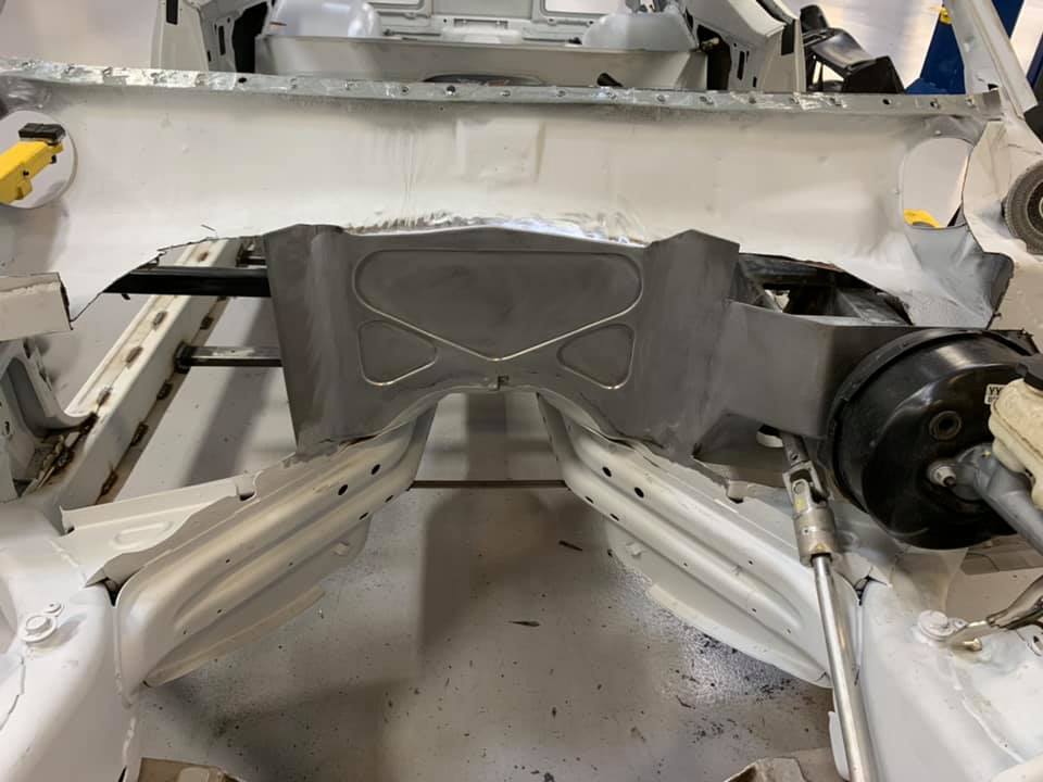

Today though I got quite a bit done on the firewall. I finished cutting off the upper cowl to access the bottom and got the main middle section shaped, bead rolled and welded in. I'm undecided how I want to finish the passenger side of the firewall so I focused on the driver side and got most of that done. I feel that I'm more than likely going to have to cut off the fender mounts and make my own to get everything to look right and not just patched together. I also need to mount my wiper motor since I'll be able to retain stock style wiper transmission and not have to go after market making the firewall the way that I did. I think that I'm going to mount my ECM to the firewall behind the supercharger since there is a lot of room there and it will keep the engine bay clean with less wiring.
Anyways, heres some pictures since thats all thats really important lol.
Instagram- camaroaj

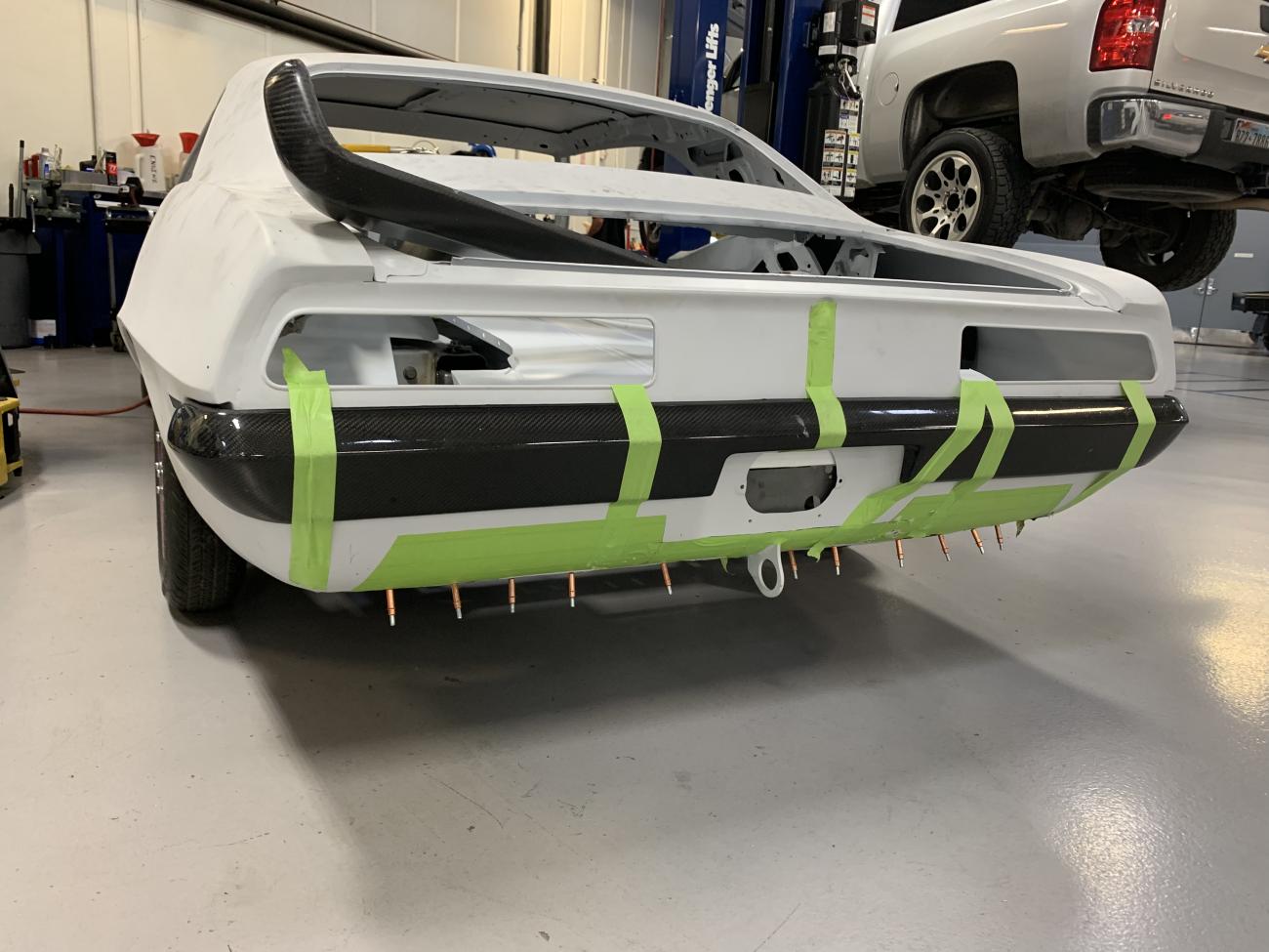

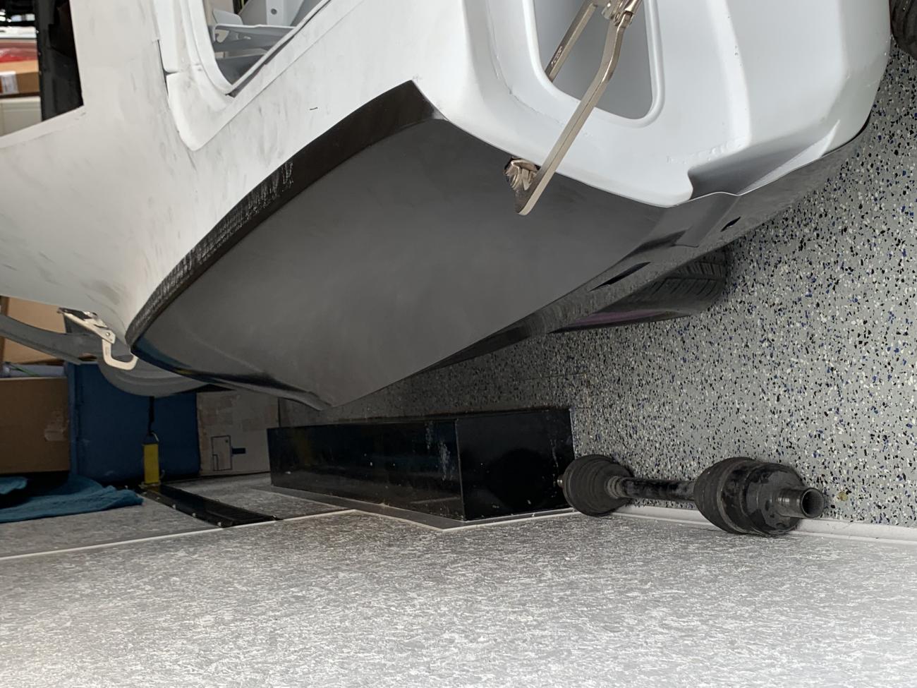

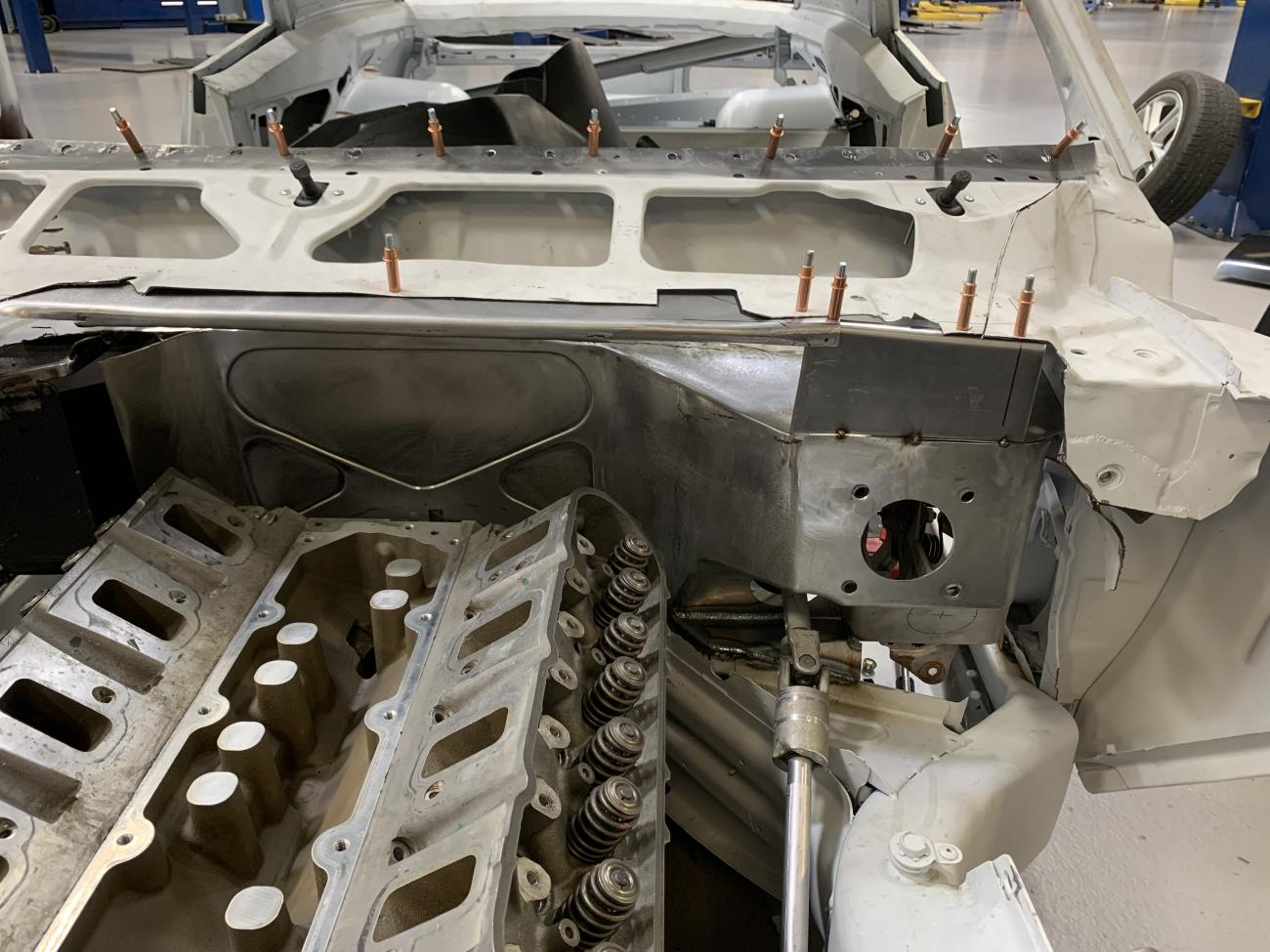

Doesn't feel like I got a lot done Saturday since I cut more off the car then I welded back on, but overall it was quite a bit of progress. I started out with getting the bumper brackets bonded to the bumper and all of that lined up.
While the bumper was curing I went back to work with the firewall. I hammer and dollyed the upper wiper cowl straight again and got it clamped back on and lined up and the wiper bases in so the cowl would line up right. With that set I was able to start the middle section of the firewall. I hammer and dollyed a round curved edge to match the curve of the cowl and got the bottom side welded and metal finished. The hard part will be filling all the small pieces now. I think I'm going to build a jig and cut off the stock fender mounts so they don't look scabbed together and all flows well.

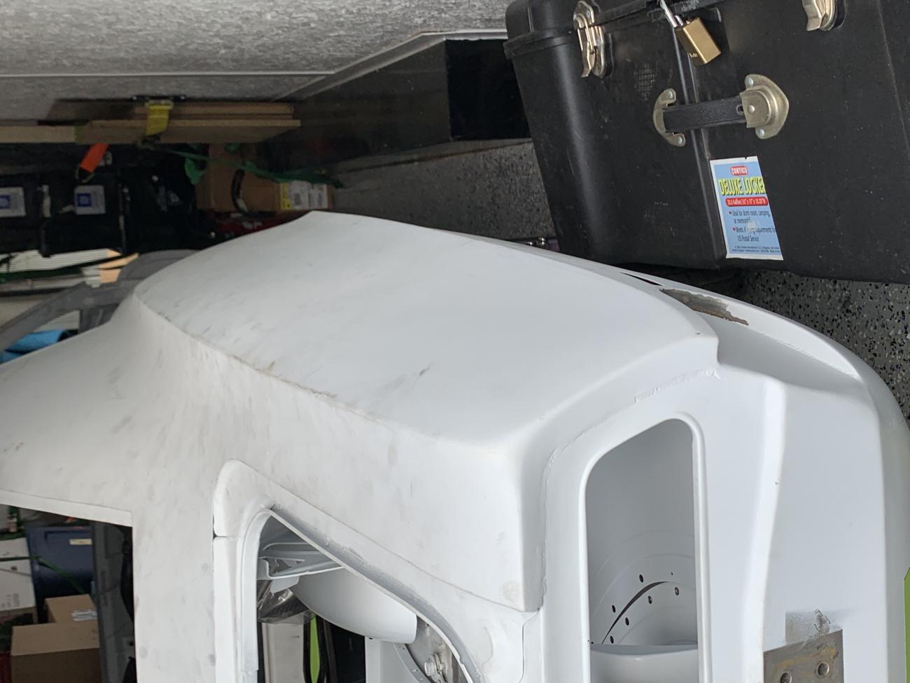

Since I've already made reference in this thread about it I started on the wide body fit up. I cut the front and rear flanges off and used my shrinker across the top and on both sides of the wheel arch. This was just a light shrink as I can always go more and I didn't have the car here when I did it. I took the quarter over to my trailer and laid it over. I'll get back on this once the firewall is done, but so far I've gained almost 2" with it just set on it. With it held tight and the calibrated eyeball it's right about 1 3/4" wider.
Instagram- camaroaj
