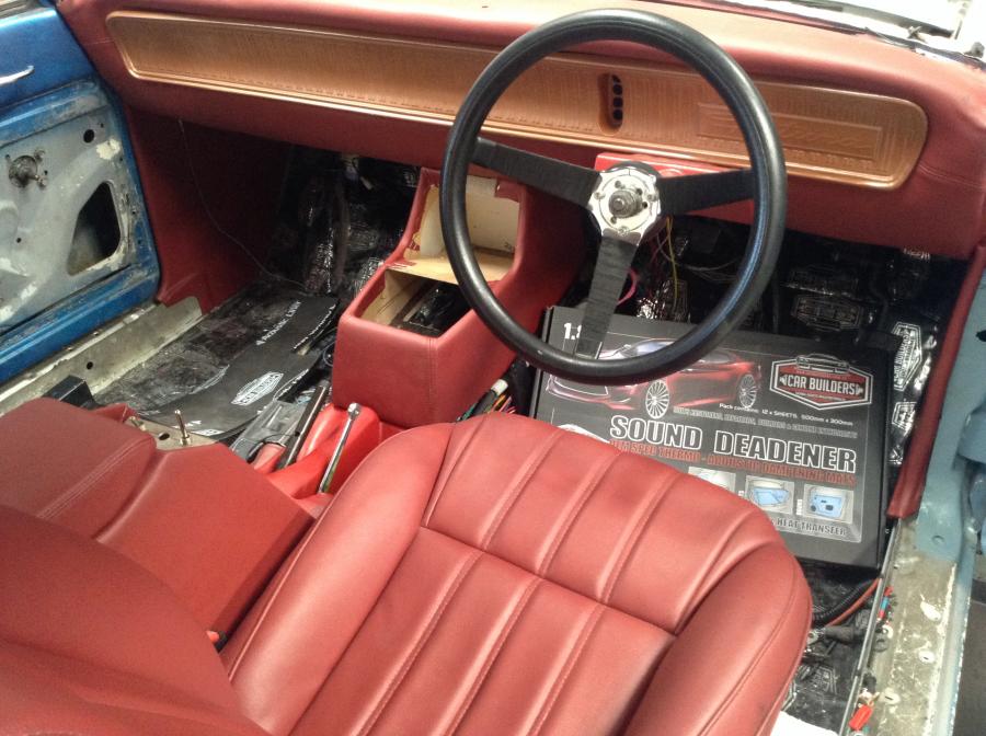

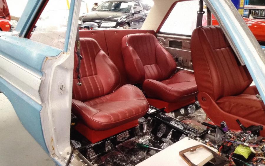

Default Interior.....
Interior is a mix of Scat sport seats in rear, full length console is custom cut plywood case with armrests/storage bins front and rear. Console is fully sealed as a subwoofer bin for Sony 12" sub. Mids are in sealed enclosures in front console. XJ6 Jaguar Jetsons-type shifter for period correct.
Vintage Air for heat/cool/demist.
Front seats are Commodore buckets with height/rake adjustments intact, cut and retrimmed to match the Scat stitch and pad design. Instrument panel is foam and vinyl padded. Originally it was, of course, body color steel. Instrument panel fascia is a fiberglass panel taken from a mold of the Futura garnish panel between tail lights. It is painted bronze (not wood grain as it appears in photos). Instrument fascia has no gauges nor speedo, just shift position lights in a recess ...... four colors for Park.Rev.N.Drive. An air/fuel ratio gauge and temp gauge are in overhead pod above interior mirror.
GPS speedo will be on package tray visible in the interior mirror (cos it's reversed HUD format)....it works ok, have one in dd Camaro.

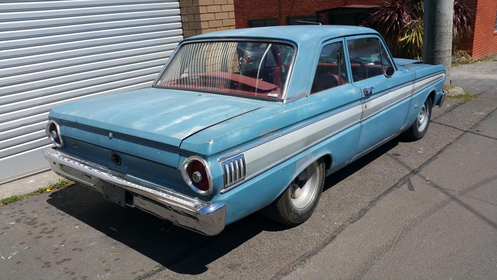

Paint is a strange mix of gray primer and blue tinter.
It's gonna stay ALMOST as-is with a famous racecar livery worked into it. Hand signwritten ..... cos racecar! More pics as that progresses.
Wheels and tires are undecided.....probably will end up with 15x7 and 15x8.5 Daisy = American Racing T200.
