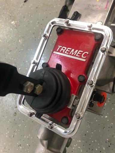

Aaron Oberle made me a new shift boot ring. It is big enough to pull the shifter if needed. Makes pulling and install the transmission easier. I like to fill the transmission from the shifter hole. Way easier.
