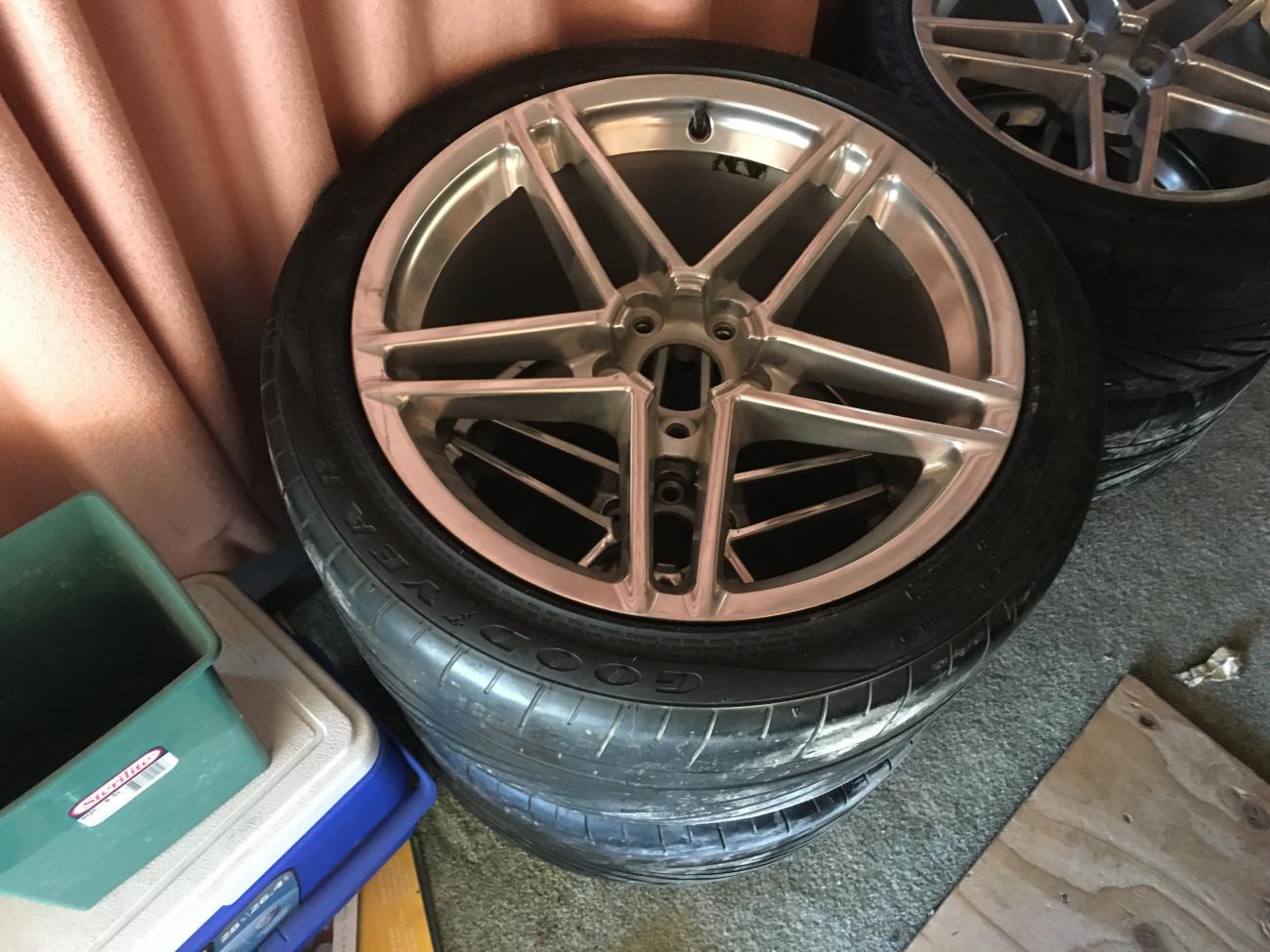

Tires and wheels together for the first time
Going to the tire place to get everything together wouldn’t make for much of a story. Don’t worry, I can spice it up a little.
I have retired from pipeline construction and industrial pipefitting after almost 40 years. Now for me not doing anything won’t happen so I have started teaching high school vocational education in Plumbing and pipe trades.
The job has many advantages, such as summers off and a lot of free time when the students are on their work experience. One afternoon when I had some free time I ran up to the tire shop and got the job completed. While driving home the radio reported that there was a traffic hold up due to an accident. I knew the area but it wouldn’t be an issue because I wouldn’t have to go there. Not more than 2 minutes later I got a phone call from one of my work contacts to tell me there was some bad news. One of my students had gotten into an accident with the company truck. OOH that’s bad! Oh and he had gone over the sidewalk. OOH that’s bad! Oh and he hit a pedestrian. OOH that’s bad! Oh and he lied to us and he doesn’t have a driver license. AH CRAP, THAT’S REALLY BAD!
That devoured several days of my time and landed the student back at the school for 2 weeks when he should have been at his work experience.
https://lateral-g.net/forums/attachm...1&d=1611517183
