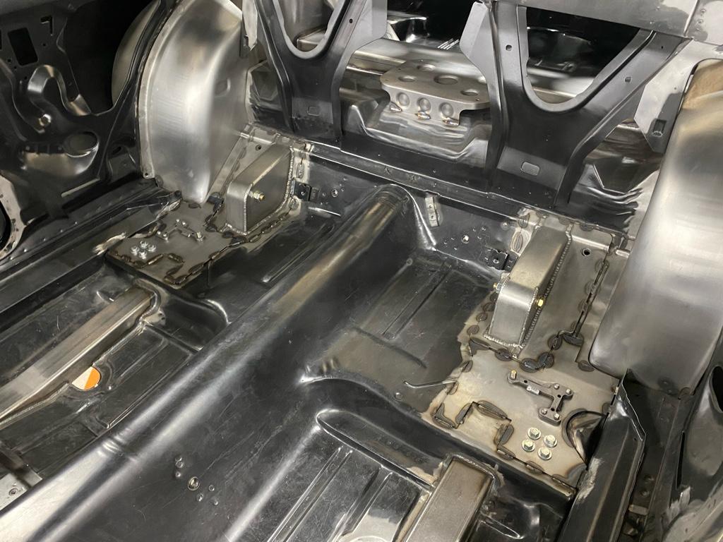

Originally Posted by Beechy View Post
Post #55
Am concerned about the weight of the trans levering on the single thickness floorpan.
Flex in the trans mount provides no rotational stability to those tabs/bolts.
Am aware of the doubler above the floor but the point load on the single skin is too much.
A nice fabrication but looks weird.
I HOPE I'M WRONG
This is the same style I built for mayhem, hellfire and gordons 67 camaro, the tabs pickup on the sheetmetal floor pan, the seat reinforcement and also the doubler plate to tie things in

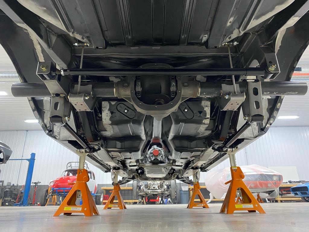

Originally Posted by Ketzer View Post
Interesting...not a 9 inch Ford.
Originally Posted by Che70velle View Post
You beat me to it…
Yes. Had a 9" but getting a quiet 9" seems to be impossible. Trying something different.
