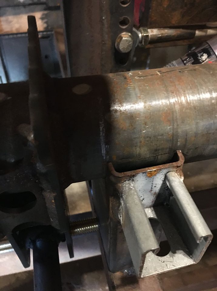

Even though I already MIG welded the car, I felt that for a better looking cage I would have my friend Brent Johnston over to TIG weld all the visible welds. We ended up grinding a lot out so they wouldn’t be all lumpy. Brent worked for a local chassis welder for several years and welded aerospace for 18 years. I hounded him to join the union and he now is one of our best stainless welders. He also is now the shortest welder in our hall, a title formerly held by my other friend Dwayne Rudkavitch.

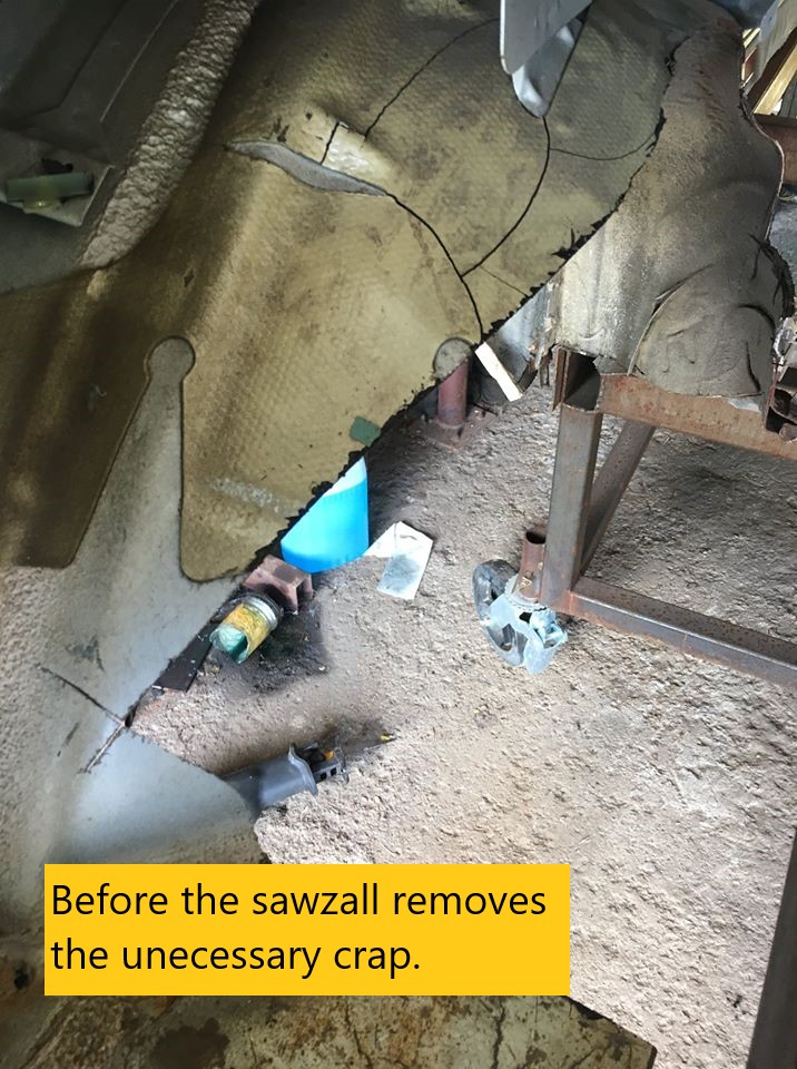

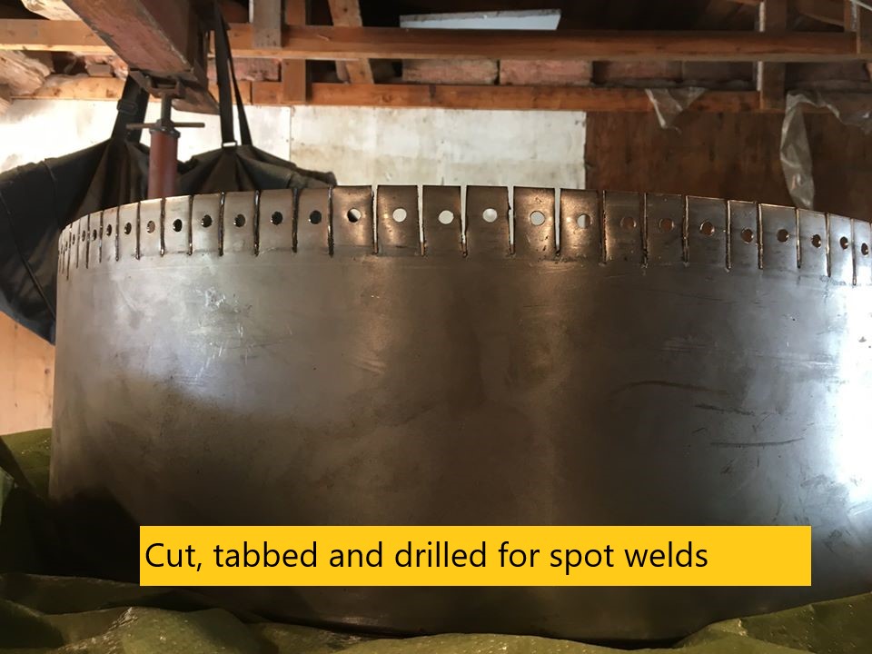

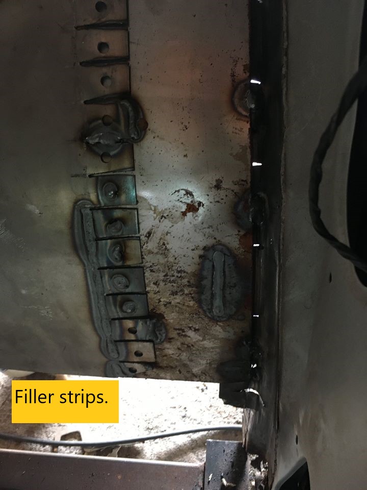

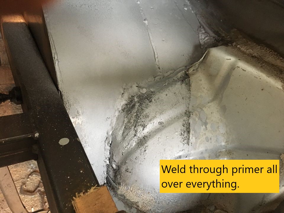

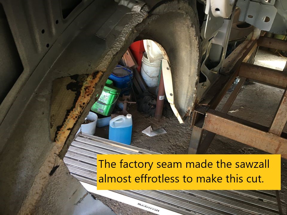

Just a start on doing the wheel tubs. I bought some weld through primer from the local auto body supply place. WHAT JUNK! That crap went everywhere. I looked like the tin man when I was using that ****. Don’t worry in a future episode I find a much better product. I have some pictures here but it’s not that detailed as I needed both hands many times when a good picture could have been taken.
https://lateral-g.net/forums/attachm...1&d=1647816965

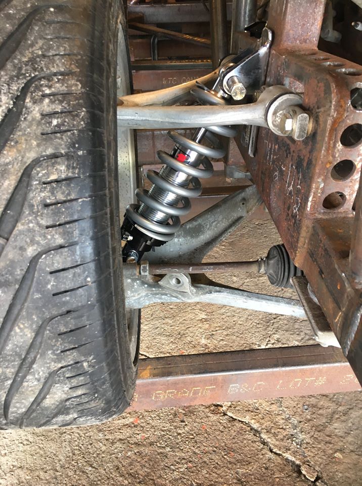

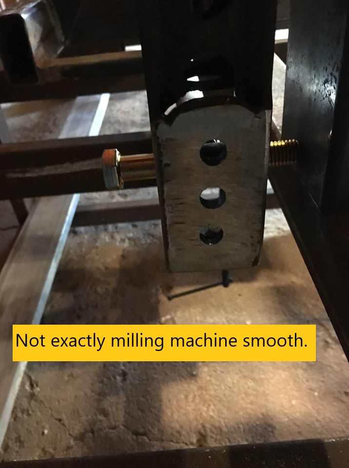

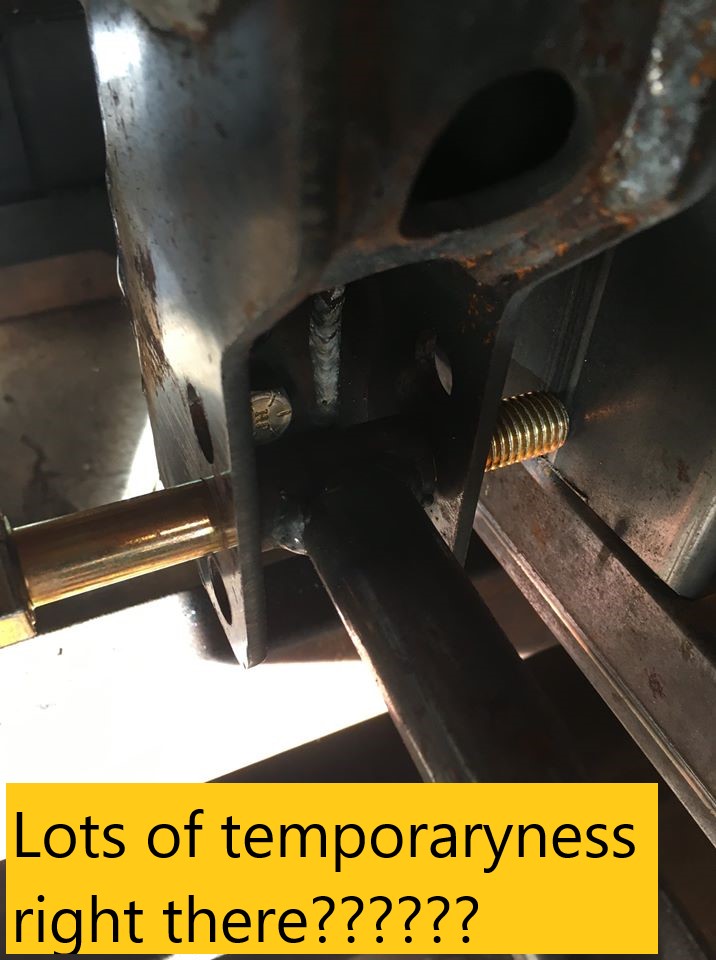

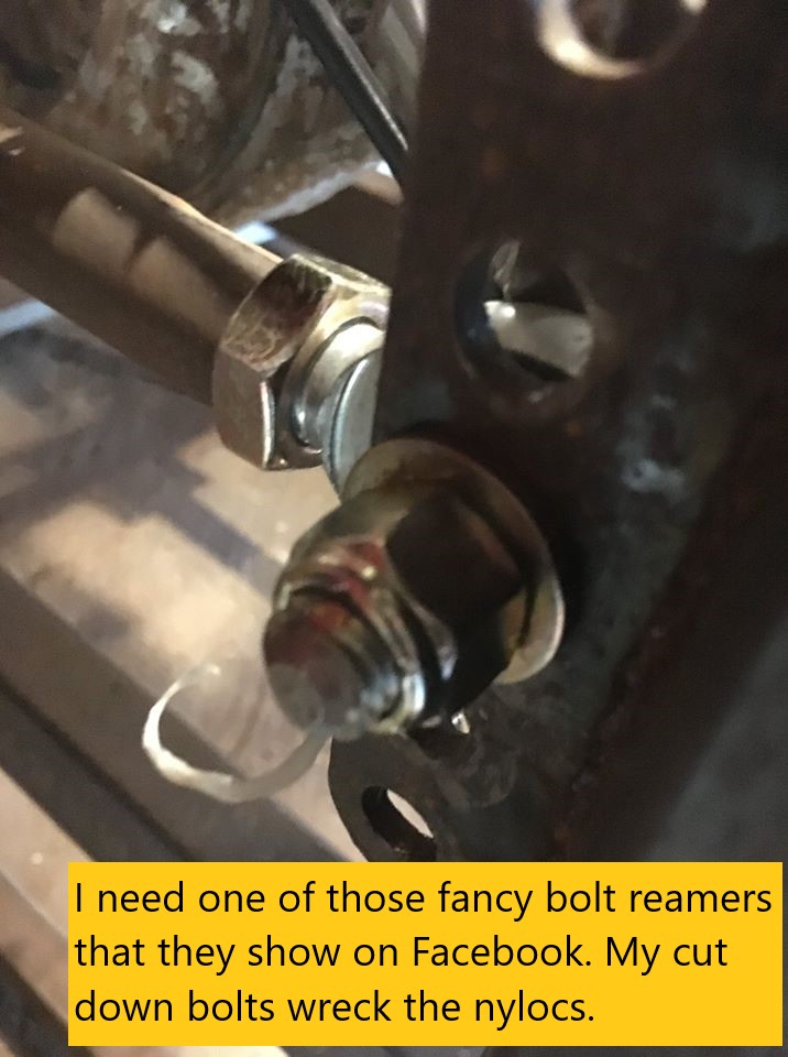

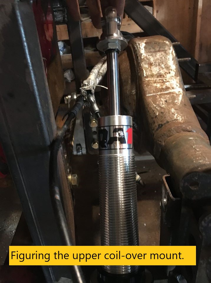

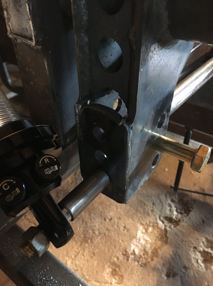

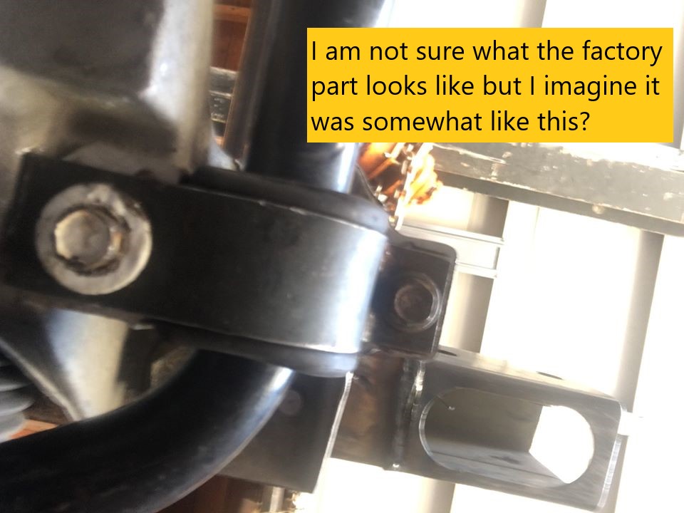

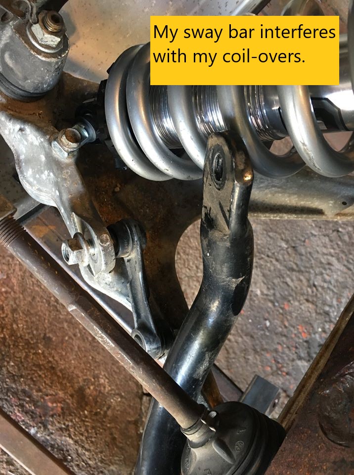

Today we decided to put that money we spent “on the car”. In other words those coil-overs will look better on the car than sitting in the wheelbarrow in the sea can. Some of this will work out just fine and some will apparently not.

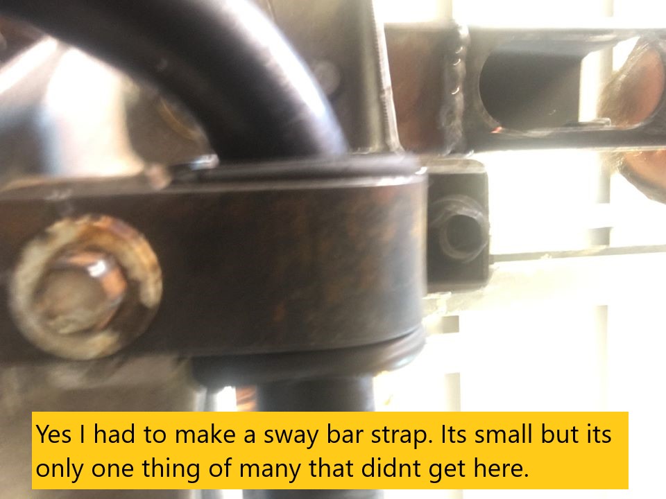

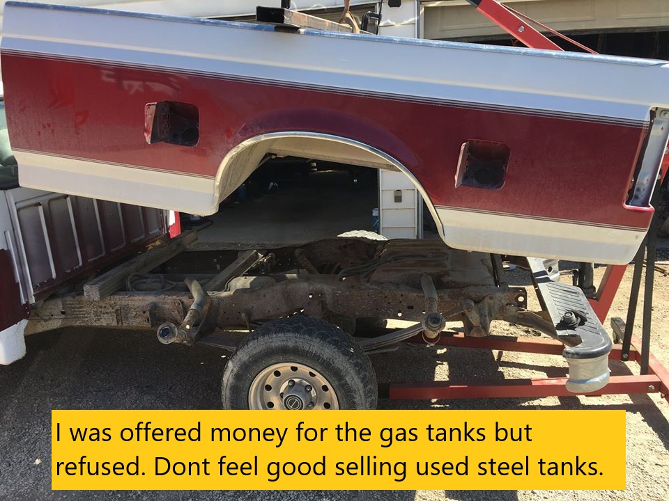

Earlier in my build thread I stated that the guy I ordered my Vette parts from was a flake. Although none of the big stuff was missing a lot of the little bits didn’t make it here. Today I had to make something simple that was supposed to come with the deal. As long as the initial stuff took, I decided that it would be easier for me to just manufacture it.

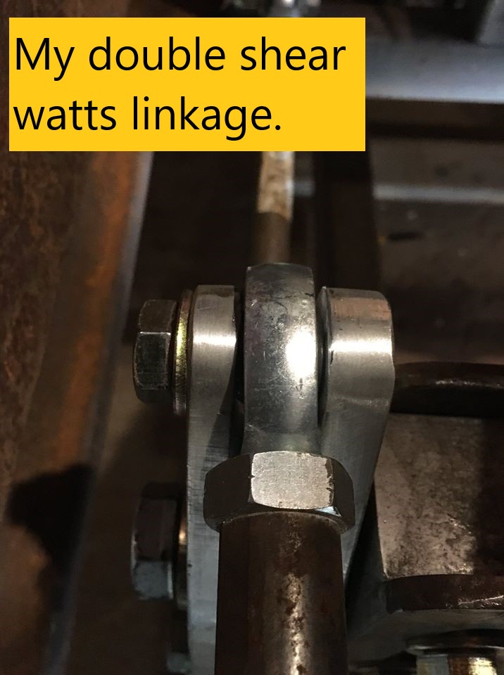

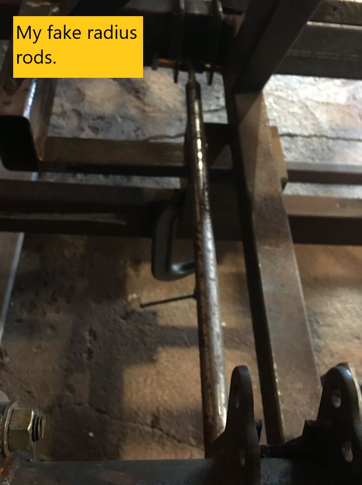

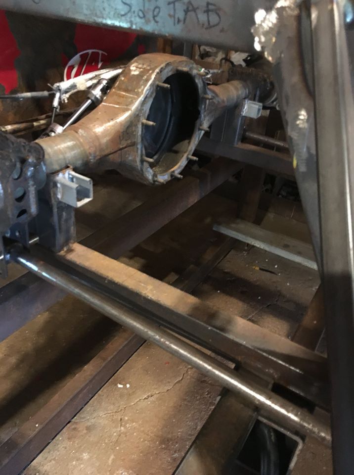

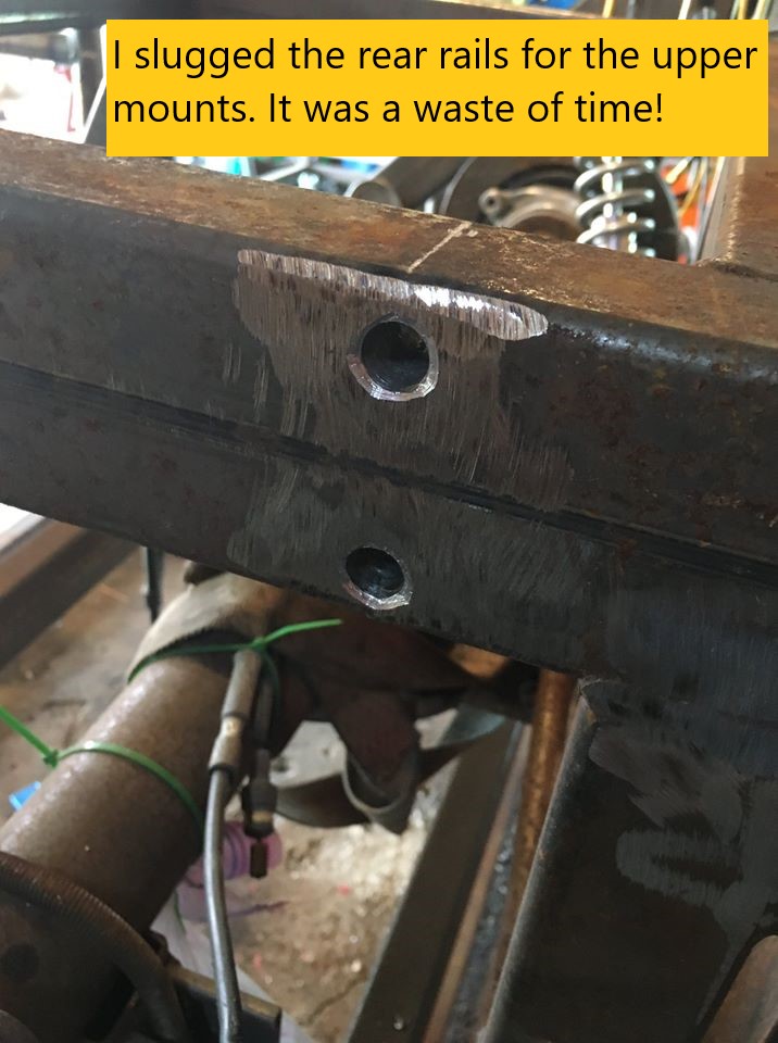

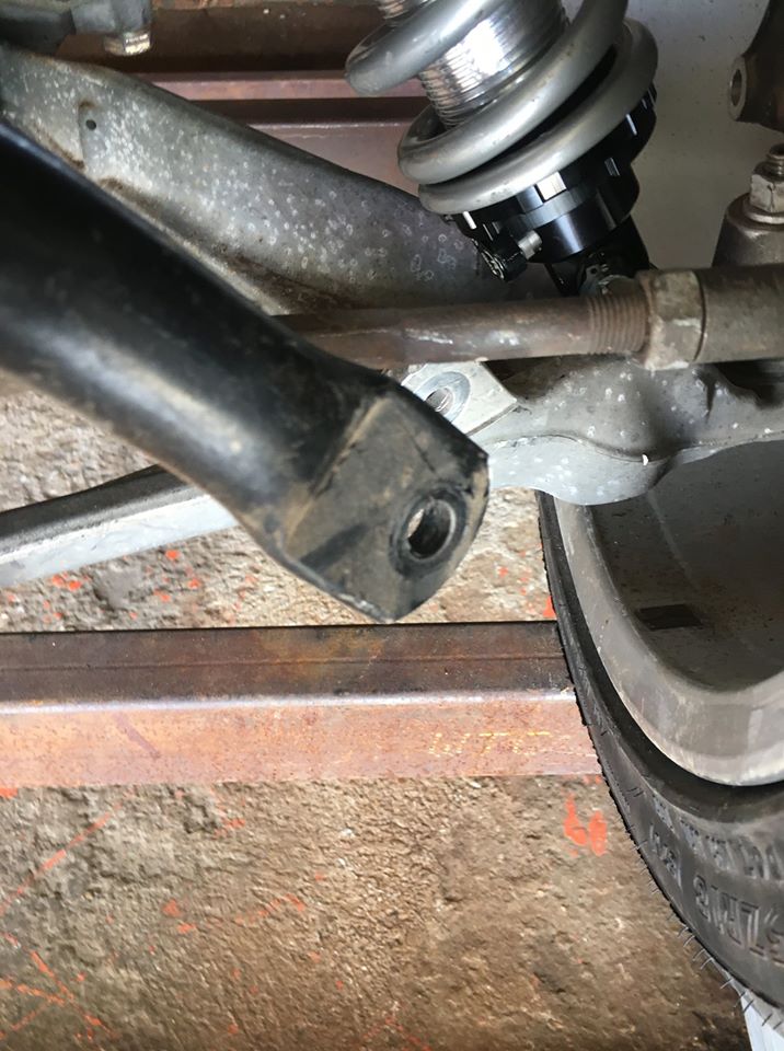

I needed to remove the U-bolts that were holding the rear end in place. They were interfering in the placement of the coil-overs. Because of this I had to make some fake radius rods and install the links for the watts linkage so it all stays in place.

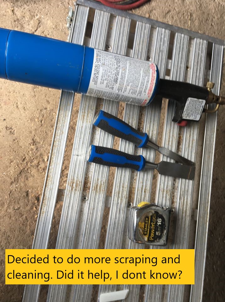

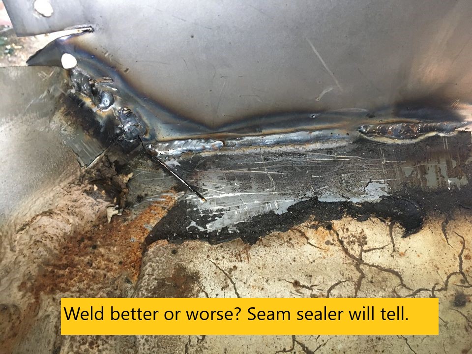

Today’s project was to do the driver’s side wheel tub. We can see if I learned anything from doing the first one.
