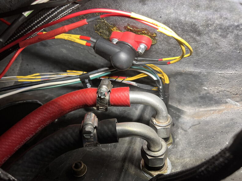

Today I will be working on the Battery Hot and the Vintage Air Heater Hose with the ICT Billet Hose Connectors.
I mocked up the wire routing using Velcro straps which will eventually be replaced with Heat Shrink Tubing.
One down One to go

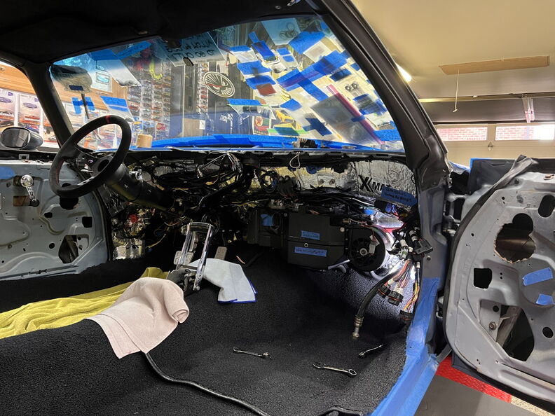

Here we go !!!

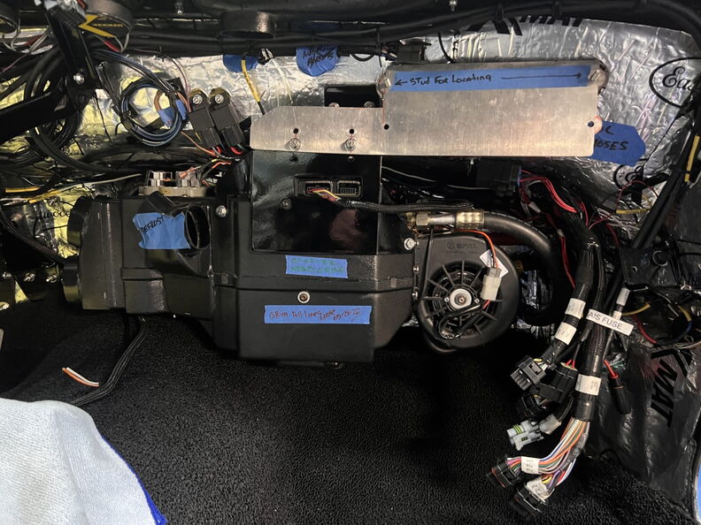

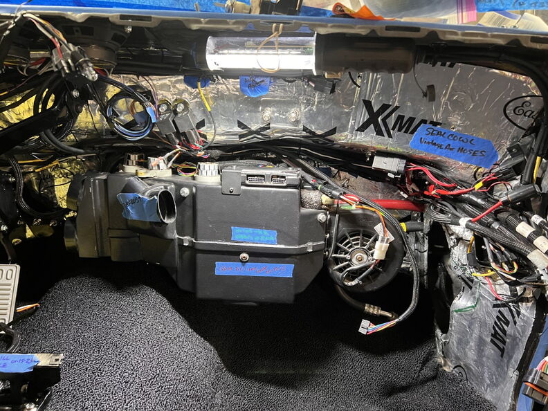

First up is to install the Vintage Air Unit.
Since I have no hair on my head I started wearing a very thin skull cap from Headsweat. It's not a true Bump Cap so l am calling
it a Tap Cap as it gives me warning that I am about to hit my head on something.
I sprayed the drain hose with WD40 Silicone to help it slide through the floor drain grommet.

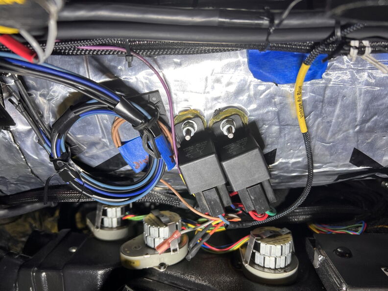

Of course the fun part is installing all of the nuts.
It's hopefully hanging for the last time.

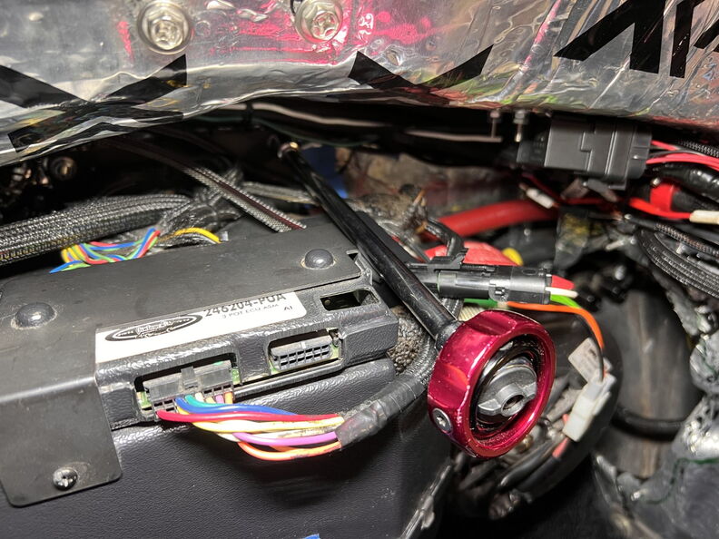

I double nutted the Relay's to make sure they don't fall off. I had planned to use a Nylock nut like I did on the other's but felt it might be brutal to have to remove while laying under the dash.
I am stilling trying to decide if I am going to run the Neutral Safety Switch wiring under the carpet. However, I am going to use the Orange & White wire for my under dash lighting.
A small feeling of accomplishment
Honey I am going in...hopefully for the last time.

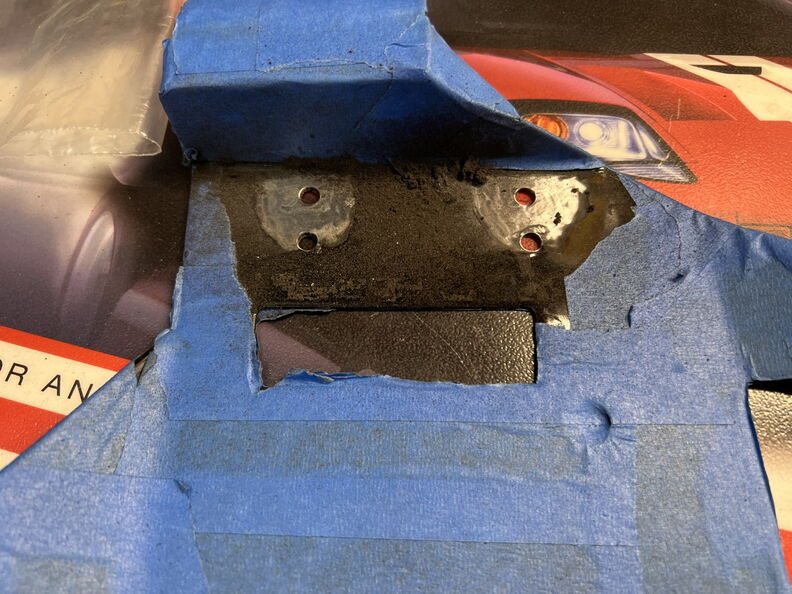

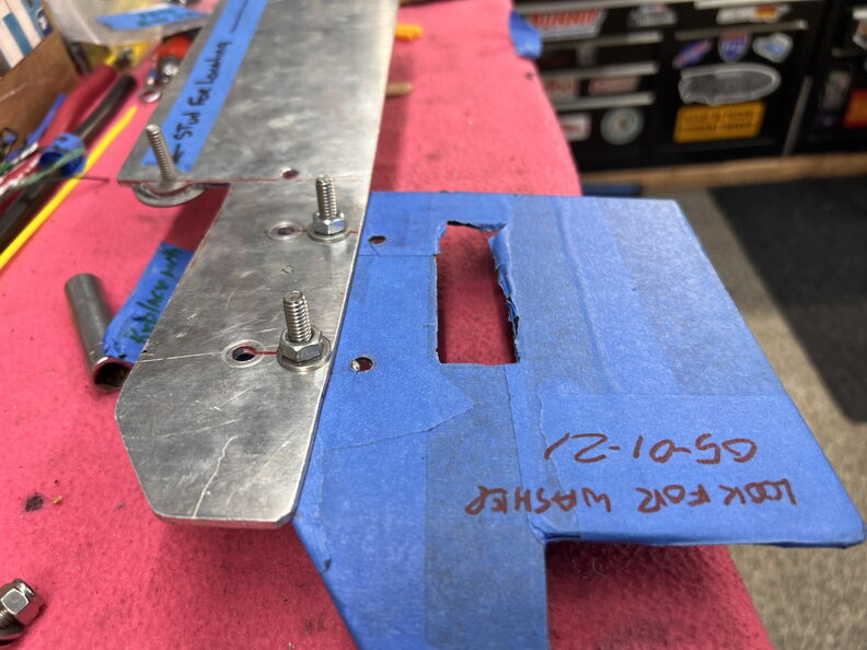

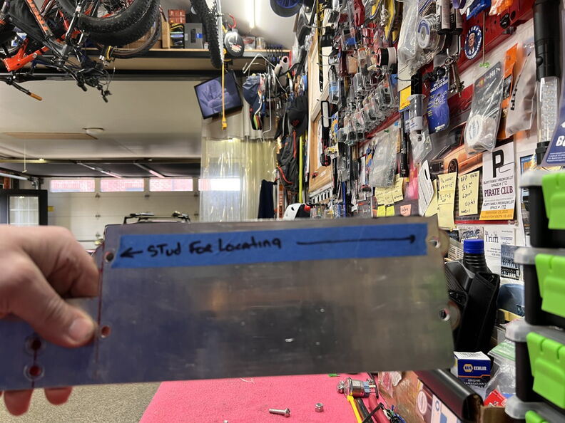

A long long time ago I made this really cool bracket to mount the Holley ECU and today hopefully will be the last time I hold it in my hand.
Since the top two bolts will be difficult to reach I am just going to install studs to support the ECU. I am even add wing nuts.
Test Fitting the bracket.
I will be using the weld studs to hold the bracket.
Modified Weld Stud
Test Fitting
Removing some of the Powder Coating.
Bonding the four studs and now it is Taco Time.
I need to shorten the studs just a little.
