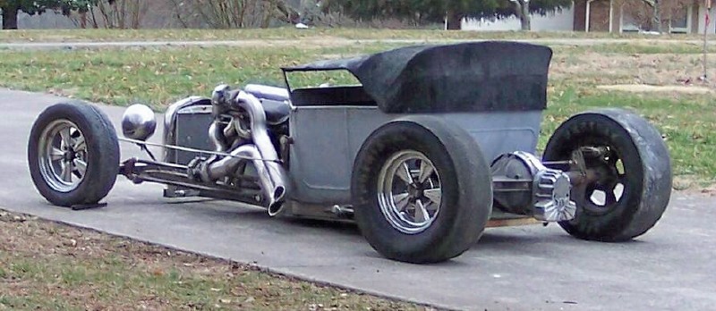

Thanks for the info. I was thinking about yanking the vintage Frankland from my turbo T bucket project, but I think I'll leave it be. I'm going to try to find a later one from one of the local dirt track guys. That way I won't feel so bad if it blows up.
