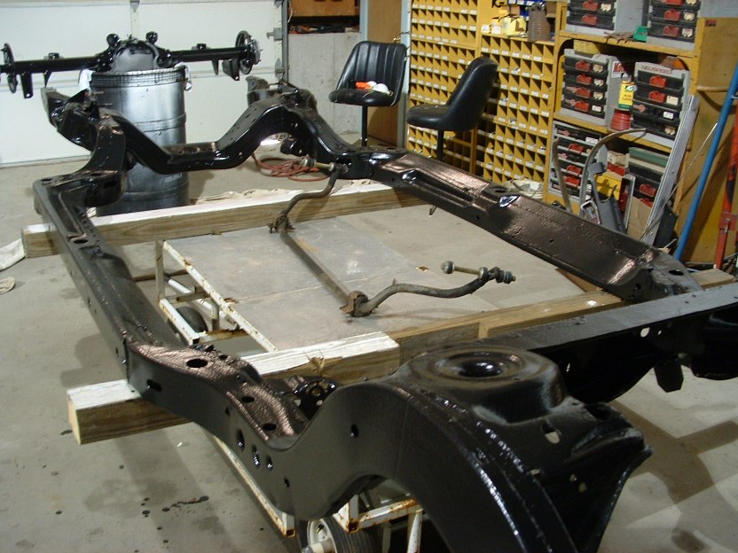

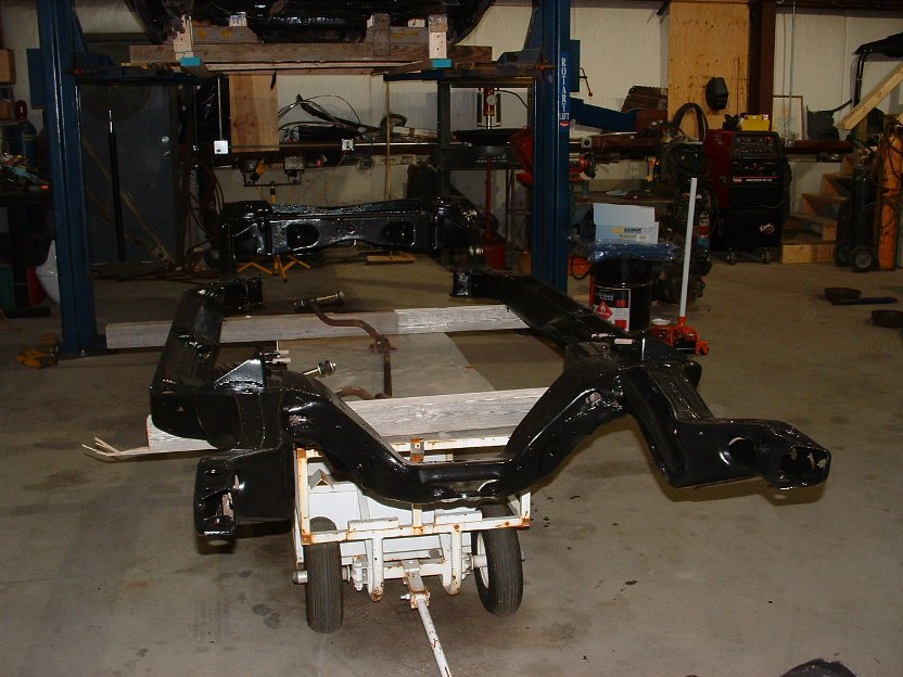

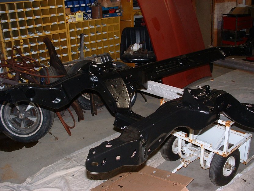

This is what I got so far , hope it helps the por-15 is gloss so I top coated with the chassis coat
