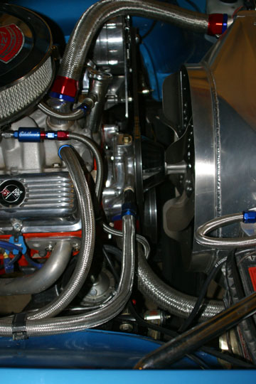

Here's the space I have to work with. I can space the fan forward another inch, that shoul leave me room for the blower belt. It's 6" from the front face of the head to the front of the existing pulley.

I can't recall ever seeing a Procharger with a mechanical fan. If you get rid of it and the shroud you have tons of room.
I know that's what you're trying to avoid, just my two cents. Electric will make everything way easier, and with the correct one will out-cool that mechanical, especially at idle.

But I like my mechanical fan, and my alluminum shroud. Hard to imagine such a simple device could be so "unusual" these days, and it does cool really really well. She runs at 180, period.
Another inch of spacer will buy me the room for the belt.
