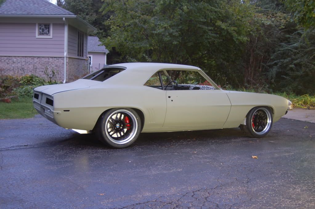

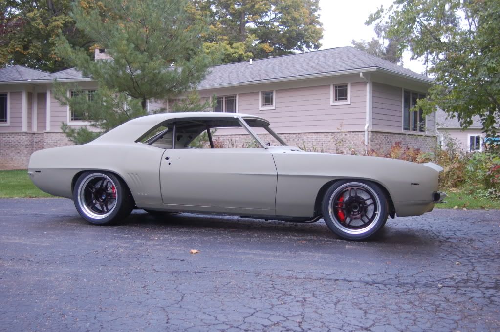

Originally Posted by 89 RS View Post
Awesome work Mark. Any pics of the wheels yet?
Got my Fikse wheel today with Toyo R888 tires 275 front and 335 rear
