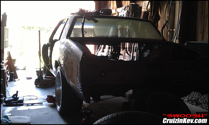

today's update. test fitted my 20x10 wheel and oh well it looks SWEET!!!!
brought body back on frame, put the stock rear end back on and tested the wheels again - wheel rubs bad on inside of the frame. will try a wheel adapter to make it fit but maybe will also notch the frame a little. but will test with a adapter first.

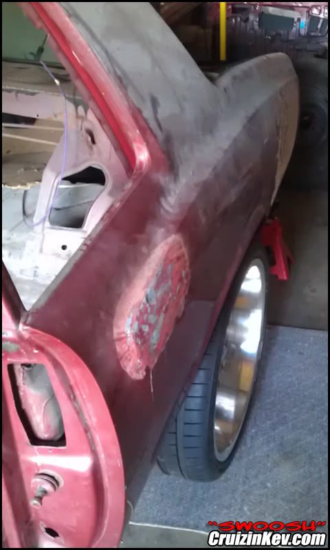

I test fitted H&R 20mm adapters/spacers on each side today. for first on fronts - now the front wheels clear the C5 calipers
so I tried the 20mm spacer on the rear and it looked like this:

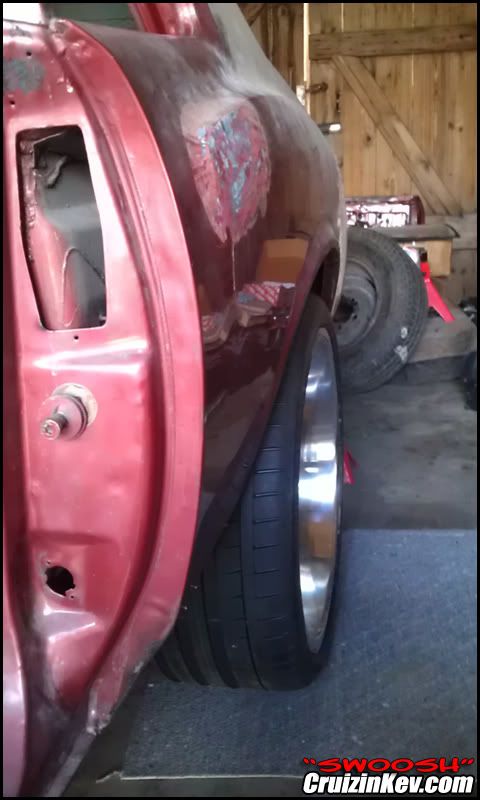

I think it looks okay and clears the frame now - but I think I want 30mm spacers now just added some washers to simulate a 30mm spacer:
Please note there's no weight/interior/doors/engine in the car so thats why the suspension is pretty high right now LOL

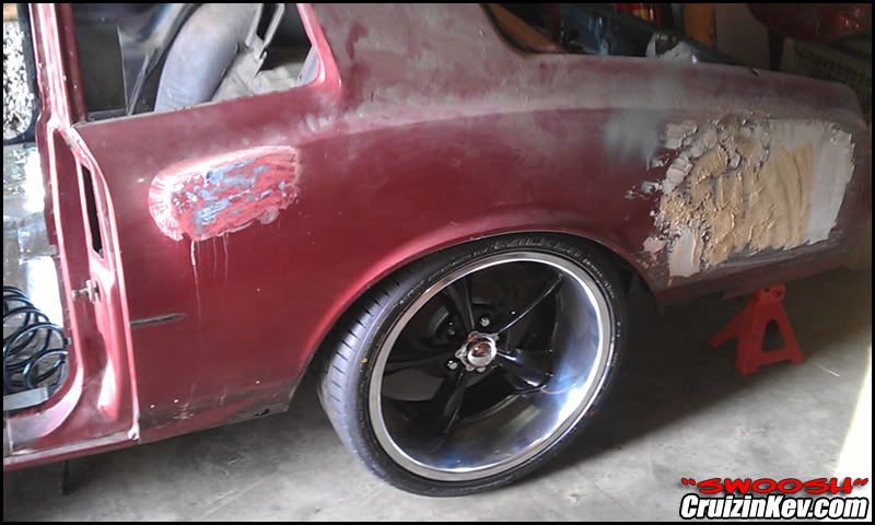

oh and here's another cool shot (with 20mm spacers):

Looking fine now! Even with the 20mm spacers. You probably need to roll the fenders with 30mm.
  #106
Old 08-04-2012, 07:16 PM
I agree with Knaller the 30's might be tight to the outside.

thanks guys! yeah I'll cut and roll the fenders lips

today I cut my rear fender lips a little. stock lips are about 1" wide.
I half cut them and will roll them later to clear the tires.

I removed the rear springs yesterday and set the car's height to what I want the ride height later. I wanted to see if it'll fit with the trimmed fenders lips and the 30mm spacer. Looks like I just need to roll the lips now and I'll be set.
