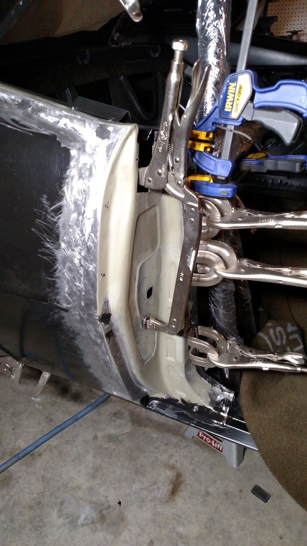

While stationed in CT she didn't do so well with the weather and salt, so .... I'm going through and replacing all the sheet metal that warrants new. The floors and the roof are great, the quarters behind the rear wheel and associated outer wheel well need patching. I already patched the trunk weatherstrip under the rear cowl (rusted bad), and the right inner rocker panel under the side cowl rusted out. The biggest problem was the cowl and associated side panels, seems the windshield leaked and it took out the dash and the cowl. I already have a replacement mocked in, just awaiting some side cowls and some warm weather.

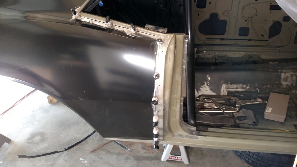

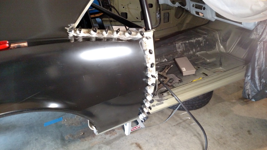

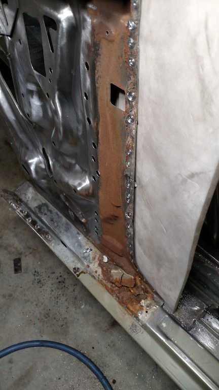

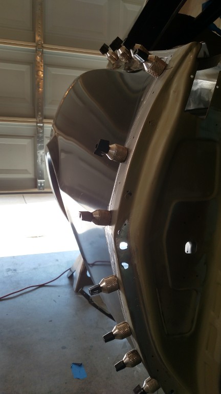

Got out to the garage today! I got most of the outer rocker panel patch welded back to original (I cut out the skin to get to the inner rocker panel). And I hung the drivers door with the new/ rebuilt hinges, it's pretty close.
The passenger door had been repaired before with slide hammer and bondo - so that door gets a new AMD skin here pretty soon.
Well here are some new pictures of my progress.
Inner rocker panel patched
Outer rocker skin re-welded, still need to fill a couple holes
Rebuild the hinges so I hung the door, excellent condition.

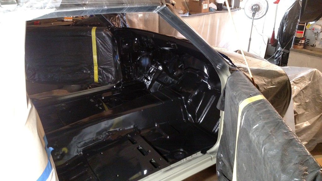

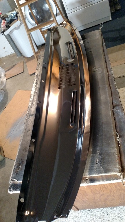

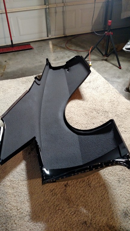

Update 12/31 Garage time spent wisely with the passenger door, cleaned all the rusted areas and POR15 the frame. When the POR15 dries I'll put a coat of POR black on the frame and tackle the skin later this weekend. I haven't done a skin before so .... this is new to me.
I need to do the same with the back side of dash that has the same level of rust, that will be next on my to do list.
Rusted areas POR15'd
Better than new!

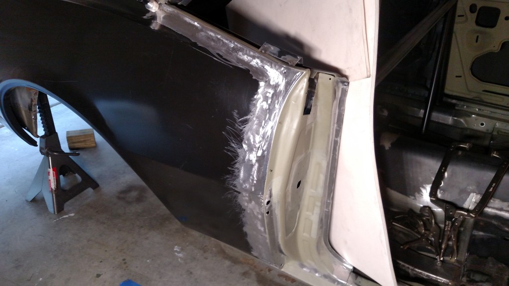

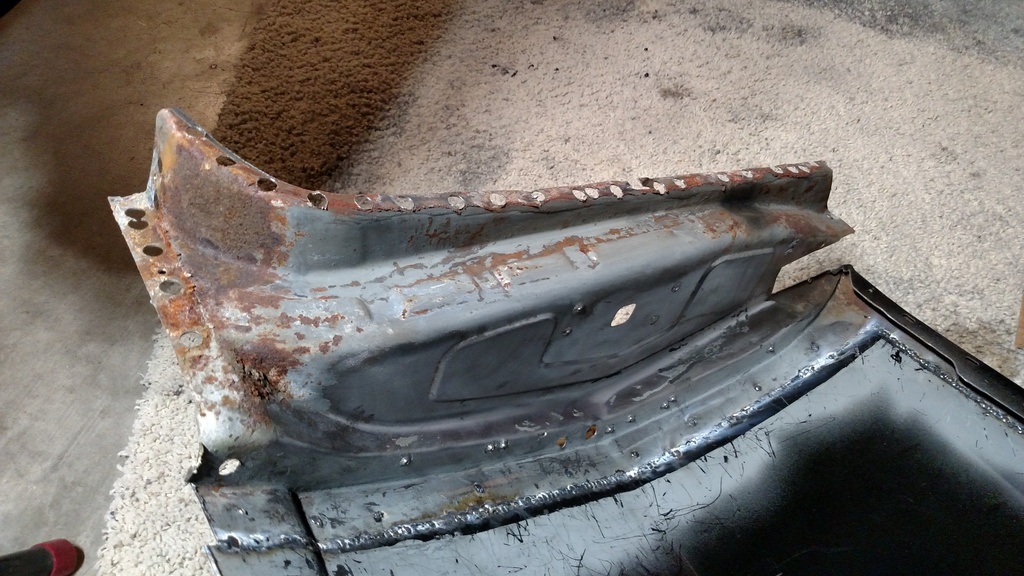

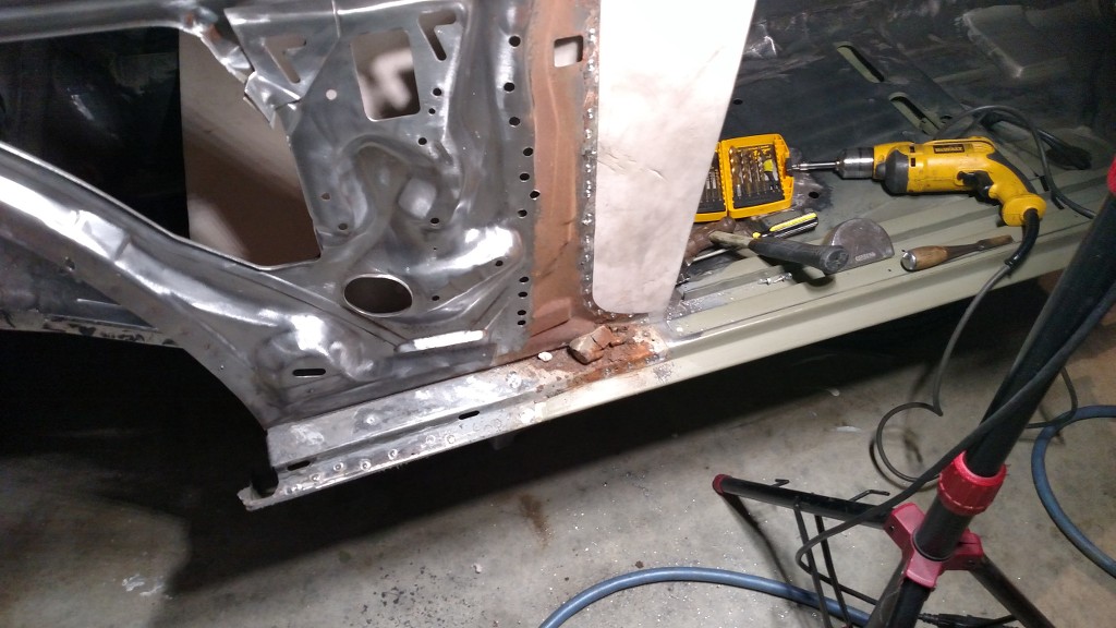

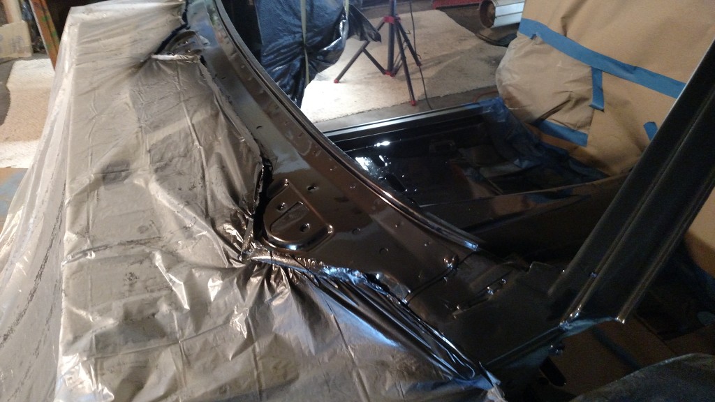

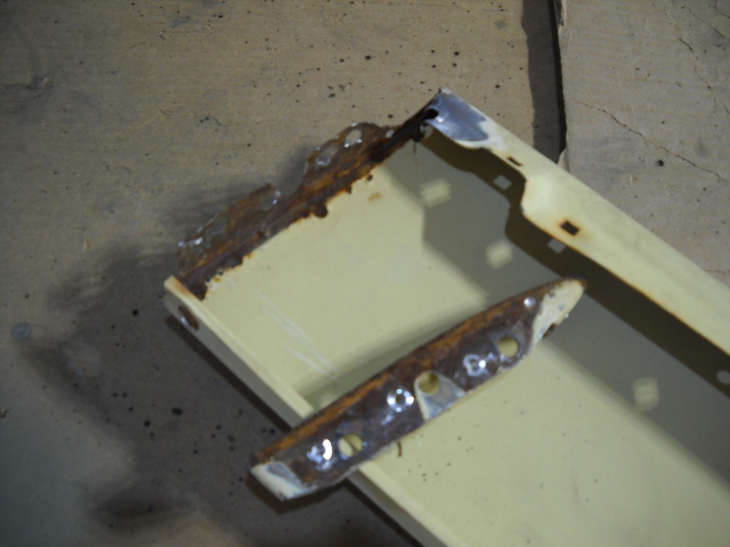

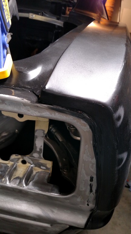

Update, didn't get to my passenger side door yet, had to finish the passenger side cowl repair I started. Finished welding the patch and cleaned the rest of the outer rocker with 36grit. Thought I'd show the rest of the problem areas of the my car, really - it's worst than it looks!
The under coating actually saved the wheel wells, the only rust is where the spot welds attached to the trunk, to mini tub or not?
The trunk is pretty good with the rust limited to the corners where the water leaked past the weatherstrip and sat in the corners, simple patch.
The door is on my to do list this weekend, can't look at this anymore
Rocker repair, much better.
Cleaned the undercoating off the wheelwells.
Undercoating actually saved these wells - kinda- rust at spot welds!!
The lovely door repair
Left wheel well again, not bad
Close up of the rust at the spot welds
Left rear quarter rust cut out.
This is my bondo door
Trunk rust is limited to the corners where the water sat.
Rest of trunk is great!
