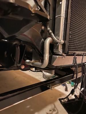

I got the car back from the welder, partially done. He did the sub frame connectors and the exhaust ,but said he couldn't do the main thing I wanted done the, coil over conversion. It ended up being a lesson learned that I don't seem to be getting through this Portuguese Cabeca.
Now it's time to find someone else to do it.
I got some work on the plumbing for the heatexchanger The lower tubing at the bottom was easy 3 90's welded up from pump to exchanger. The top was a little harder finding room for the tubing, the A/C line and the RS door. A little trim on the door, re arranging the A/C line and a hole through the rad support with an AN fitting for the hose. Making the hose fit on the supercharger around the fuel rail crossover.
Here's the bottom tubing
