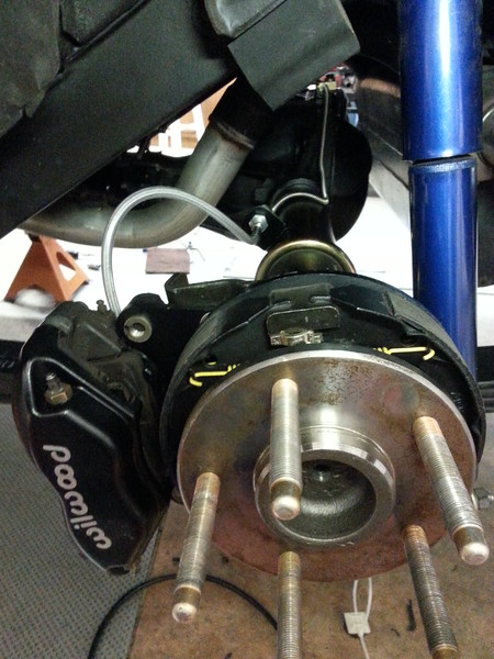

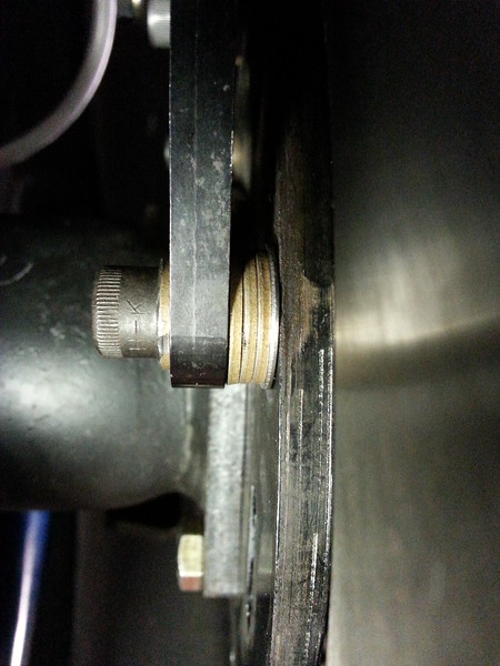

The offsets were off .394" or so which means I need to fab new spacers for the caliper brackets but that's no biggy.
I'm pretty sure the rears are Wilwood BP-20's and Tobin said those would be near ideal for balance with the Hawk HP+ pads up front. The Dynalite calipers have more clamping force than ideal for the C5 caliper up front so the pad should tame them.

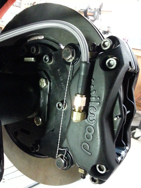

Progress was slower than I'd hoped but still decent progress. Hard lines were built, drop line installed, axles in, offsets checked and need to be altered -0.394". Funeral out of town tomorrow so I'll get back on it Sunday.

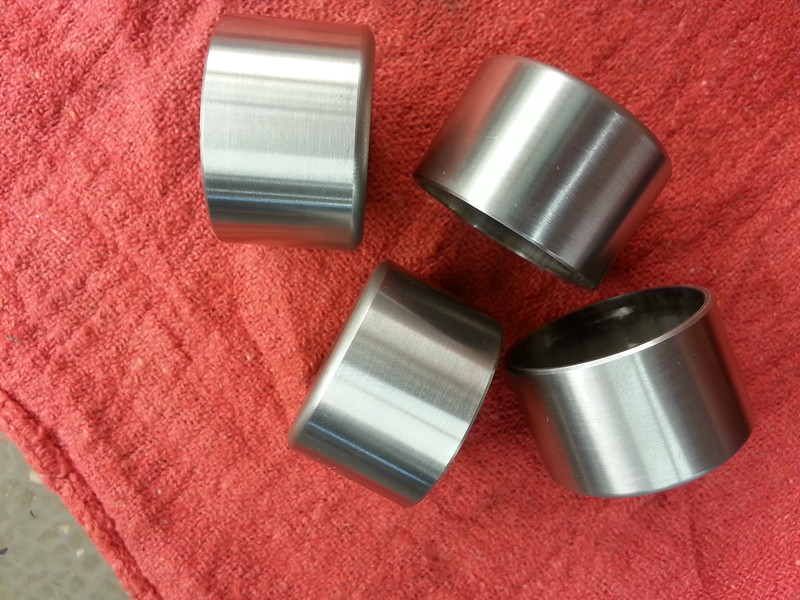

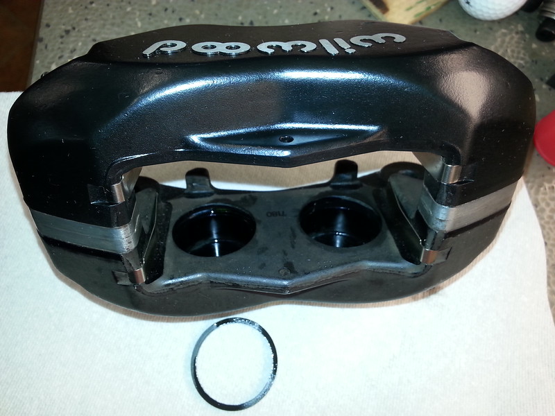

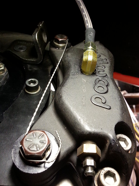

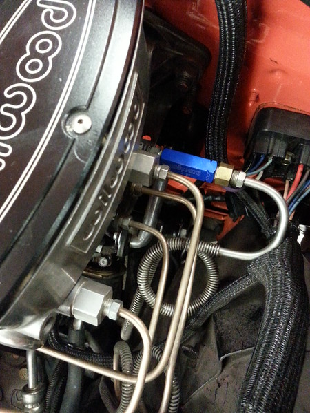

There's light at the end of the tunnel! 2 lb. residual valve installed, backing plates located and torqued, caliper brackets shimmed, line brackets painted, lines mounted, wheel clearances verified, Moser C-clip axles are in and the differential refilled. Basically all that's left is to measure e-brake cable lengths and order and bleed the system.
I opted to shim with grade 8 washers and one stainless vs the cutting down the aluminum Wilwood spacers.

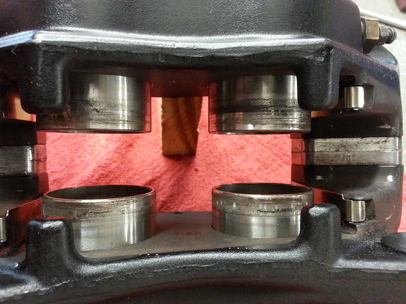

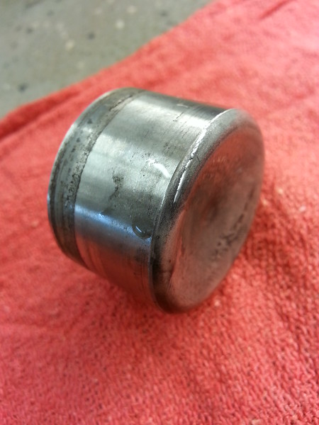

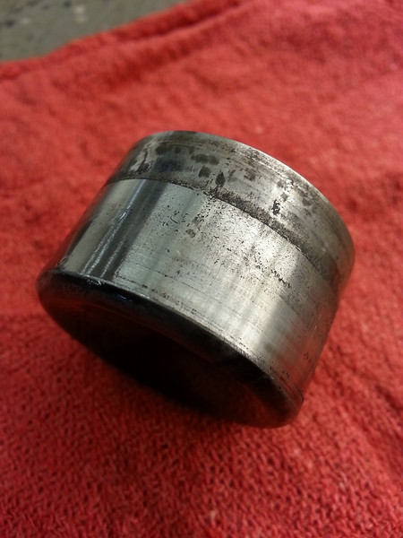

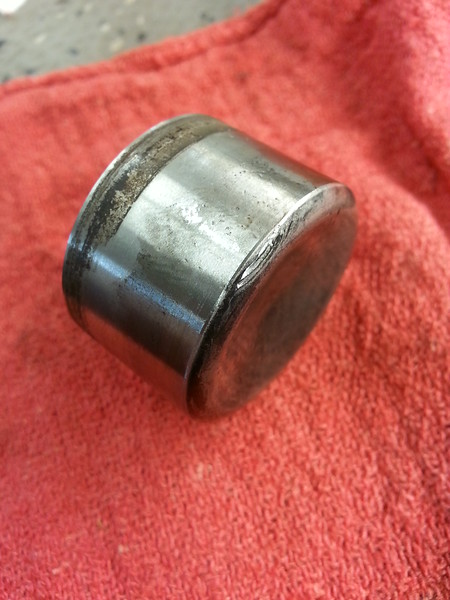

While positioning the calipers I noticed one pad didn't want to compress back into the caliper with reasonable force...........so off the calipers came again and I pulled all the pistons and seals figuring if one's questionable the other probably are too.
A little buffing with a red Scotchbrite pad and good as new.
Seals were easy to pop out with a dental pick, wiped the bores and seals clean, used a Q-tip on the seal grooves, and wiped the seal and piston with a very lite coat of WD-40 before reinstalling. Pistons now move properly in their bores.

I've stated before about guys should bleed their brakes on these cars completely once a year because brake fluid is "hygroscopic" meaning - it absorb moisture.... Obviously the moisture in the fluid did a nice job on the stainless pistons!! Thus proof of what I've said in the past.
Really nice job you're doing mister! I hope it's a noticeable improvement when you're all done!
