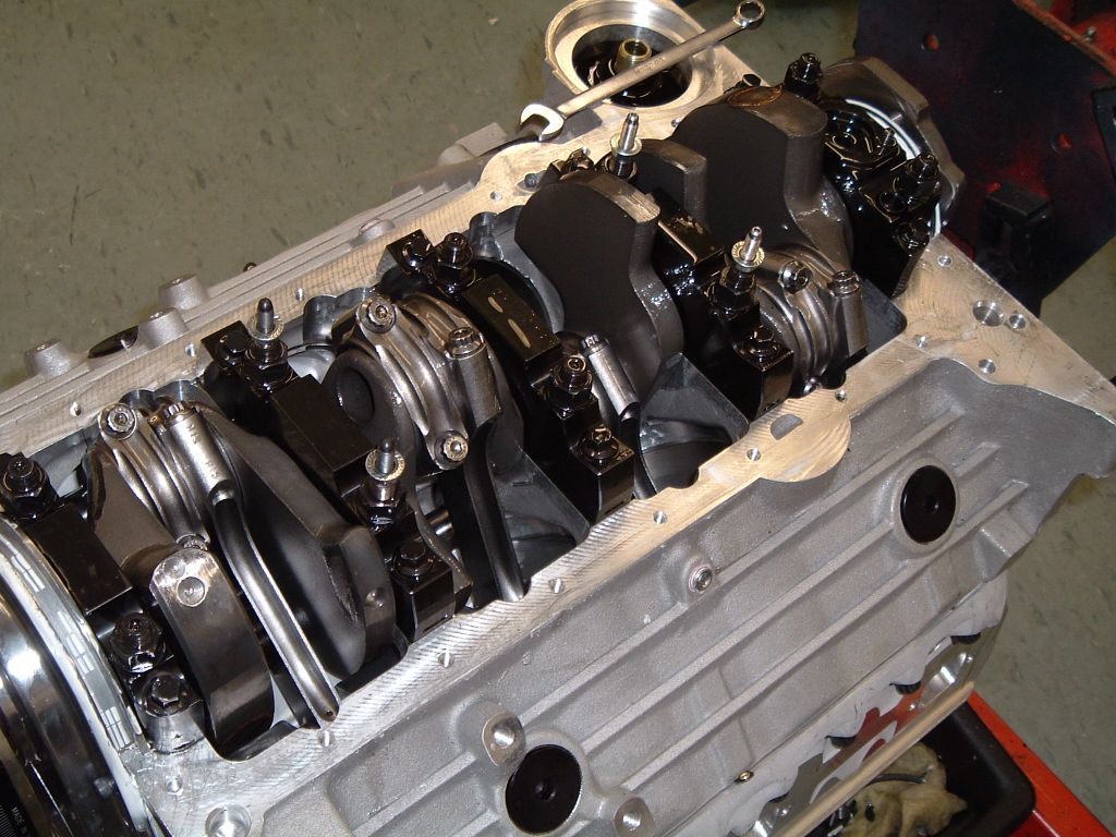

Here's a picture of what the dart alum. block is notched from the factory and it clears my 4" stroke, 6" rod combo (callies crank/rods) just to give you some idea of packaging. You will need a pan with notches too unless you want to get real creative. (pan spacer, etc.)
It does raise a lot of 'why' questions though on the 350 block-- there is a lot of HP to be gained by that extra 1/8" of bore, not just cubic inches, but in unshrouding the valves. One of the reasons why '358' cid busch/cup motors are big bore, short stroke.
