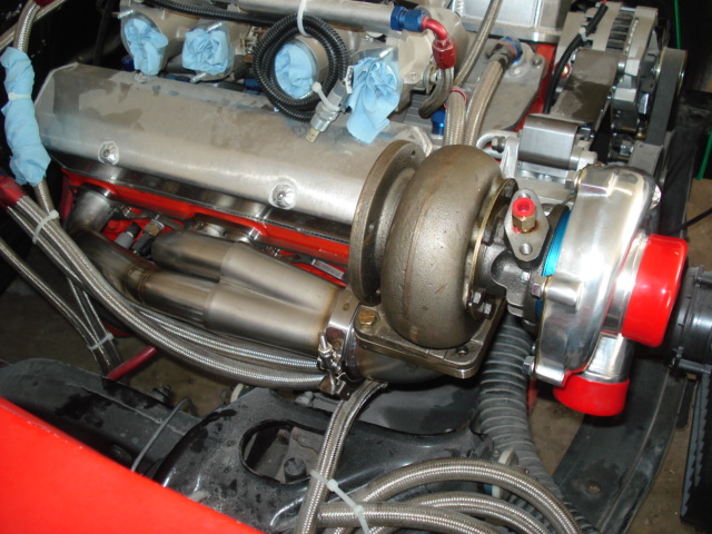

Here are a few pics of the SBC manifolds we are working on. The LSx set will be next. The can be done in mild steel, but we prefer SS all the way through.
As a side not, the Nelson package at $7500 for the maifolds, turbos, wastegates and BOV;s is not bad at all. You get what you pay for for sure.

nice work the pics wont let me blow them up when i click on them though

I am not sure why they will not work and will contact Scott & Jody and see. I am going to attach a couple pics of them in the car and hopefully they will work. It looks like the manifolds by themselves will run $2500-3000 in 304 stainless.
