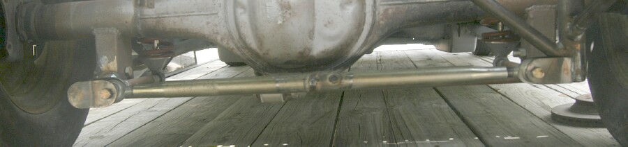

one more pic of engine bay with close out panel from grille to rad support.
car is loaded on trailer right now and im taking it in the morning to get the panhard bar bracket made and installed ...i had a temp in place do to the guy not finishing that part of it when rear suspension was done . i dont have a tubing bender plus i know how impportant that bracket is to the car so i have to have that part made and installed by a pro fabricator..

worked all day yesterday and couple hours this morning on it panhard setup is done and it is tied into the car solid...i ended up doing most of it myself at my friends shop.we made a plan and i cut and tacked it .he finshed the welding..he welds and fabs everyday..i dont .i wanted it 100% finished correct .
put 1/8 plate on the inside frame rails then used 1 3/4 heavywall tube going between the rails put a cope on a piece of the same tubing and put it up against the inside right rail and it comes straight down capped it with 1/4 solid and used 1/4 flat stock to make the tabs soming off that to mount the panhard bar.traingulated two ways with smaller heavy wall tube .one to frame rail and one back to the 1 3/4 between frame rails .made bracket to go on rear as well out of same stuff.
its solid now.......
i know you guys pobably didnt need the build specs..im just happy how it turned out and that its done....
