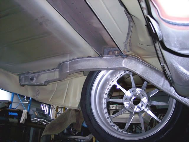

Guys check out this pic of the new rails.
I really love what Mike is doing here, was going to do something similar myself but he beat me to it.

Mike says you can fit a 17" tire in a 69 Camaro with his new rails.

Looks good! Do you have to use a c/o based suspension or will leafs with off-set shackles still work?

You can run leafs w/off set shackles up to a 315mm on 67-68 and 345mm on 69 .You will need to run a 4-link suspension to run a 355mm or bigger tire on 69 bodys.
