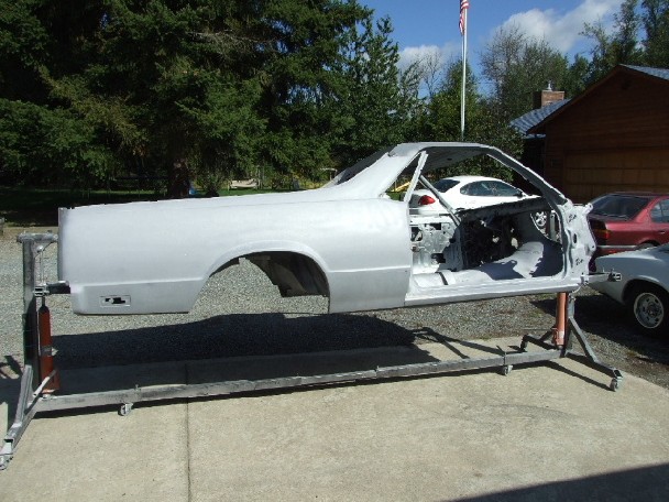

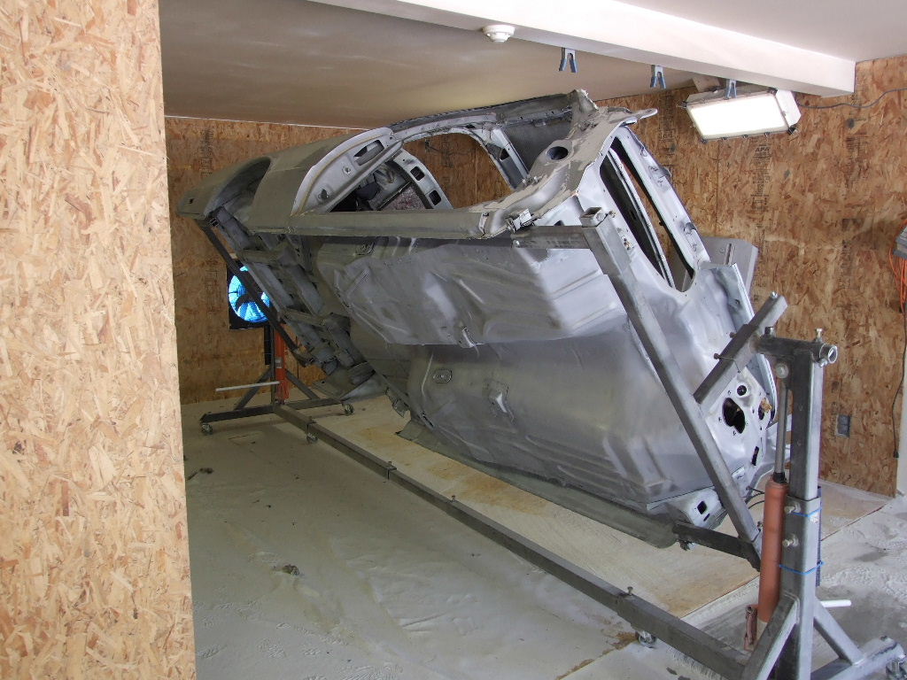

After trying many methods to remove the undercoating I found using a heat gun and a gasket scraper removed the heavy parts of it. The larger area I was able to get down to metal with a 4.5 inch bristle disc. Once I got the majority of it off I sent it off to be blasted. The blaster used glass to get it down to bare metal. The blaster was great to work with and wanted to be sure I was happy with the results. Brought it home and got it into epoxy primer. Have a few things to do with the body before I send it out to get line-x on the underside.

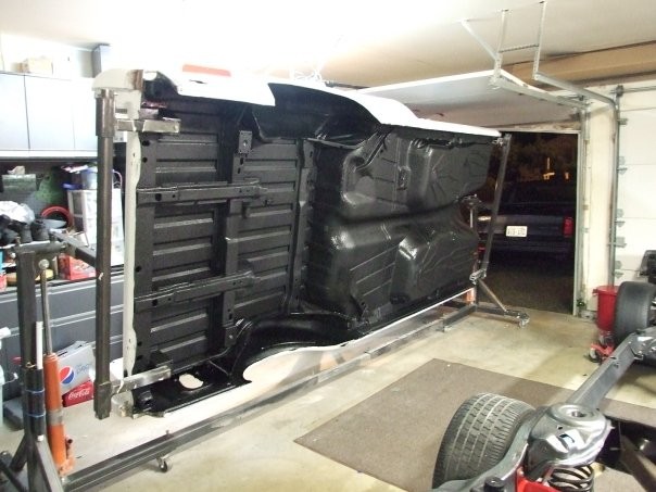

Default Spray-on bedliner
Had Line-x spray the underside of the El Camino. It think it looks real nice. The guys at Line-x in Auburn, WA were great to work with.
