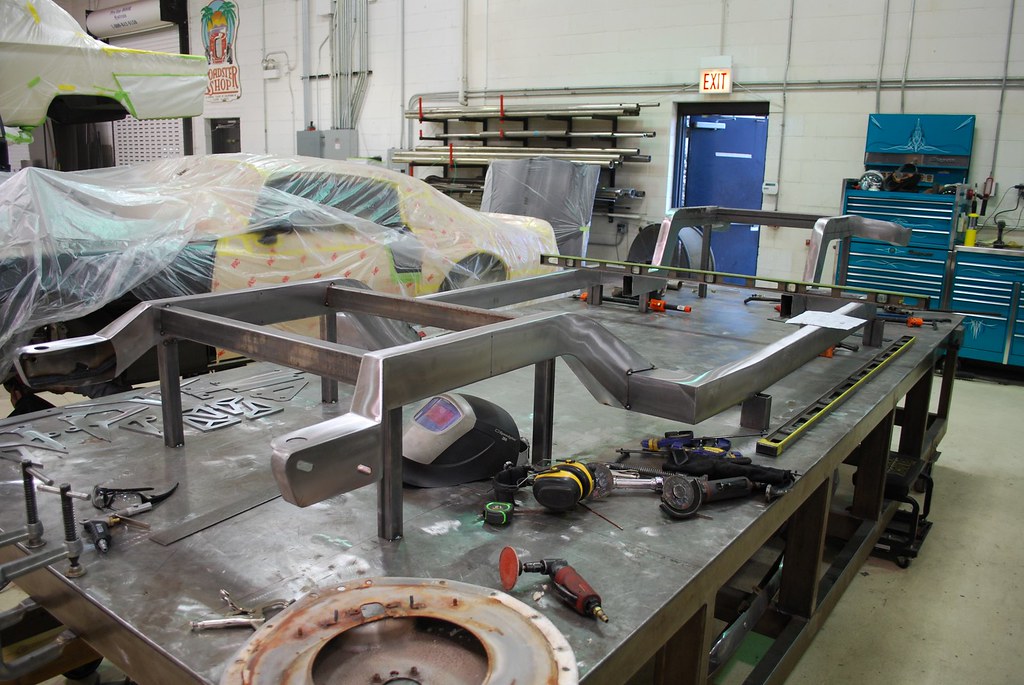

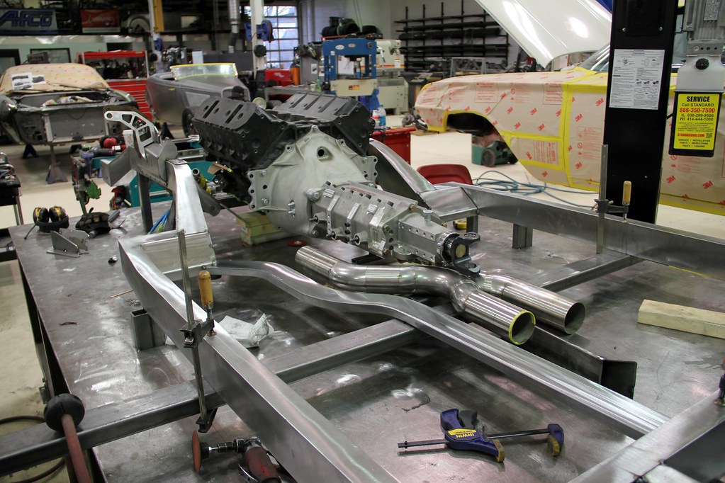

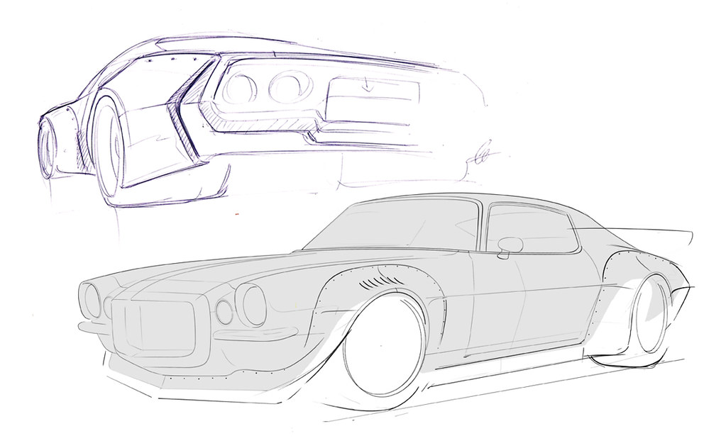

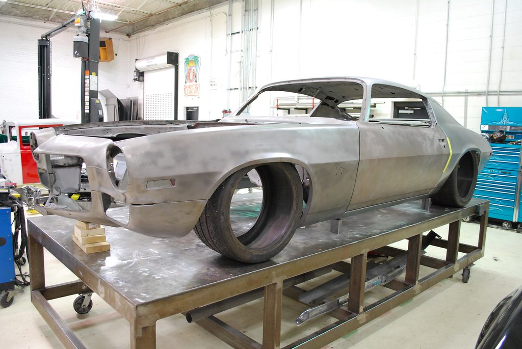

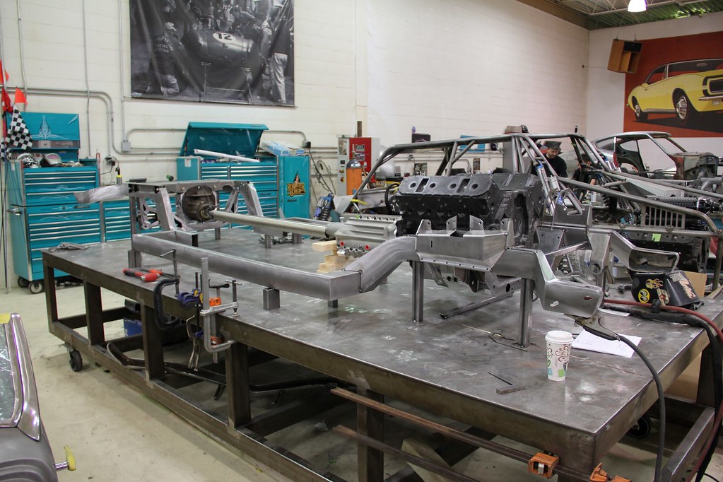

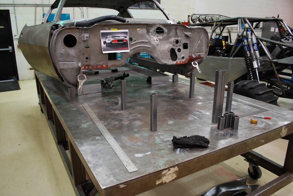

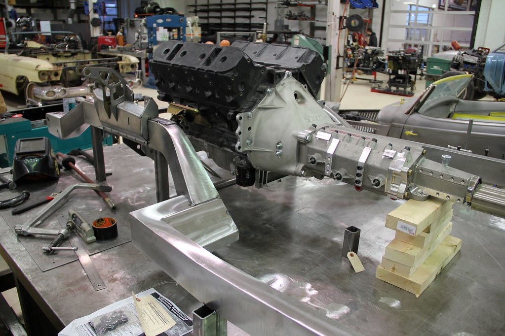

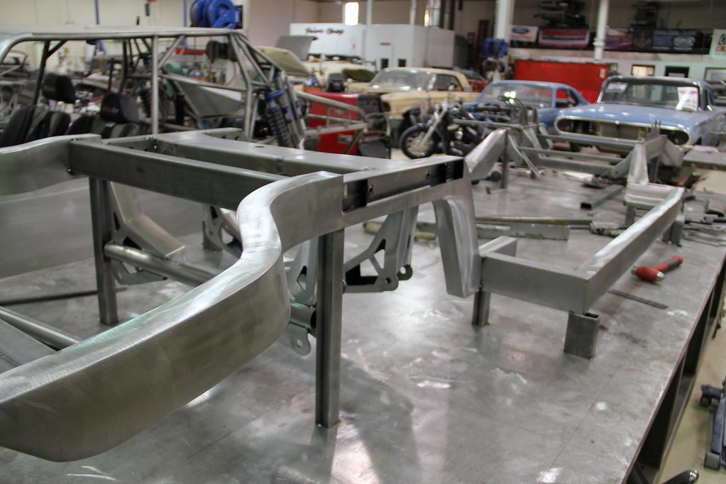

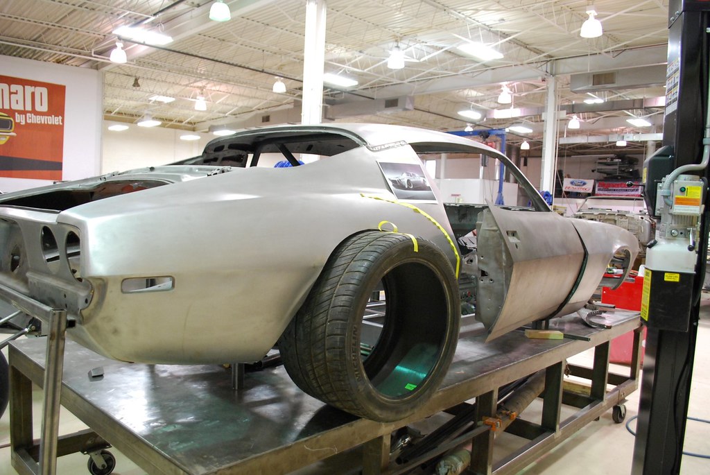

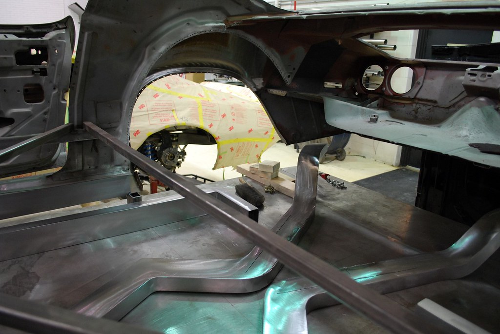

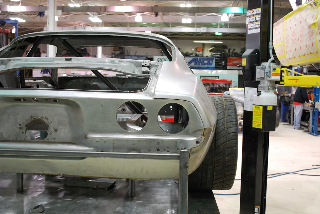

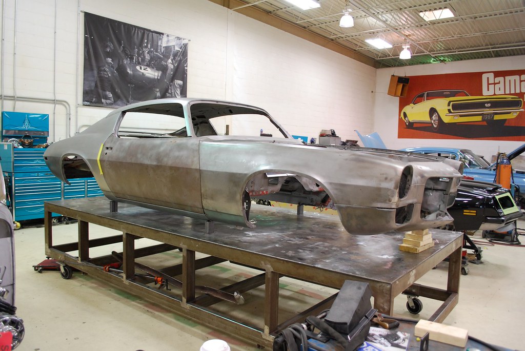

With the shell being prepped, we started to dig into what we really wanted the car to look like.
Wide. Definitely wide. And low. Did I mention wide?
This was the first loose sketch of the 'feel' of the car. 2nd one at the bottom, more of an exploration as to how different a direction we were heading form the stock shell.
Shell up on the table and the beginnings for the chassis layout and construction.
Looks somewhat 'normal' with this setup. We don't want normal...
[/url]
[/url]
[/url]
IRS 6061 rocker arms
[/url]
[/url]
Did I say wide?
