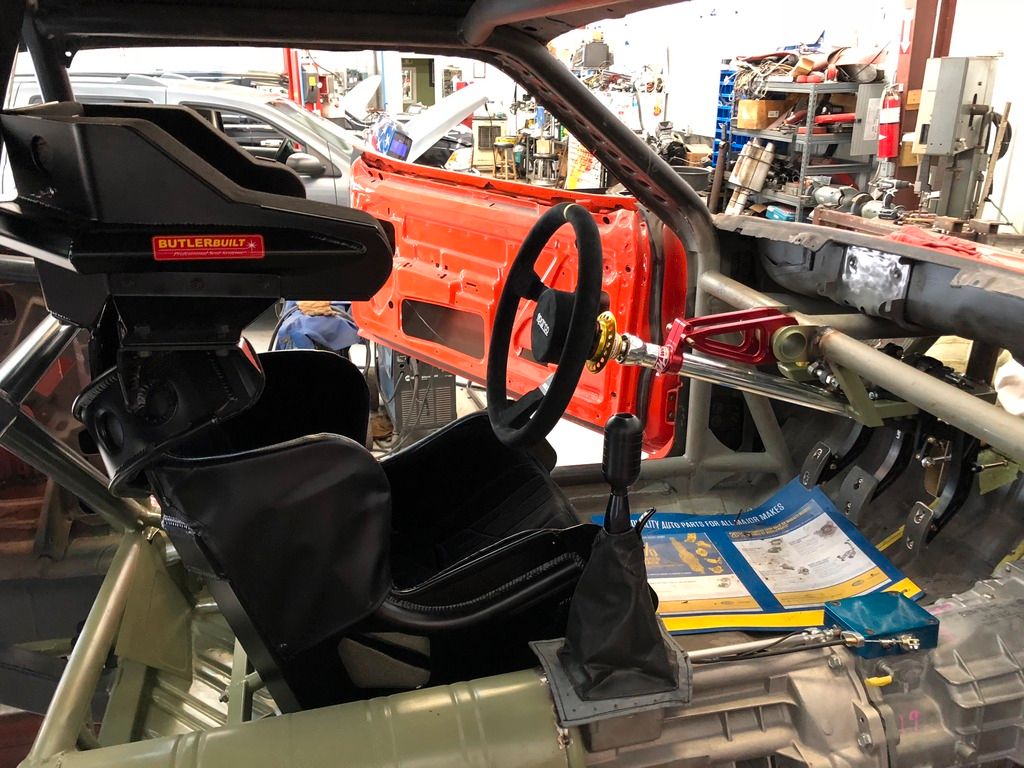

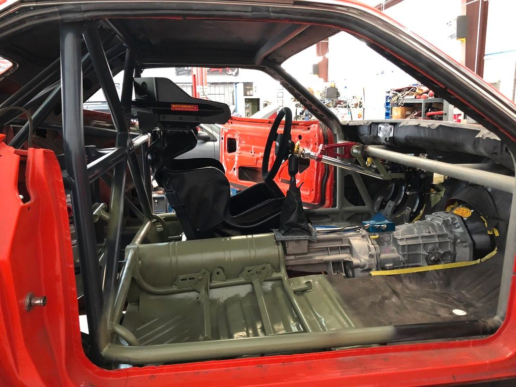

This is the T56 Magnum or TR6060 PPG gearset sequential in a 1400hp Viper.

The shifter on the PPG just mounts on a plate and is connected via a single mechanical link rod, so the shifter can be mounted about anywhere. I went with an XL tail shaft to move the shifter inline with the steering wheel. Just barely move your hand off the wheel and it falls right on the shifter.
You can see in Greg's vid of Benny driving, he is having to "reach" to shift the car. The shifter location could be moved for better driver ergonomics.
