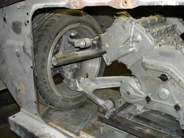

A few progress shots. Motor will set really low in the chassis. The headers may be a little snug...

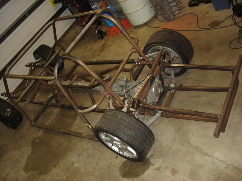

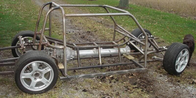

I attached some photos. The rear shocks are in the old configuration. I don't have anything new yet, Chris is still working on the rockers.
Jason-
Wow! I just finished looking at your post. Really sweet. I thought briefly about doing the suspension work myself, but quickly chickened out. Luckily I found Chris at Activepower (check out his website: http://www.gtreproductions.com/Default.htm) who had the exact vision I did. Something I can drive the snot out of! I was actually set on the northstar motor for my car until I found some Aurora parts on ebay. The last photo is my worst fear for it, though.

WOW, that is one big hole. What are your power goals?

Sorry John, I should have been more specific. I'm not concerned about the block I have, but about punching a hole in a new one racing it. I have been working with a race shop in Indy, and they are confident it will be ok.
I actually took a northstar short block with me to Chris's shop in december and we were going to build to that motor until I found the Indy block. It is so much smaller than the northstar, a 20" cube. The northstar is 3" longer, 7" wider, and 5" taller. With the way we have set up the front frame, it wouldn't even fit now. The really cool thing about the Indy motor is that we have the front of it set back almost to the centerline of the front wheels - with minimal loss of foot room to the driver. Which will allow us to put in a X-member to tie together the upper and lower CA mounting points (like a cobra).
I am planning on 500hp from it, which the shop says should be easy to obtain naturally aspirated and on pump gas. And it will rev to 10K!
