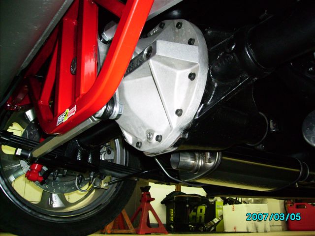

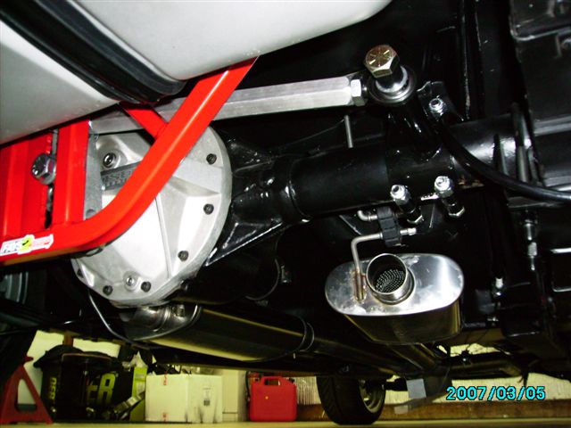

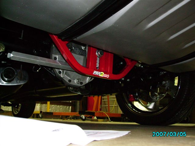

Here are some pics of one of our Watts links installed on a car. This is our Vintage watts....
http://web.mac.com/jbauder/iWeb/6970...-Watt%27s.html
Thanks....Mike

The Lateral Dynamics 3-Link incorporates a Watts Link. There are several members on the board with this set up (myself included). Pictures of my install are on the OLC website at Lateral Dynamics Installation. The Watts Link is a much better alternative than a panhard bar.
