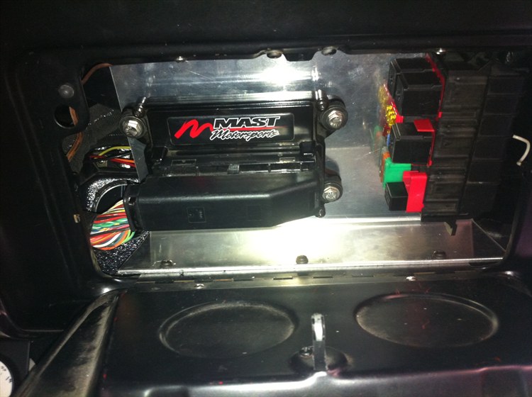

Getting the ECU mounted while still clearing the vintage air unit and allowing all of the ducting to fit was an extremely long process. The setup in the car now looks like a 20 minute install but it took me dozens of mockups and reinstalls to get it all to work. I really wanted to have a glove box but couldn't get this stuff mounted in the car any other way.
Took one of Joe Lutz's (PT.com member) aluminum mounting parts which I knew when I bought it that it wouldn't work out of the box with vintage air. Trimmed 2.25" off the left side which allowed it to clear my center vent as well as made room for the ducting.
Mounting part after cutting 2.25" off:
After another 10 hours of trial and error fitting everything. This was like a jigsaw puzzle for me. Even after a bunch of mock ups I originally had the ECU about 1.5" higher and the fuse/relay box mounted laterally with the fuses pointed straight out. Everything fit and then I tried closing the glove box. Anyhow enough moaning about this simple part taking me forever.

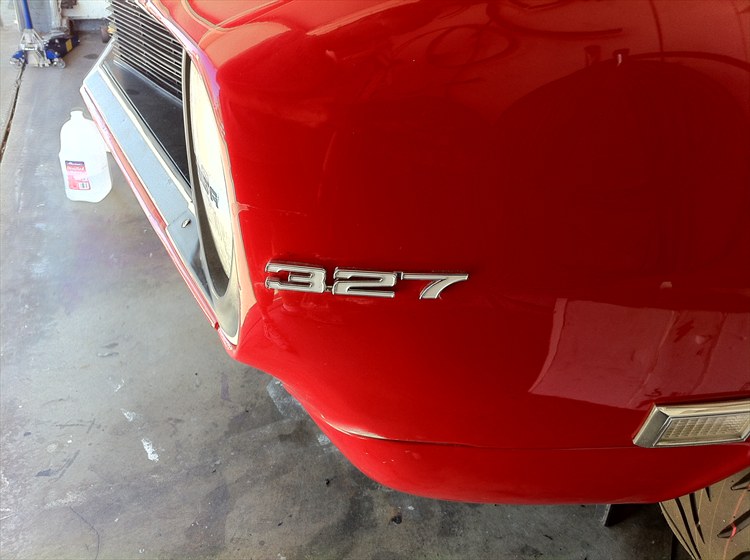

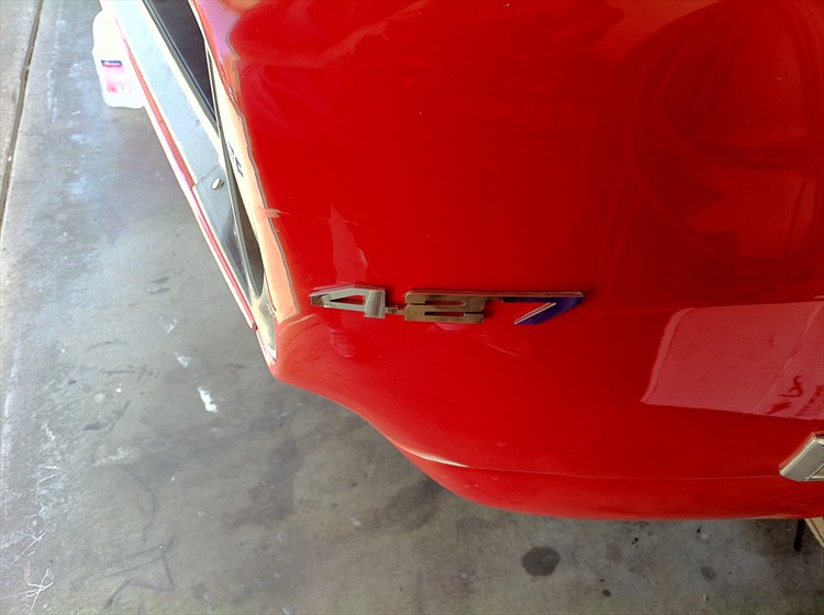

I decided it was probably time to update my CID badges...

Love the new 4 on your fender badge.
