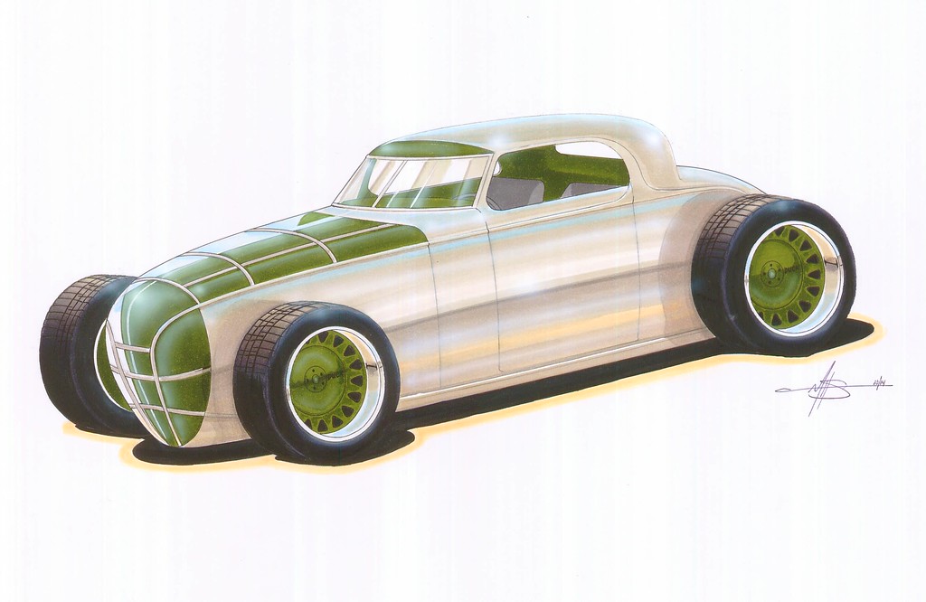

In 2008, the longtime dream to create my own custom car began with the vision that was not only to build a car that was WWII aircraft themed but is actually built like a WWII aircraft. Initial ideas were formed and chassis fabrication began. 50+ hours later, I had my frame started. But as is true for all things worth doing right, time was needed for the vision and design to merge into the picture of what I really want out of this build. Seven years later, I am finally in a place where I can make this dream a reality. The designs in my head have never been clearer about what I want to assemble and based on sketches I had done, my friend and co-worker Matt Sutton of Sutton Designs rendered the “Ruptured Duck”. It is time for the execution phase to move forward, as I am working to construct a car that will have very unique and never-before-seen styling, mixed with technology and performance to place it in a class of its own.
Imagine what you would get if you combined the famous World War II B-25 Mitchell bomber, the “Ruptured Duck”, with the performance and technology of a modern sports car. Then stir that in with some vintage 30’s style. With this in mind, I present to you the “Ruptured Duck.”
This 100% hand-built aluminum body will incorporate the design and styling of the B-25 Mitchell bomber glass nose and windshield, with the three window 30s coupe rear roof and truck shapes. The car will feature a full belly pan and B-25 bomber inspired wheels.
The history behind the build adds depth and detail to the design, giving the car a story that takes you back to the early 1940s.

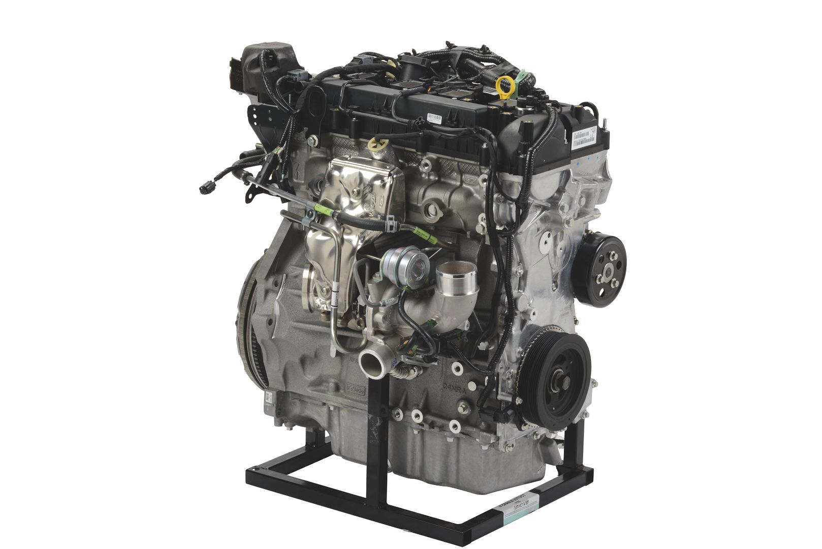

The drivetrain of choice for the Duck was chosen with a few things in mind. I wanted the car to have a unique engine yet I also wanted it to offer modern performance and reliability. For these reasons, the car will feature the new Ford 2.3L Ecoboost and 6-speed manual transmission. The engine will be a main focal point of the build because it will be 100% visible behind the glass nose of the Duck. The modern design and performance of this engine will take the performance of this lightweight, aluminum car to the next level.

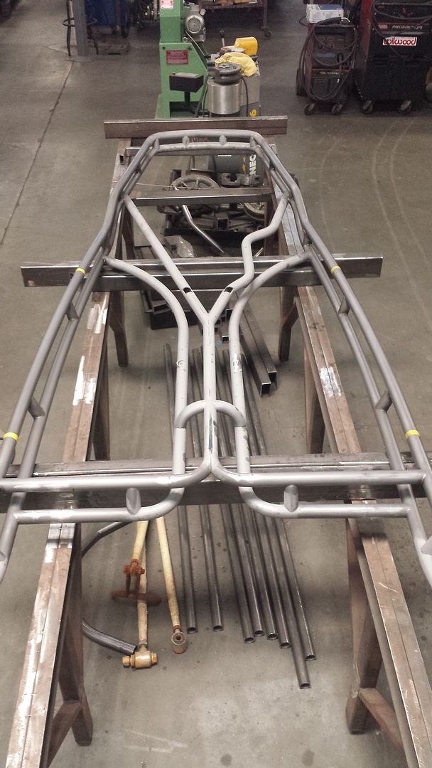

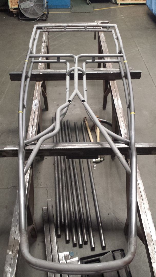

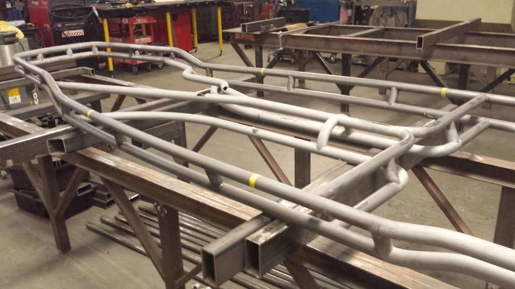

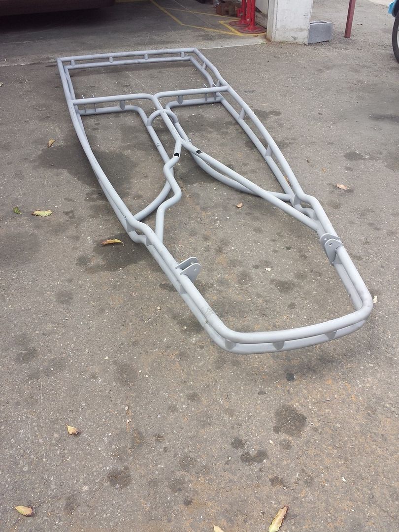

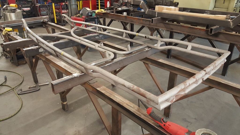

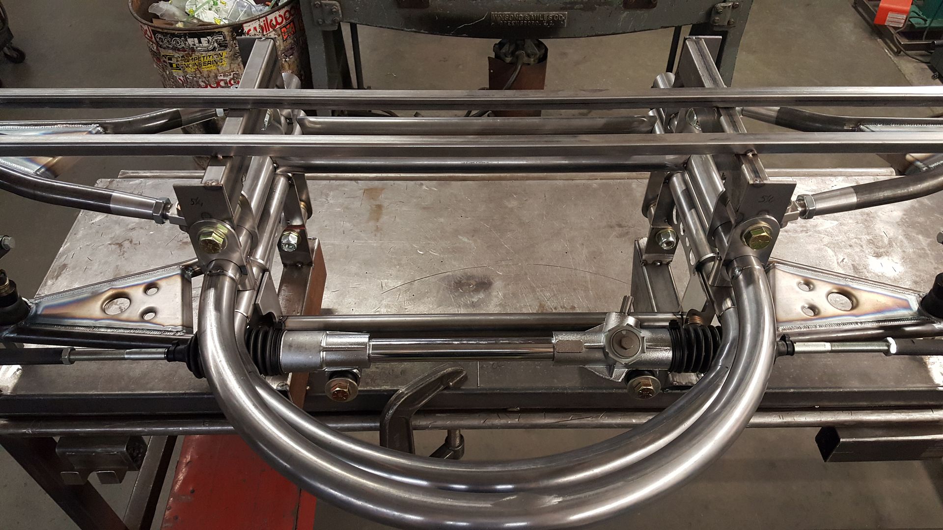

Here is the frame that I assembled years ago. it will look a lot different once the new modifications for the new suspension are done.

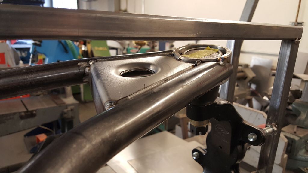

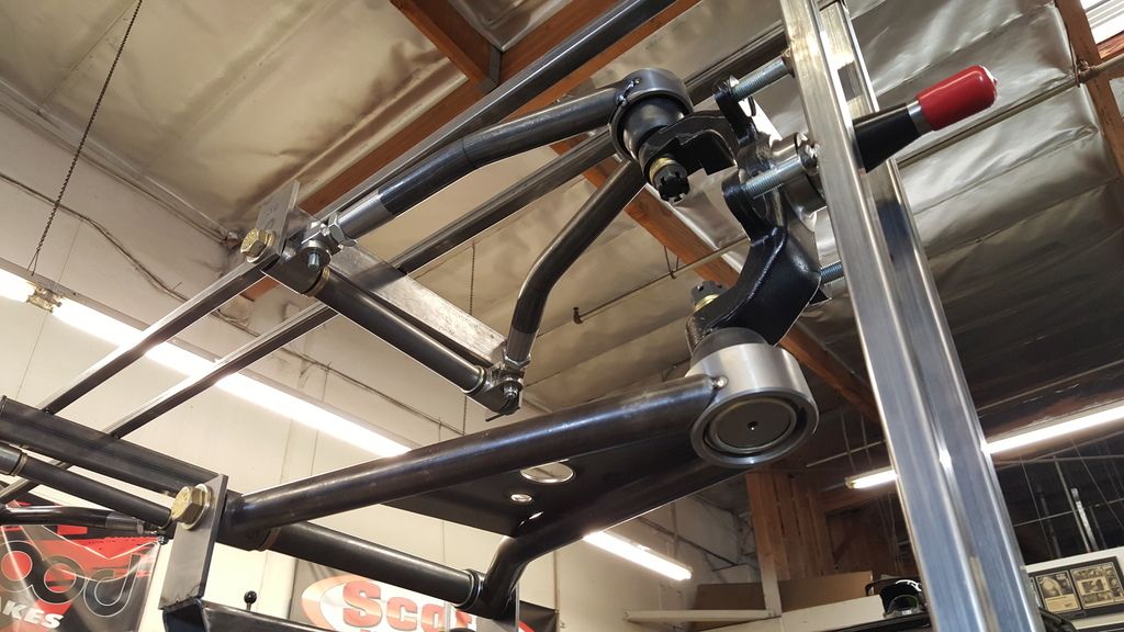

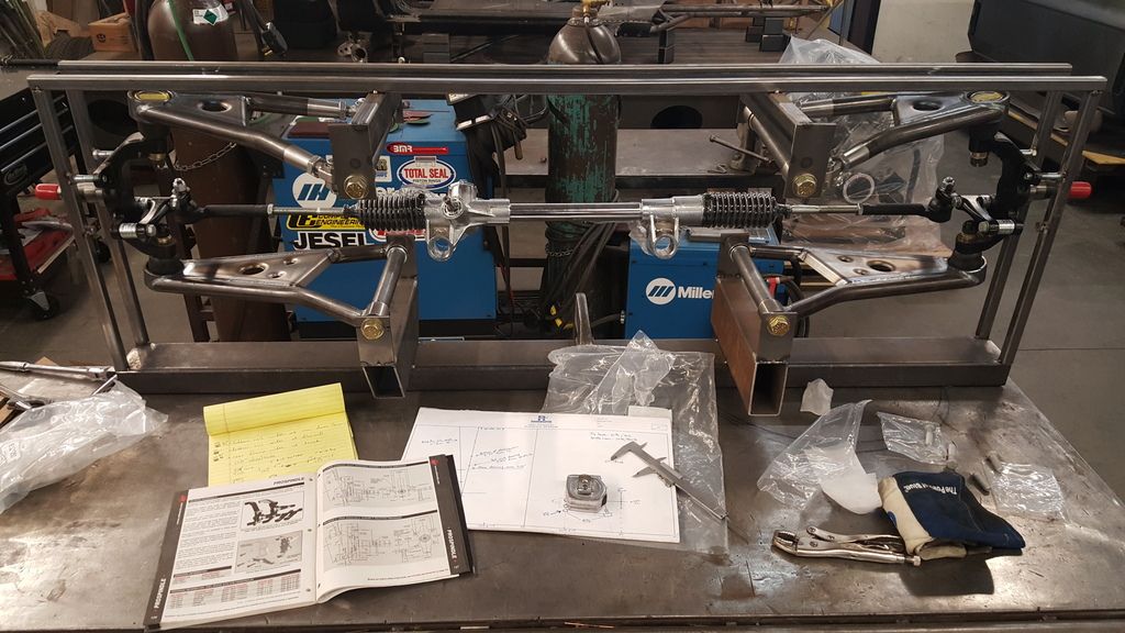

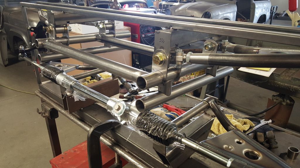

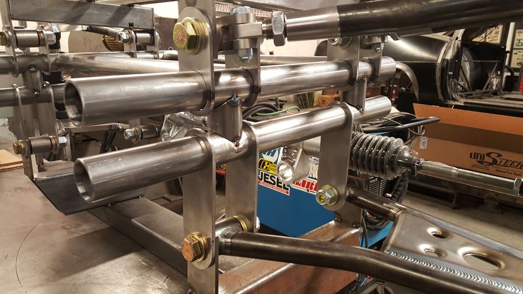

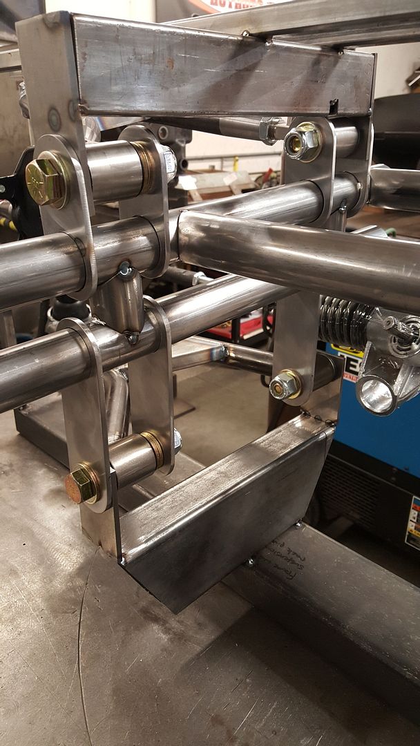

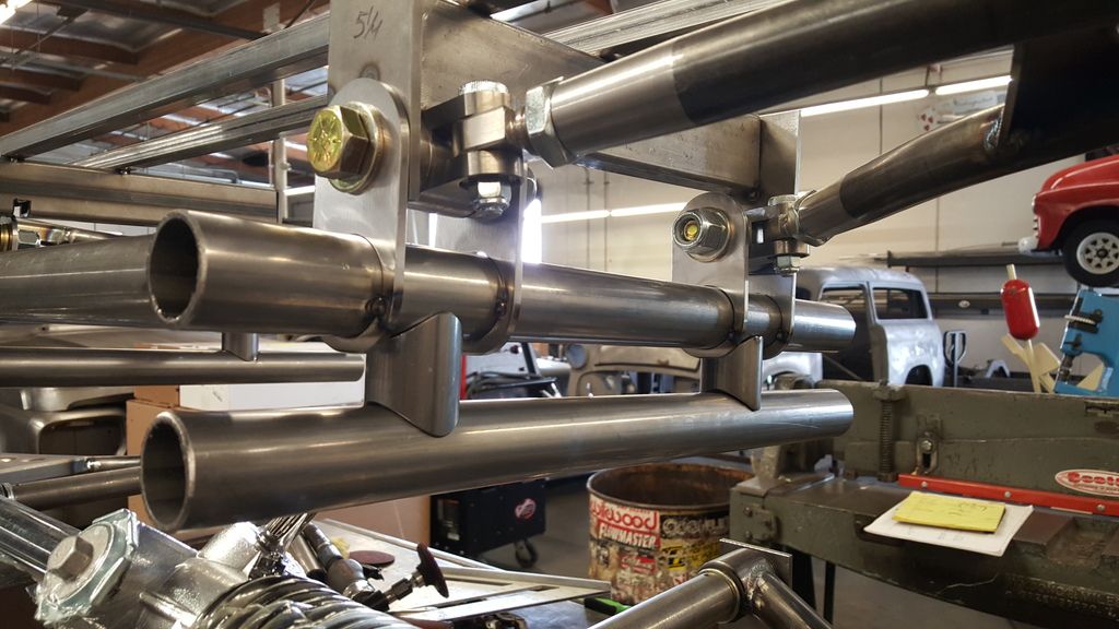

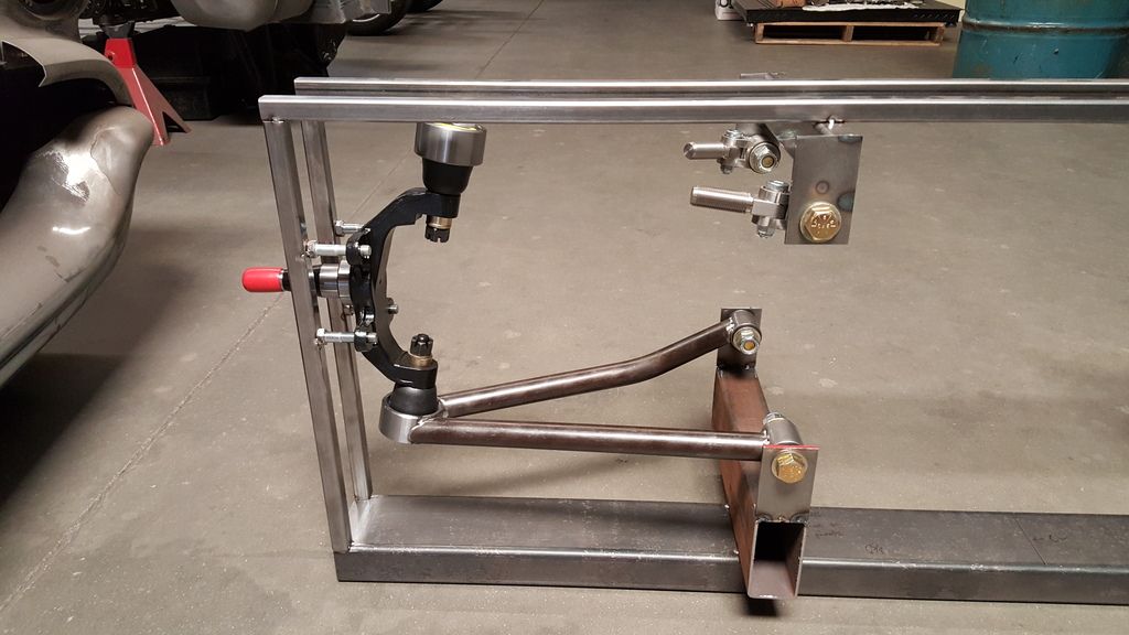

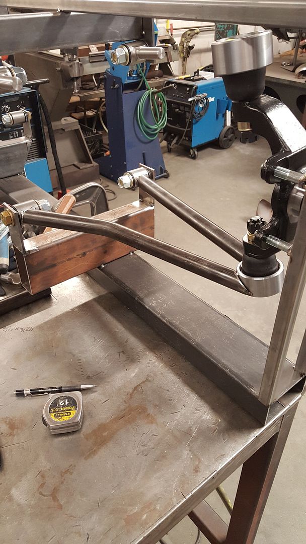

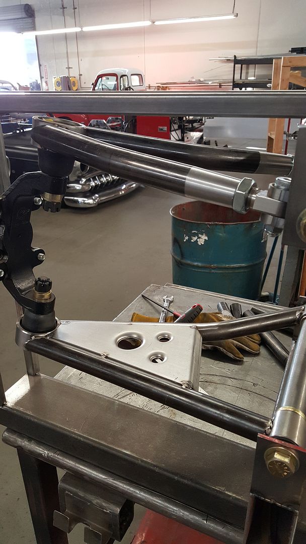

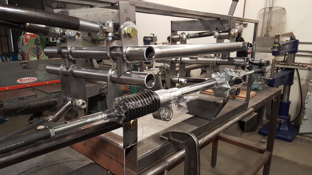

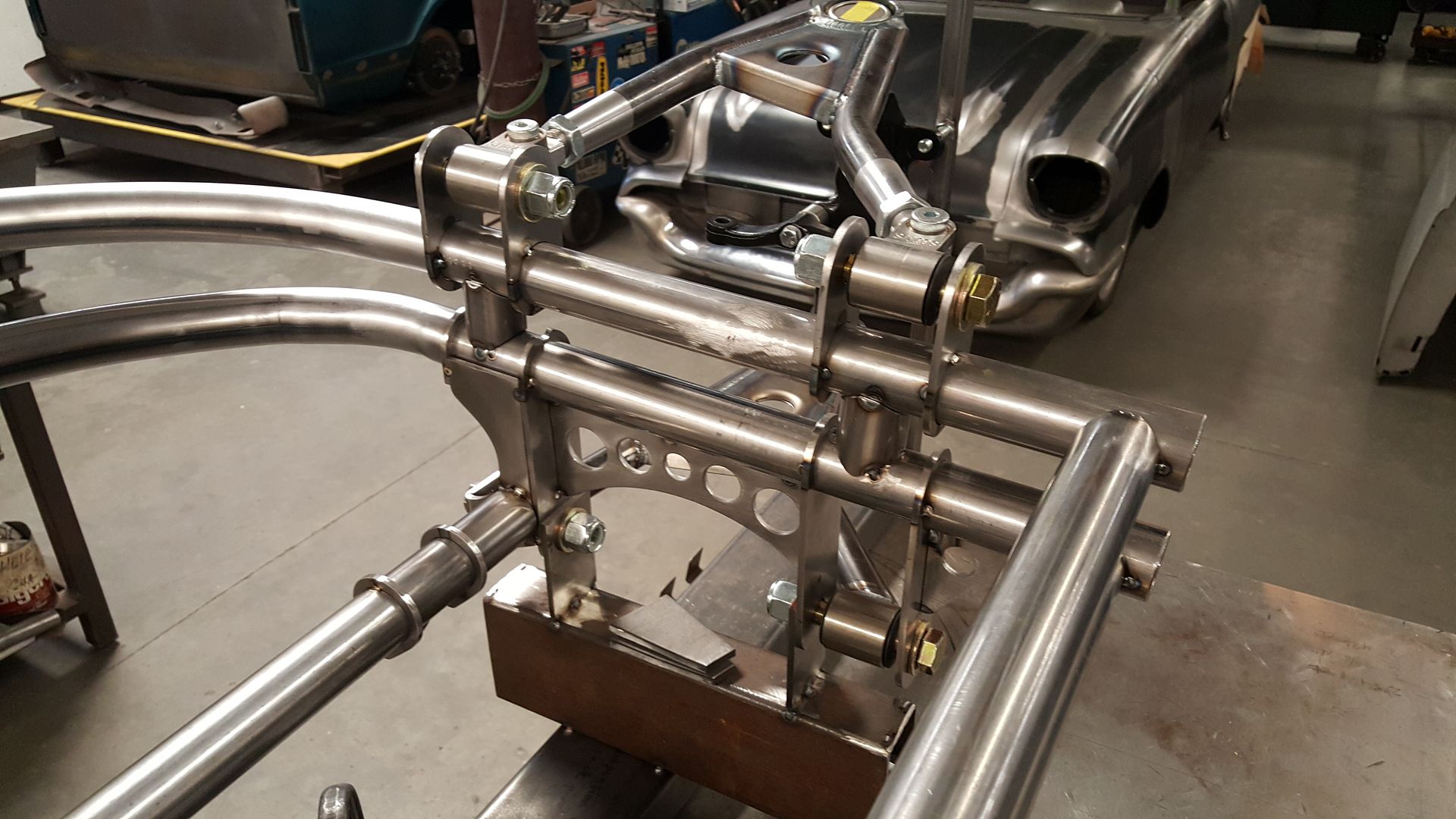

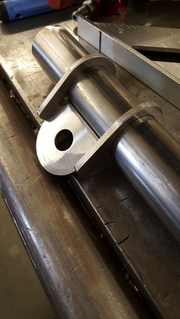

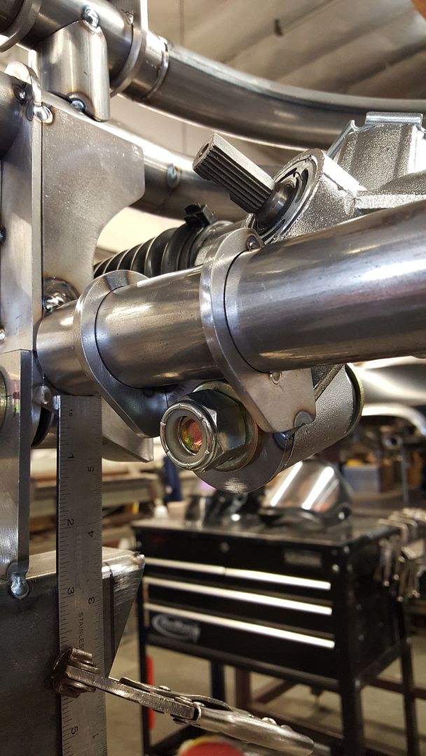

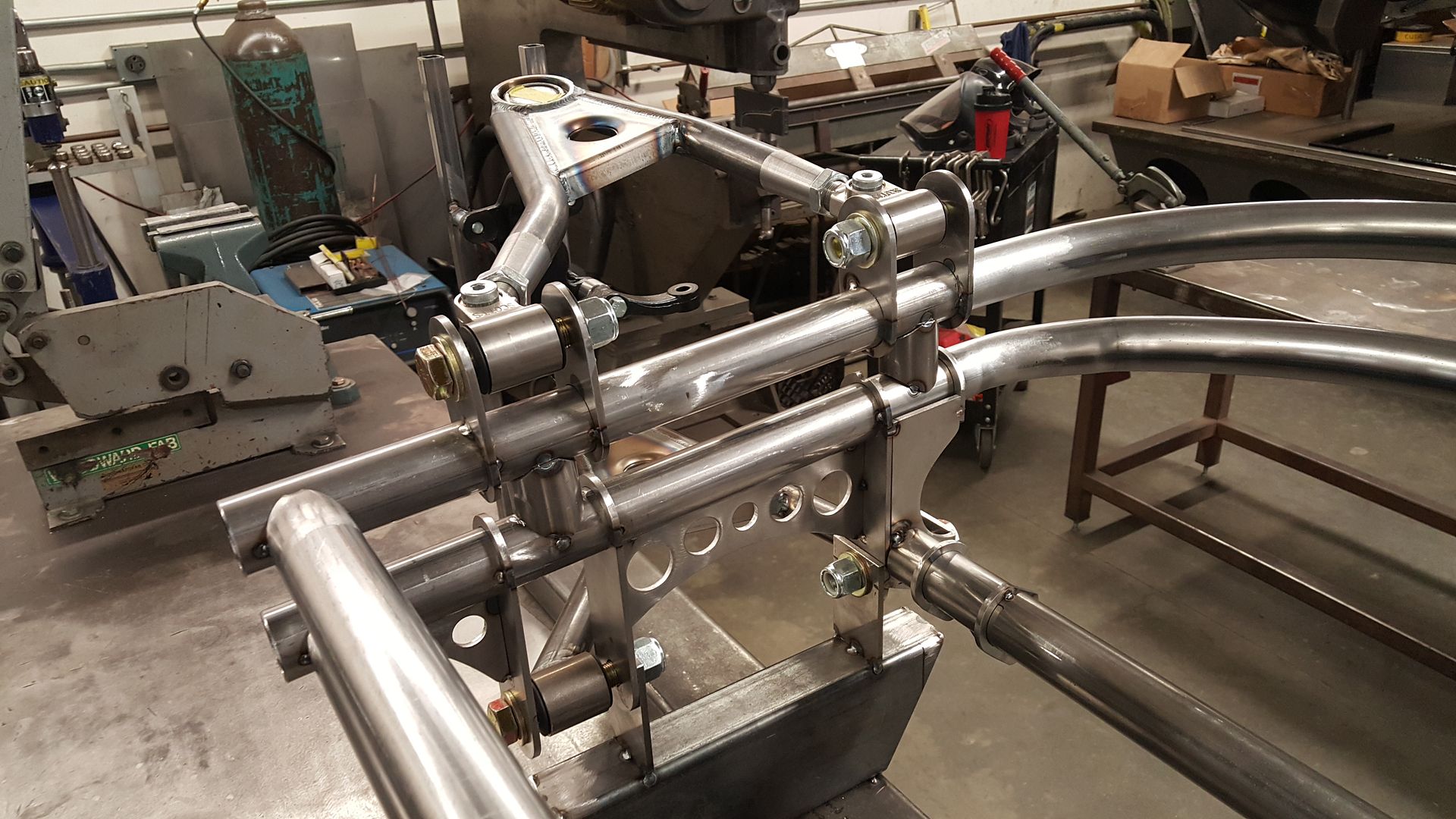

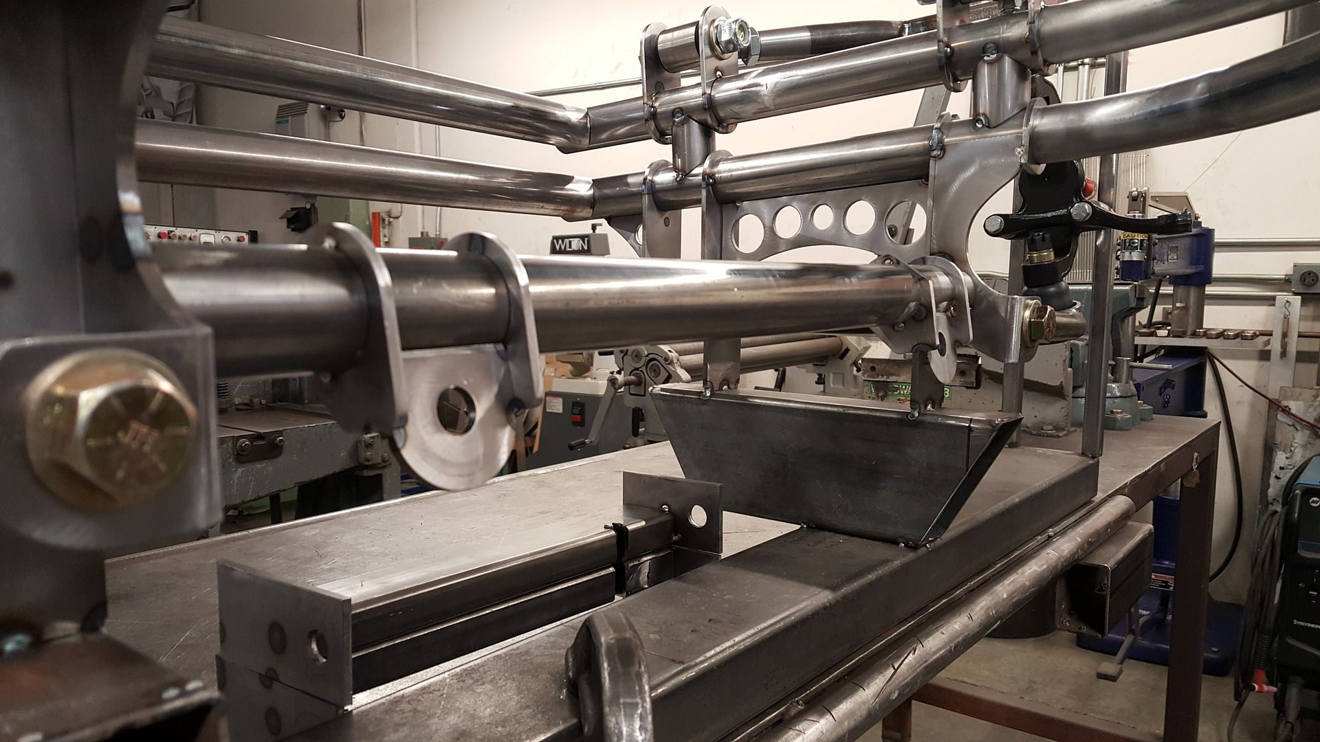

Mock up of the suspension fixture around the exsisting frame

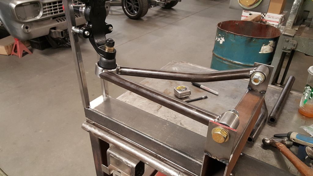

control arm fabrication begins

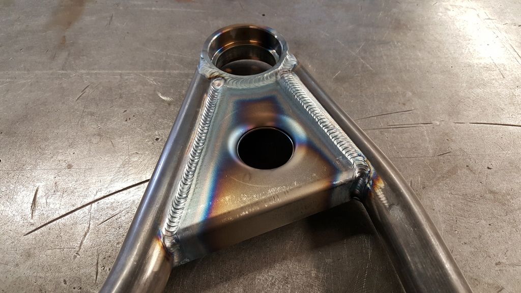

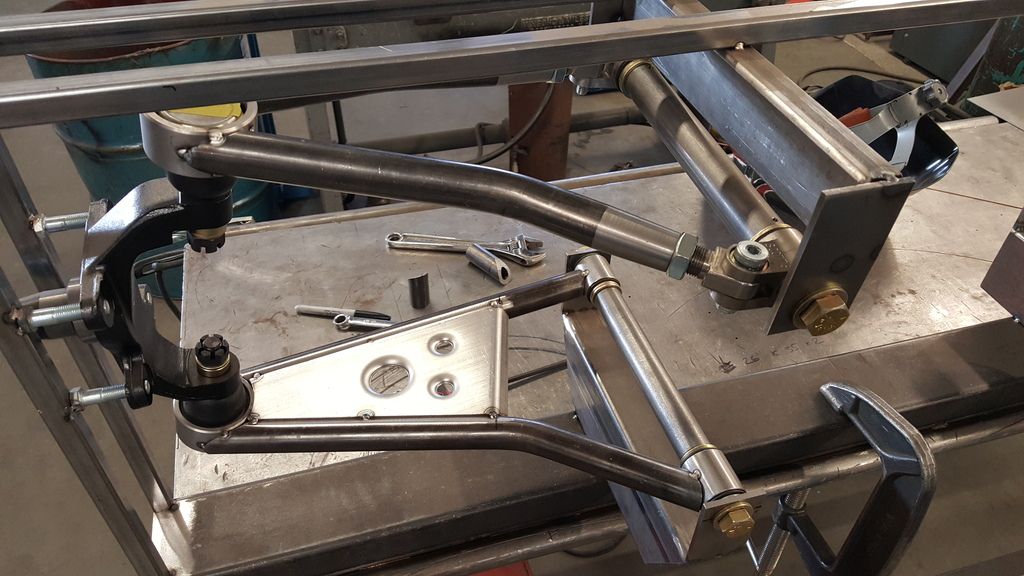

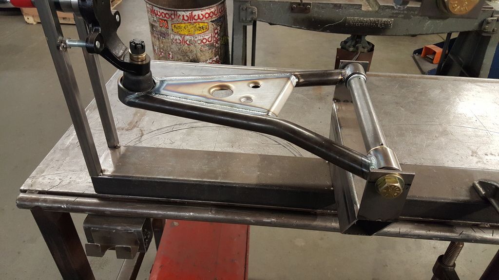

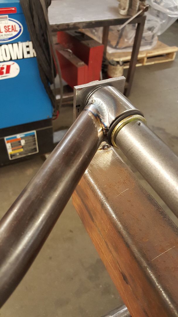

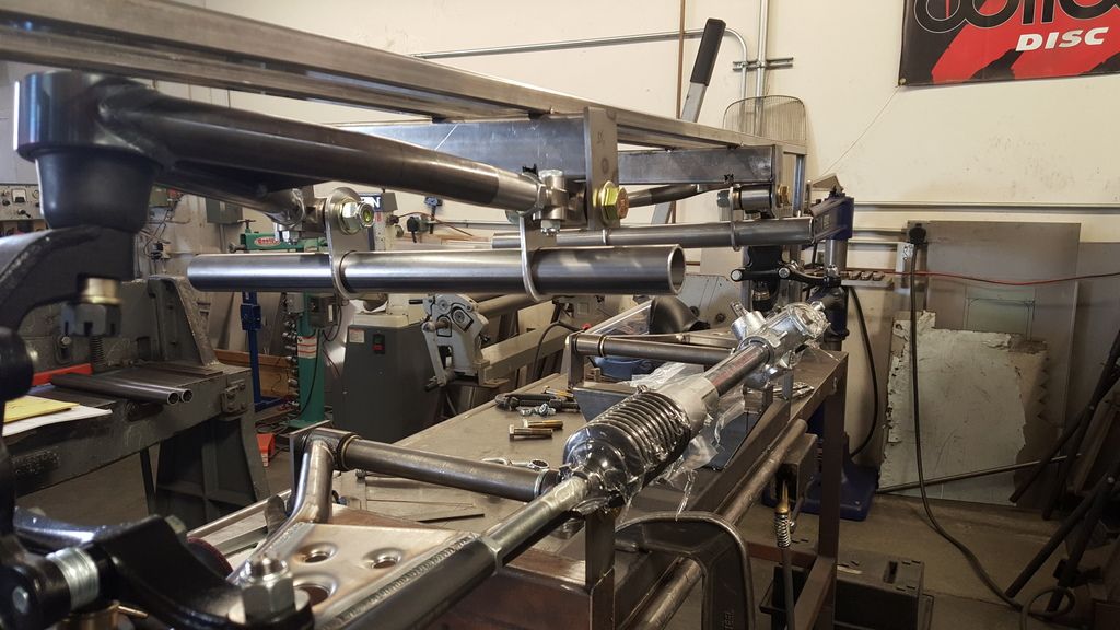

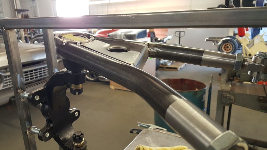

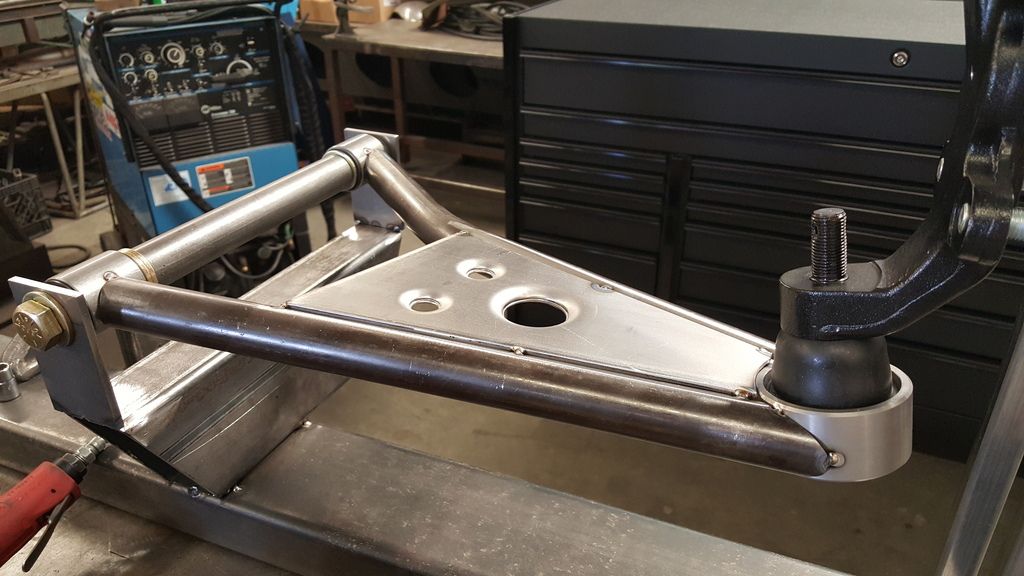

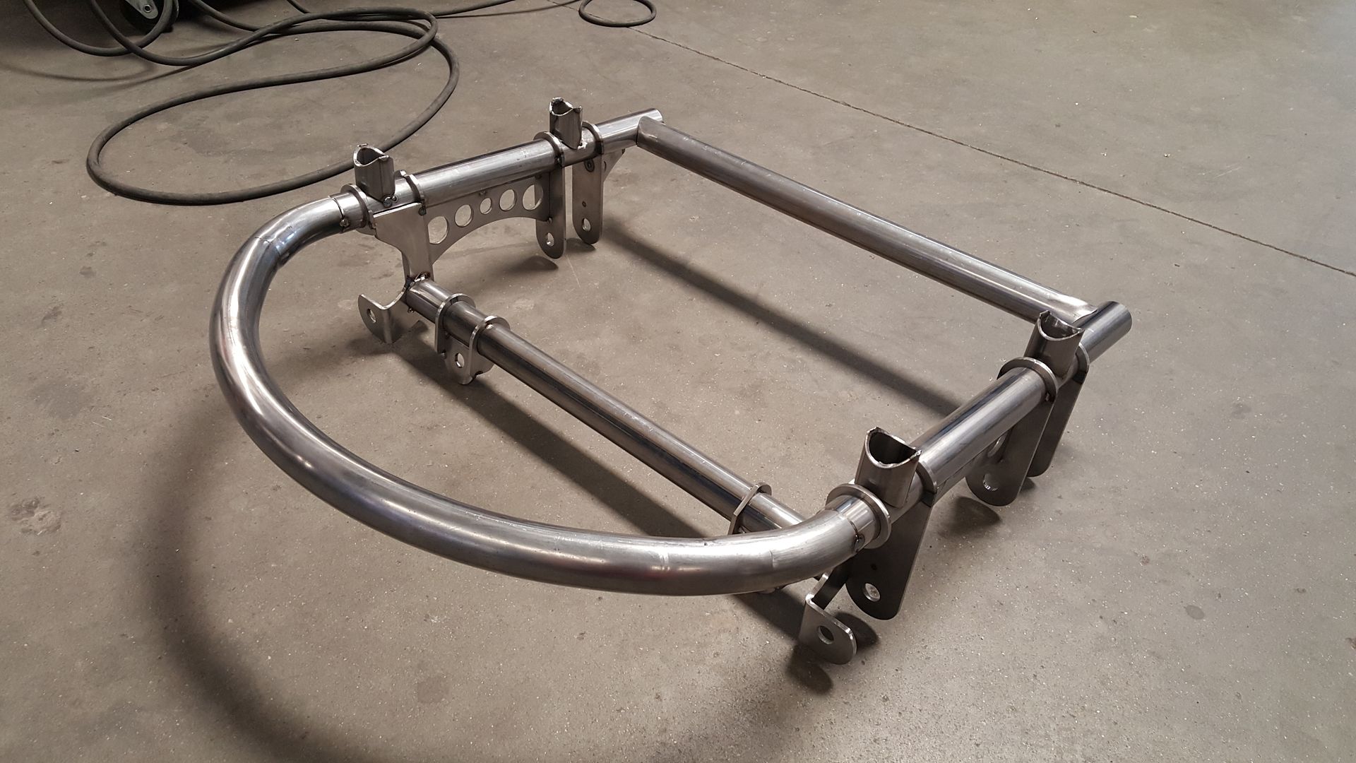

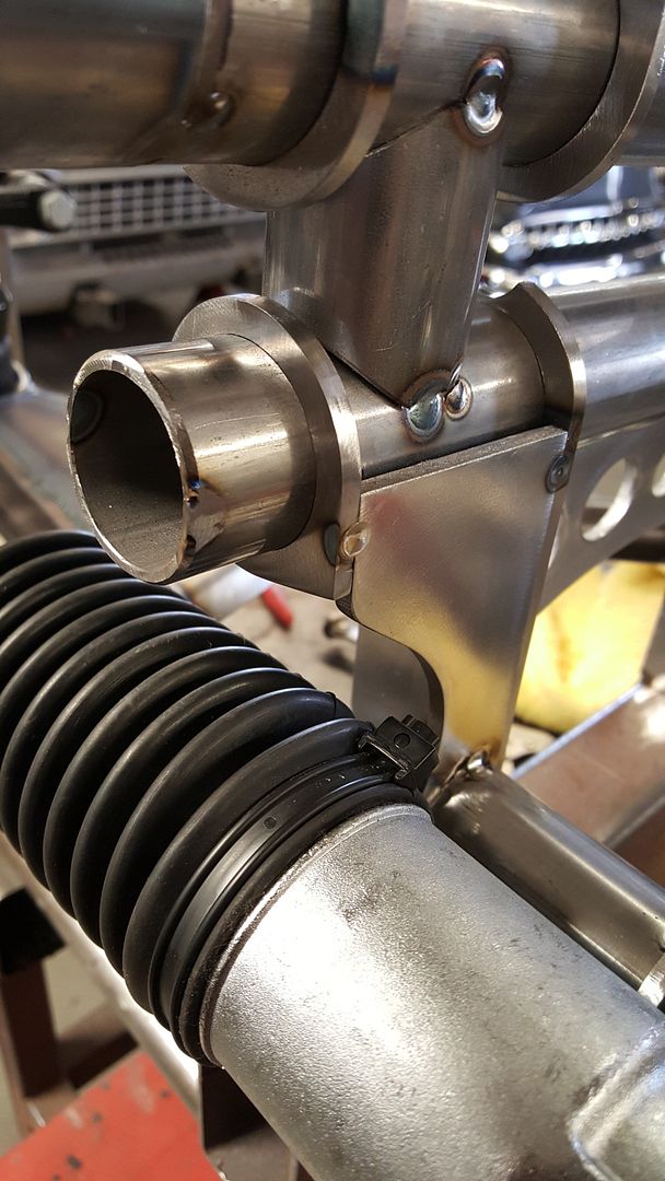

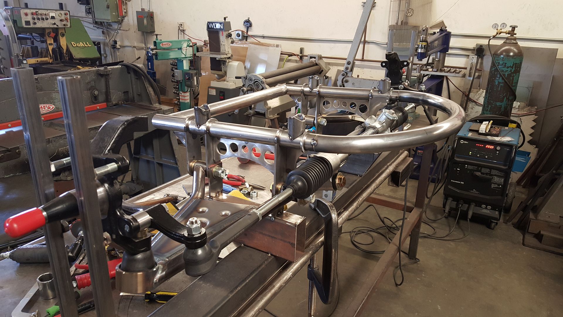

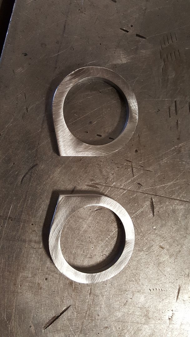

Upper control arm fab

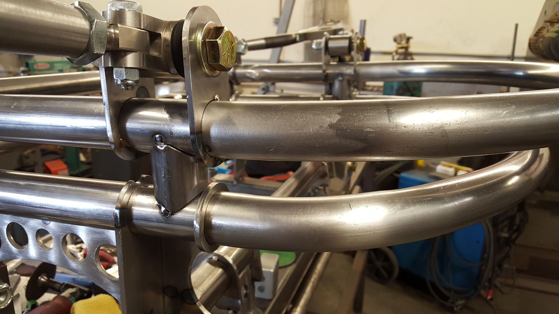

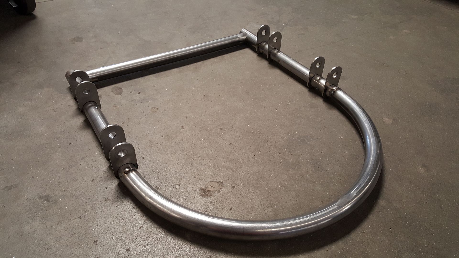

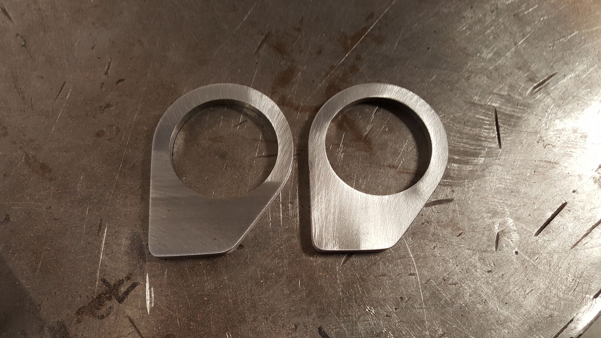

Old 05-17-2015, 04:35 PM
FaBrycation's Avatar
FaBrycation FaBrycation is offline
Join Date: May 2007
Location: Pella, Iowa
Posts: 665
Thanks: 91
Thanked 93 Times in 35 Posts

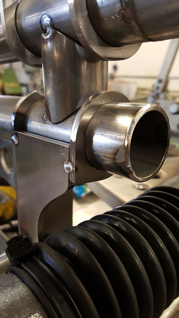

Brycen Smith- Owner, Builder @ PRD Design LLC

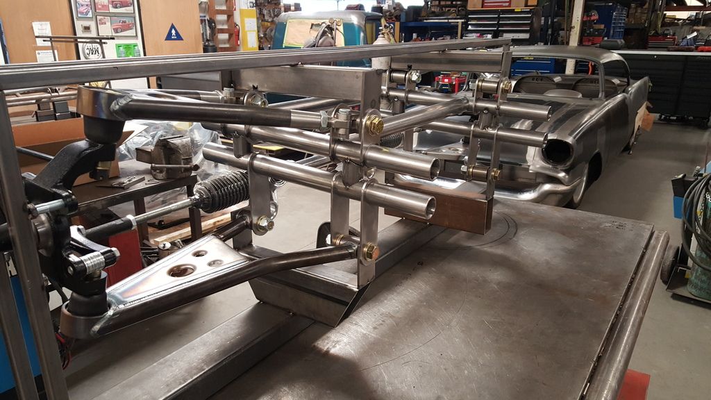

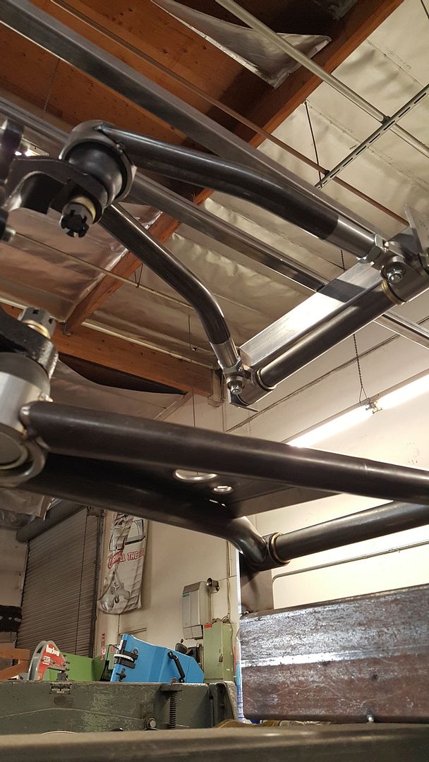

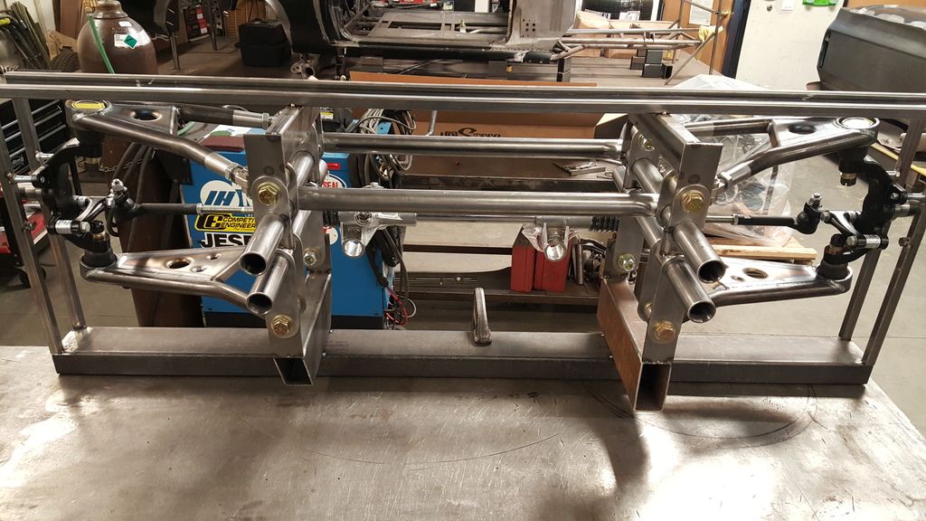

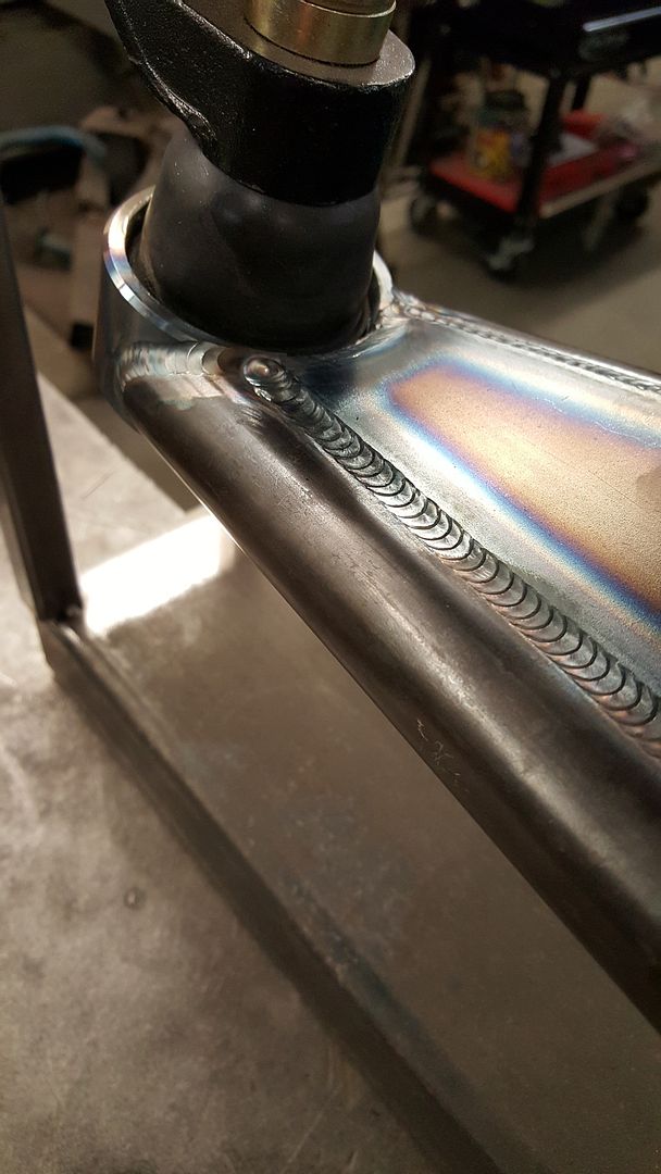

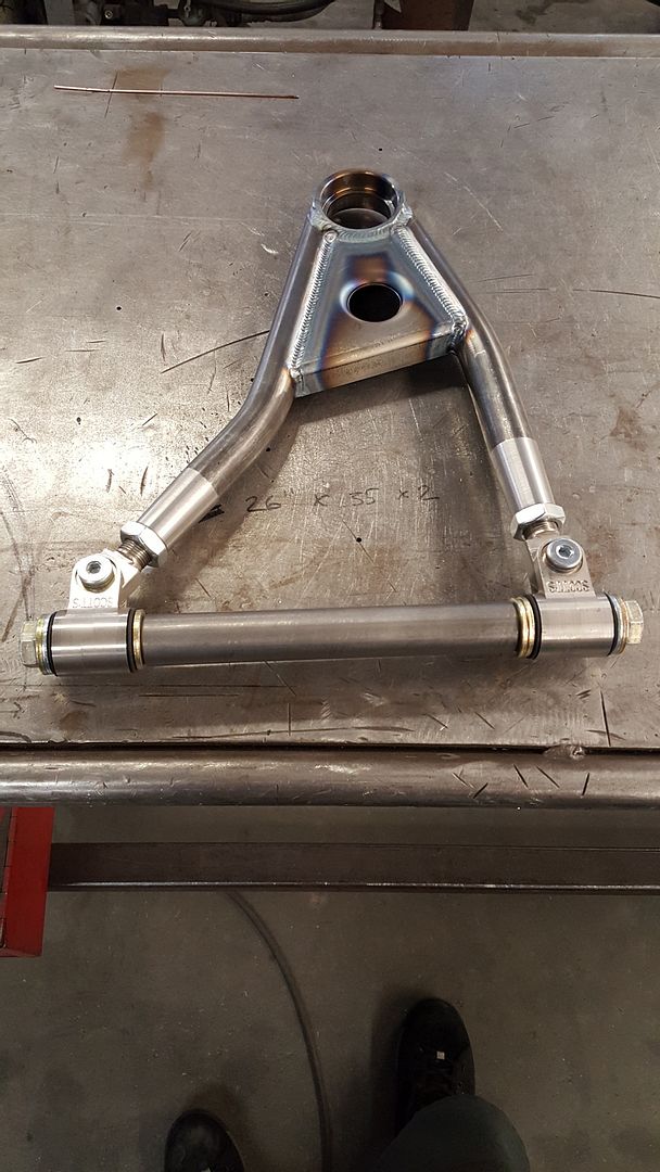

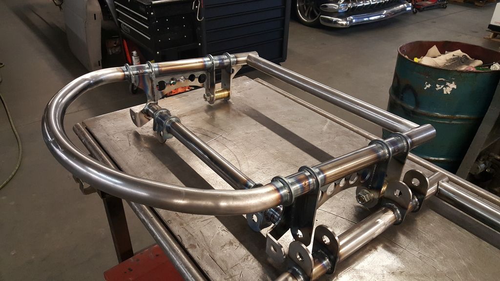

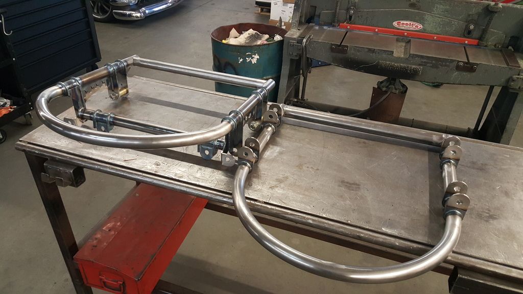

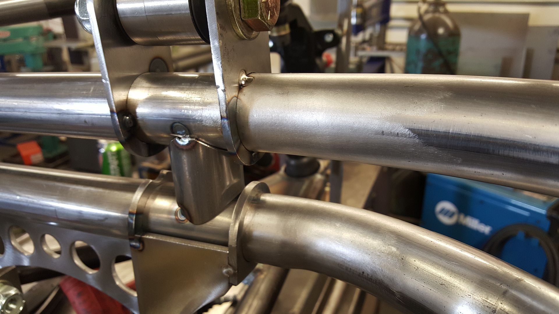

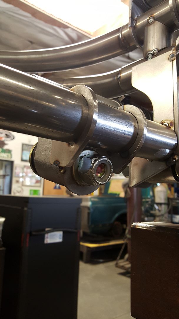

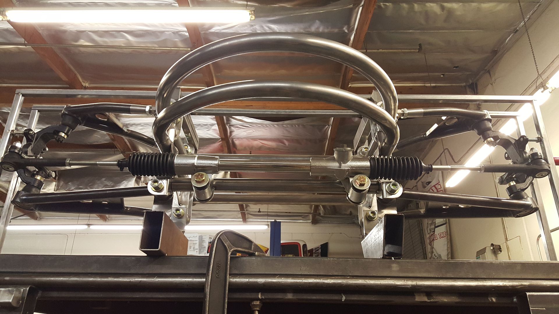

control arms welded out.

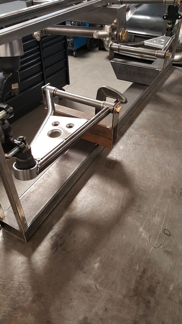

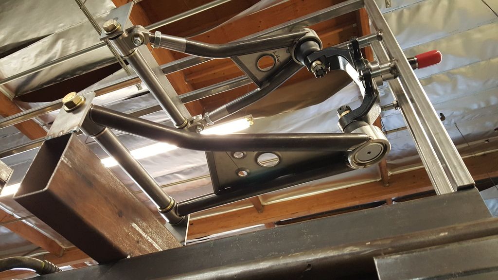

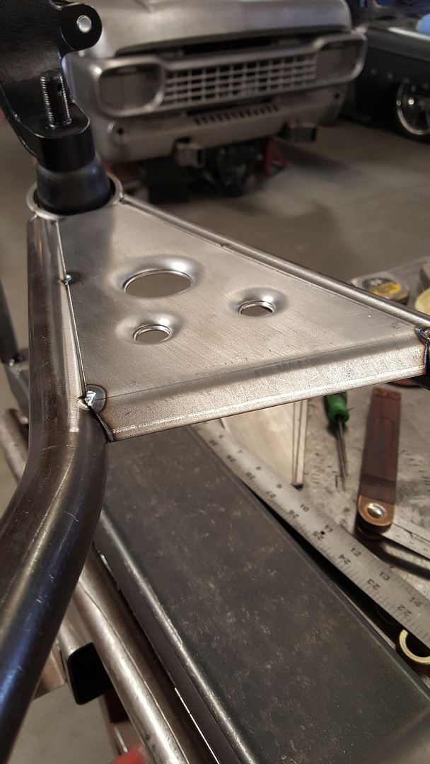

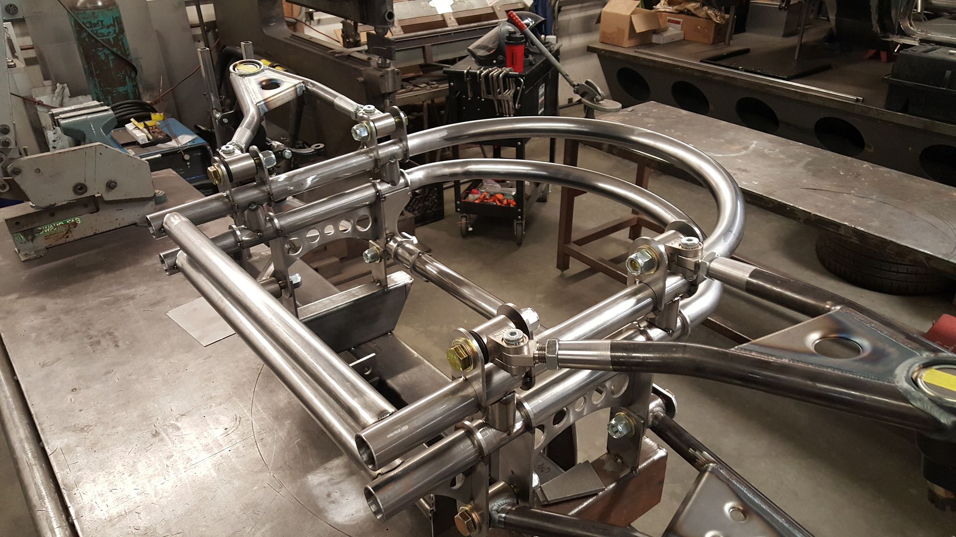

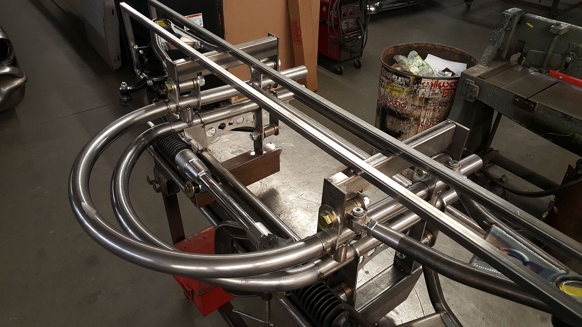

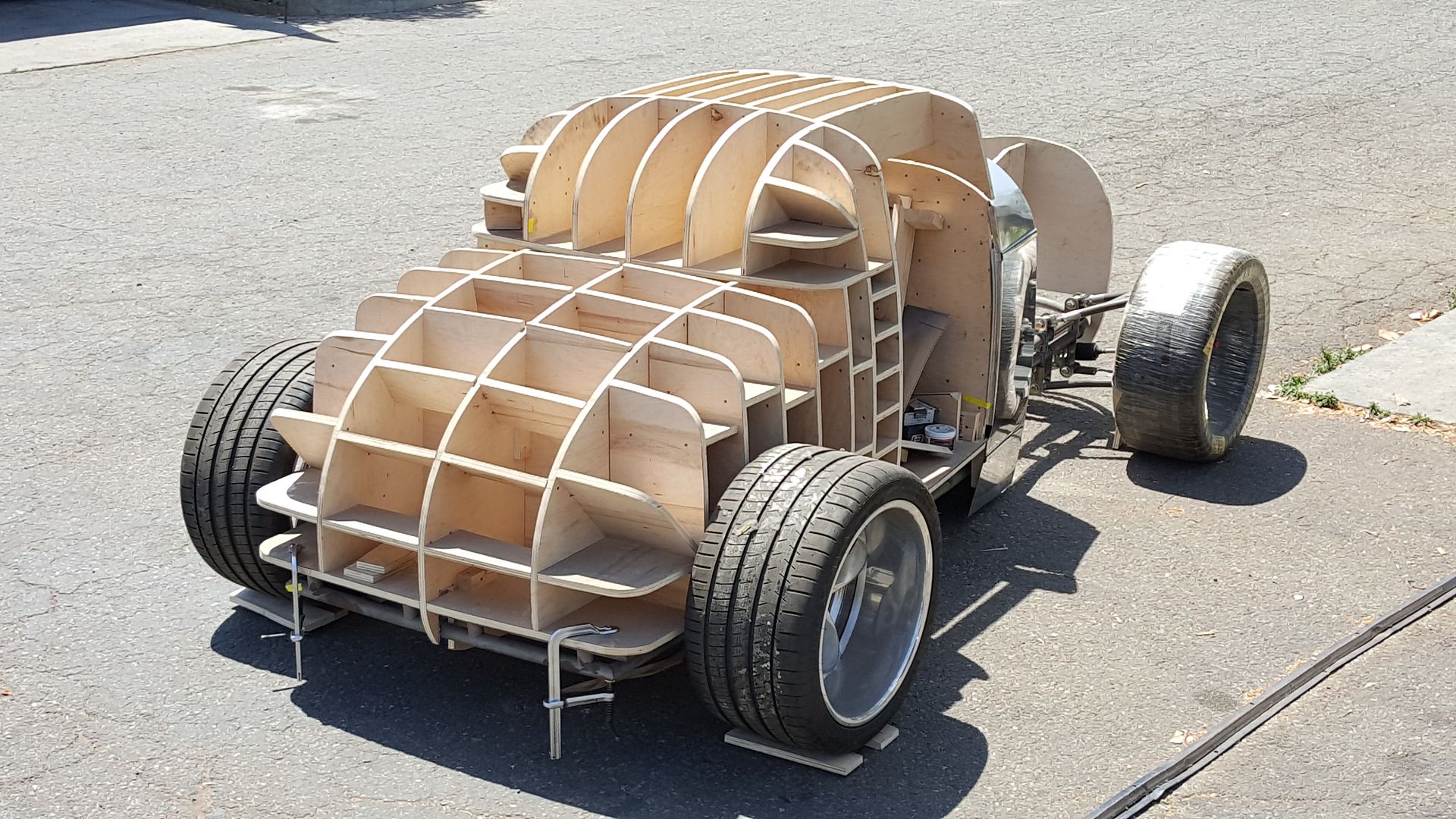

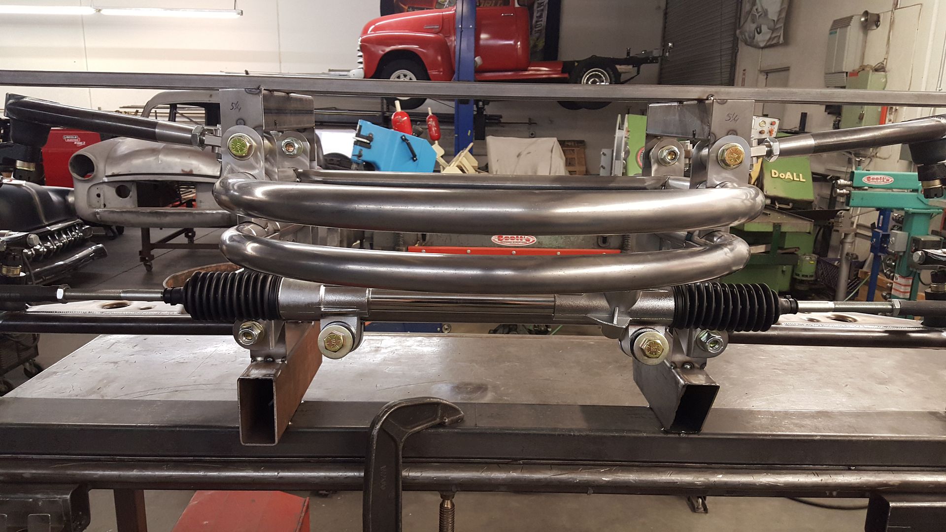

Here is some updates for everyone.
I welded out the new front clip, set the chassis on the table at ride height and proceeded to cut the the old center section out and narrowed the rails 4 inches. This was another design change that was decided when I switched the suspension plan to IFS.
