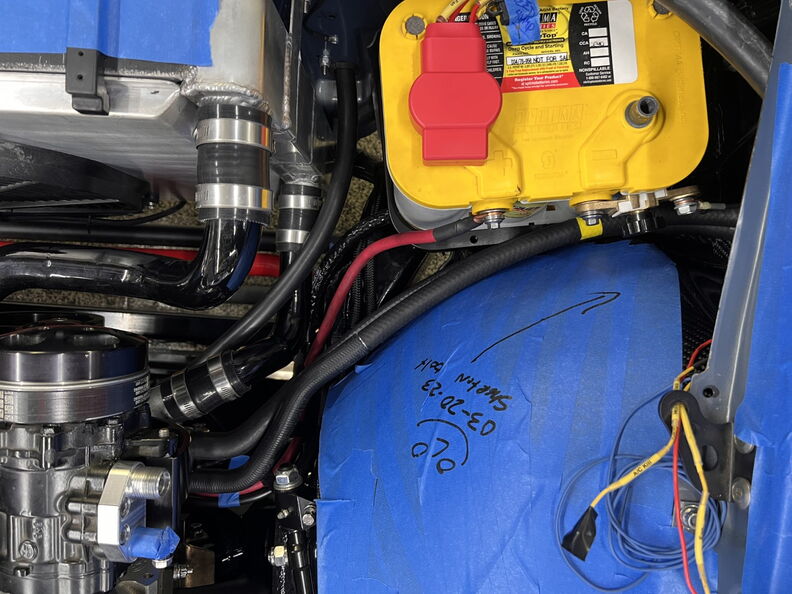

Default Vintage Air Hose Final 03-20-23

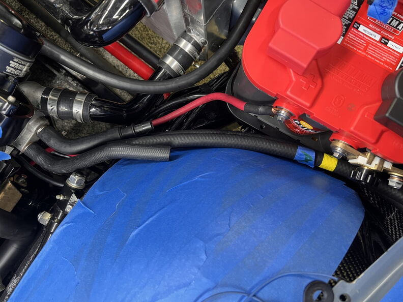

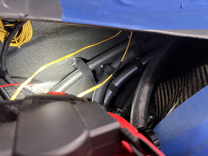

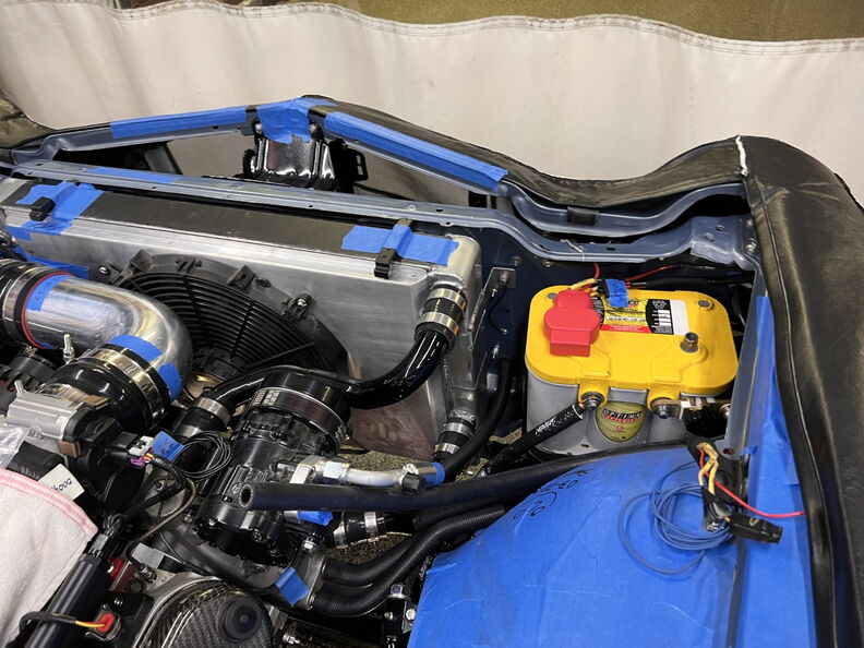

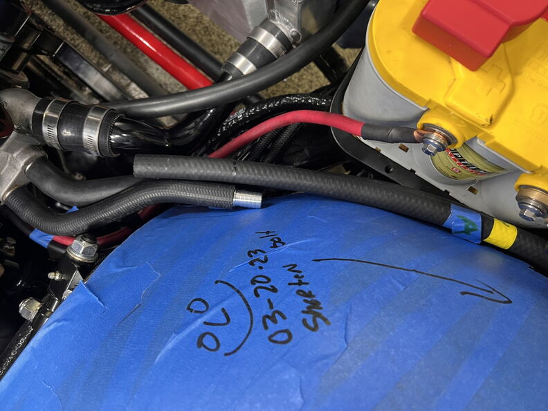

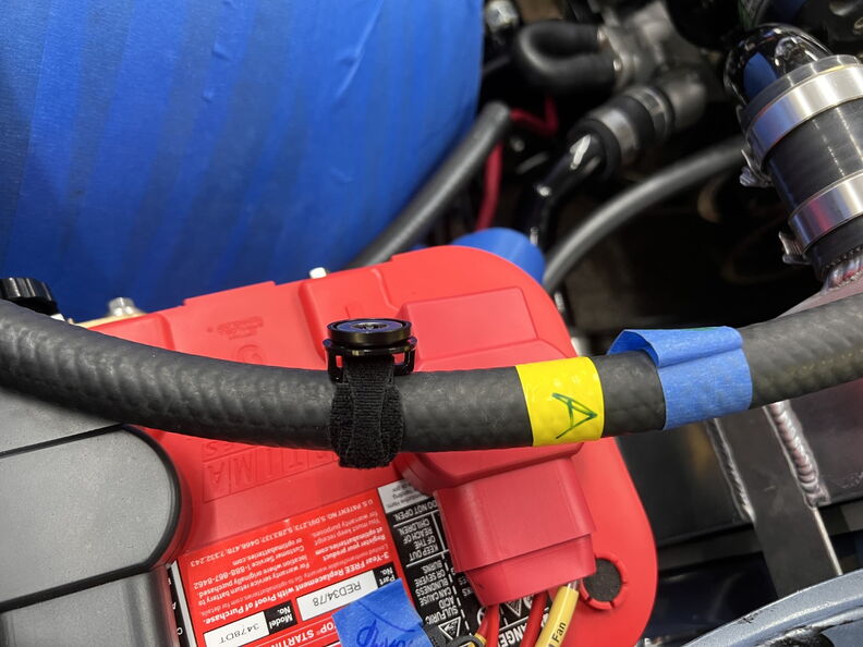

I am finally finishing up the Vintage Air hose routing.

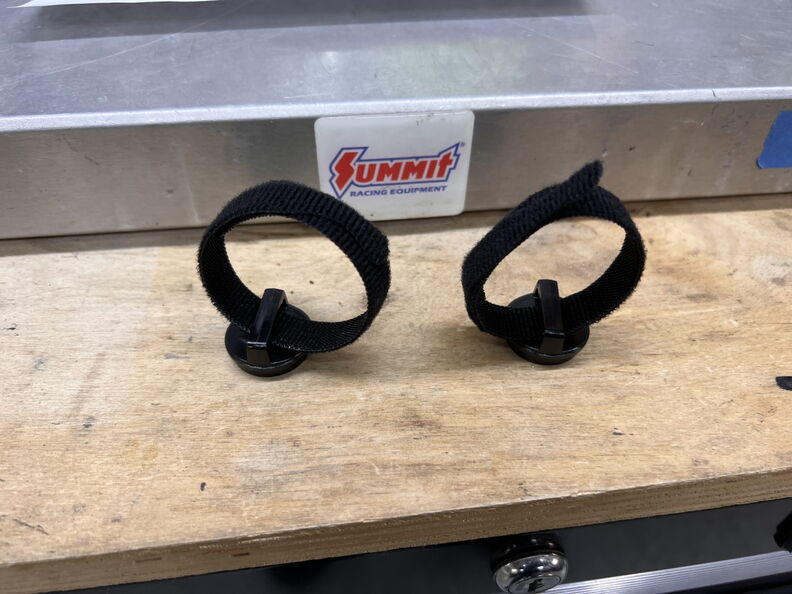

More Mag Daddy mounts with Velcro straps
I need to make the final cut and yep I am chiken chit !!

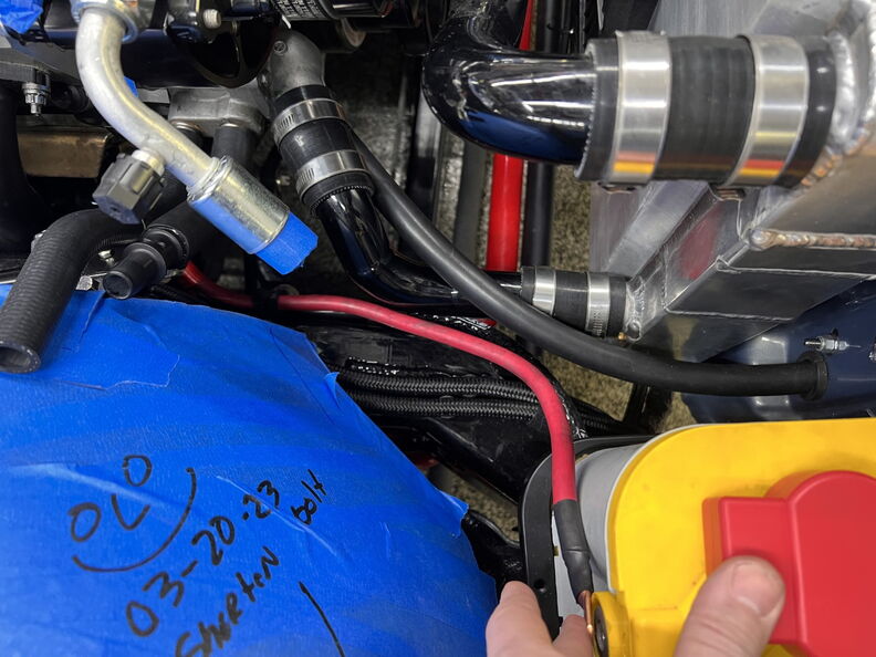

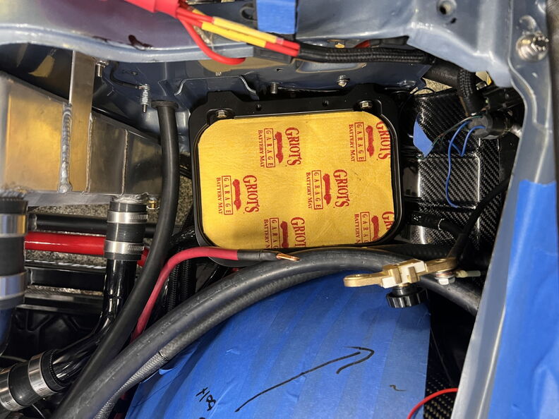

Routing the battery wire for the last time I hope
Remy Picture for Skip
more to follow
marty-mj

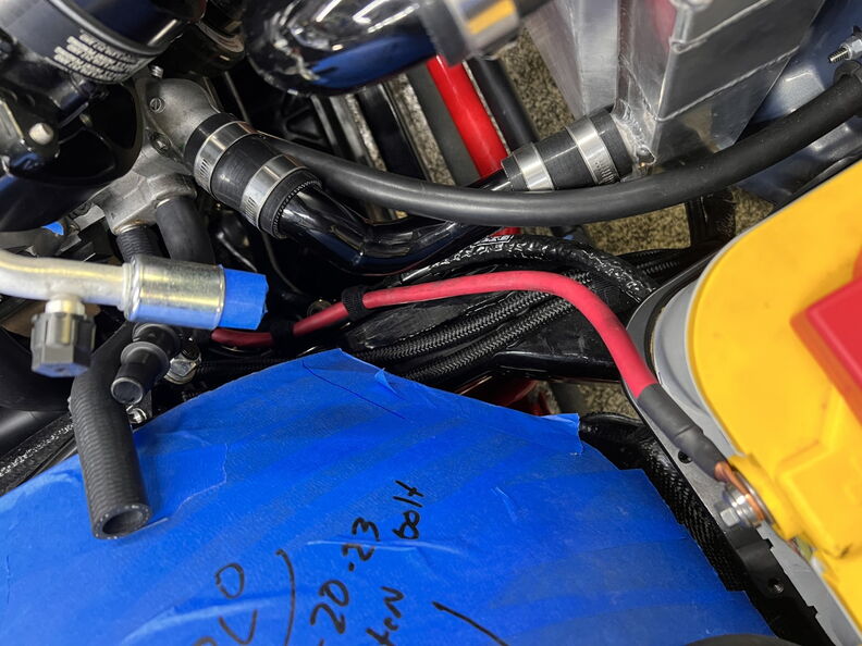

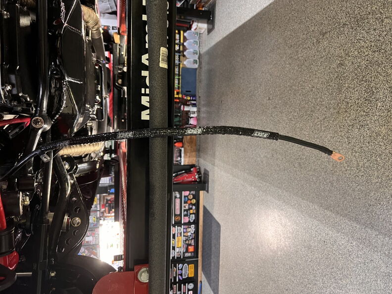

Default Battery Hot Protection (( 03-21-23 ))

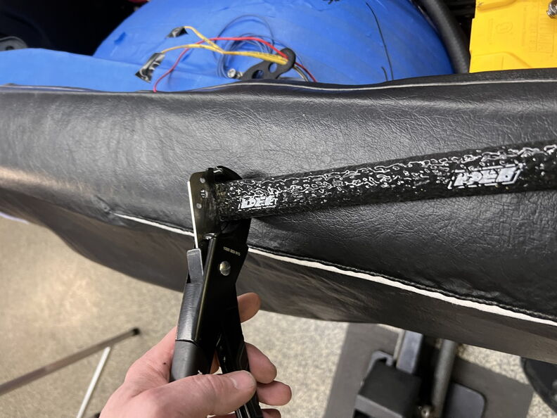

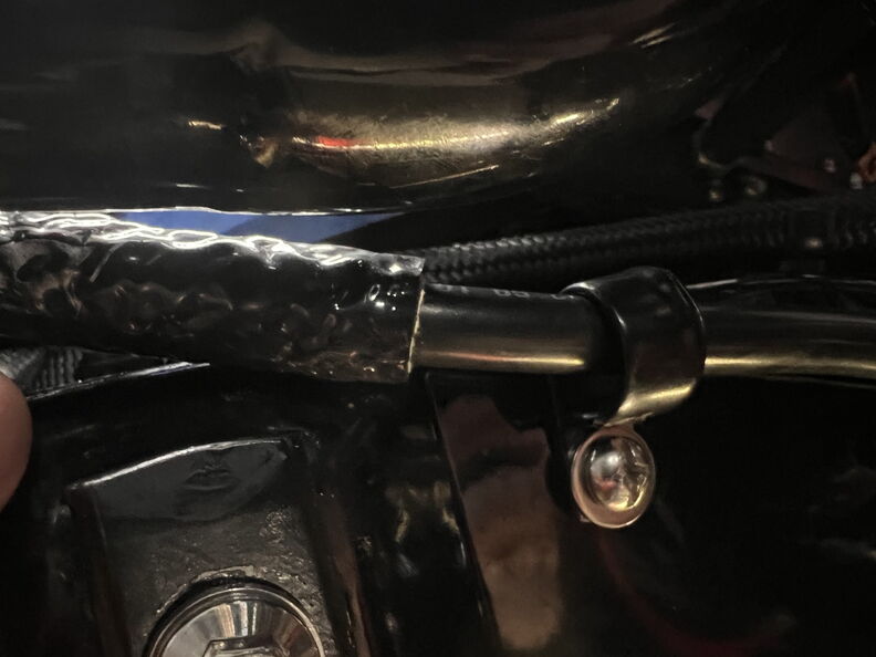

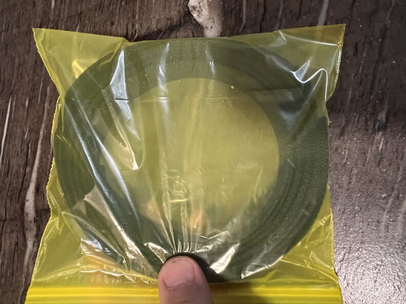

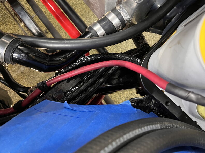

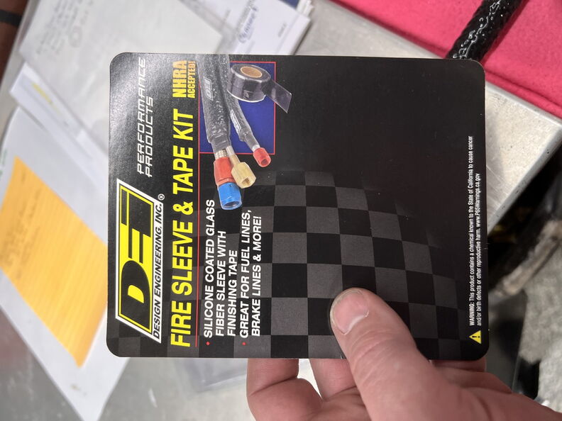

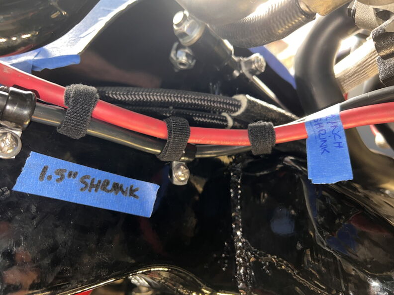

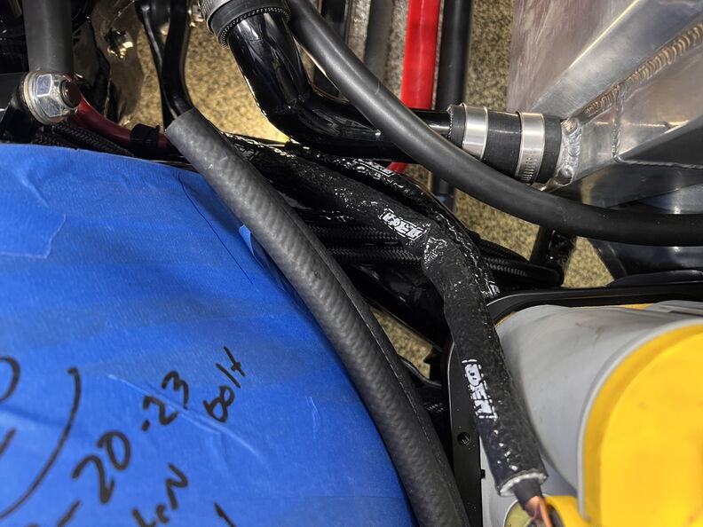

Due to the location of the Battery Hot Wire I am going wrap a small area of the wire in DEI Heat Wrap and will
then add a thin abrasion wrap to protect the wire and make it black so it disappears in the engine bay.
I am going to shorten the DEI Heat wrap and install the abrasion wrap once it gets past the lower radiator hose.
The cool part is it is also Heat Shrinks
marty-mj

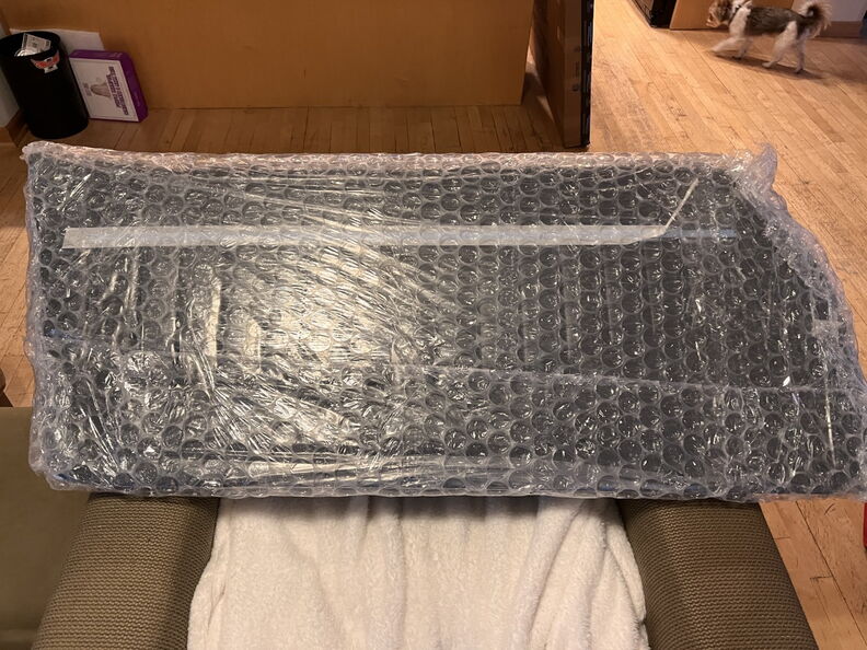

Default The Big Brown Truck (( 03-23-23 ))
The Big Brown Truck made a visit to my house and dropped off these very nice door panels
Now they are safely stored in my attic office

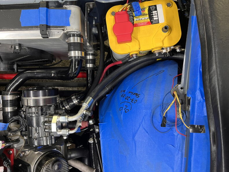

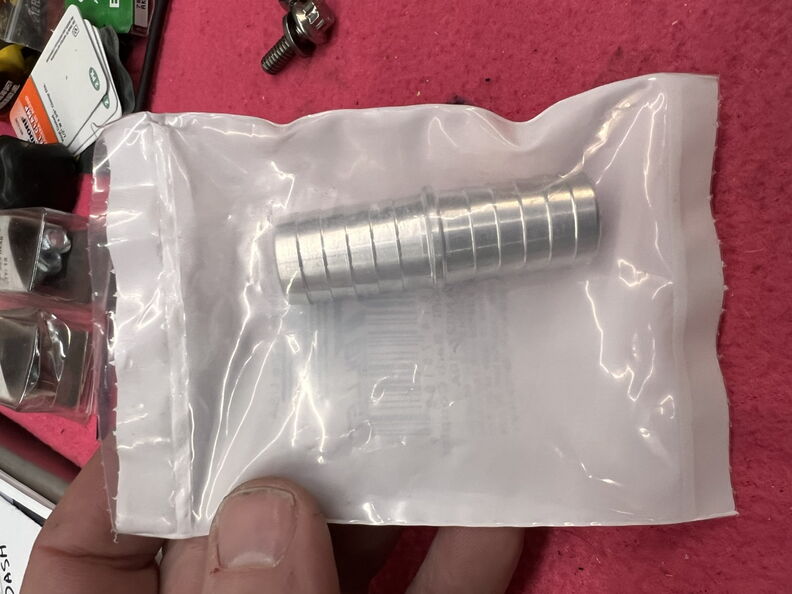

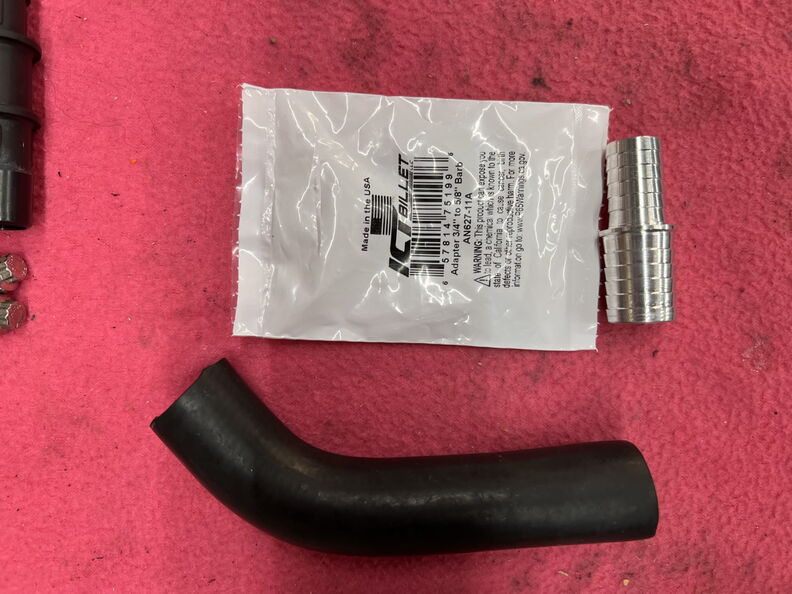

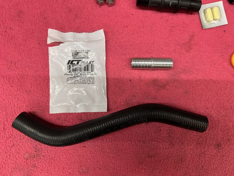

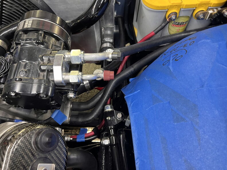

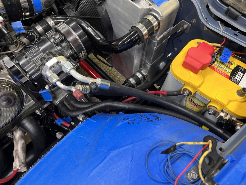

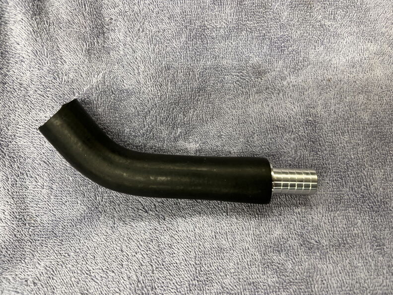

Default Battery Hot & Vintage Air Heater Core Hose Final Connection (( 03-25-23 ))

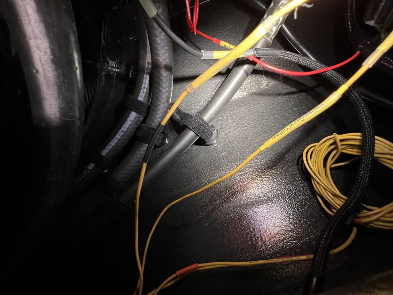

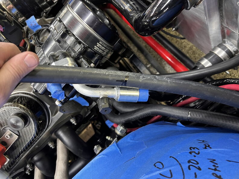

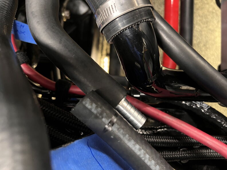

Today I will be working on the Battery Hot and the Vintage Air Heater Hose with the ICT Billet Hose Connectors.
I mocked up the wire routing using Velcro straps which will eventually be replaced with Heat Shrink Tubing.
One down One to go
Now the fun and scarry stuff. One wrong cut and I am screwed.
Please be right... Please be right
The fun looking one
If I screw this up I have to remove the inner fender to replace the hose.
For reference
This is going to be fun.
AC Line Cut !!
marty-mj

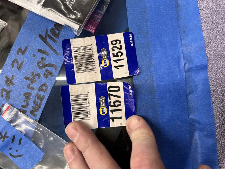

I really appreciate all of the pics w/ part numbers and product tags. This will help others !

Thank you for the detailed post and including the part numbers

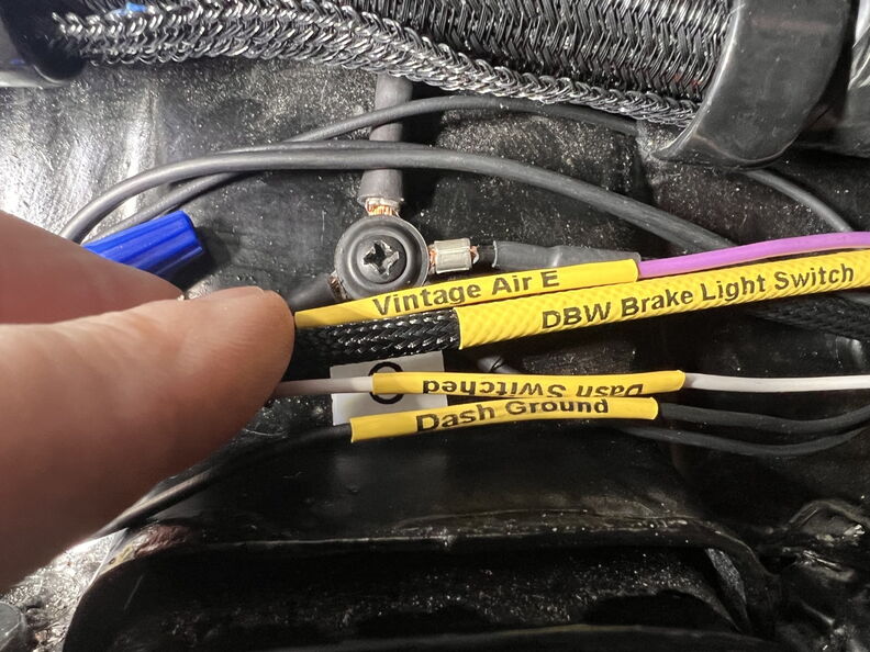

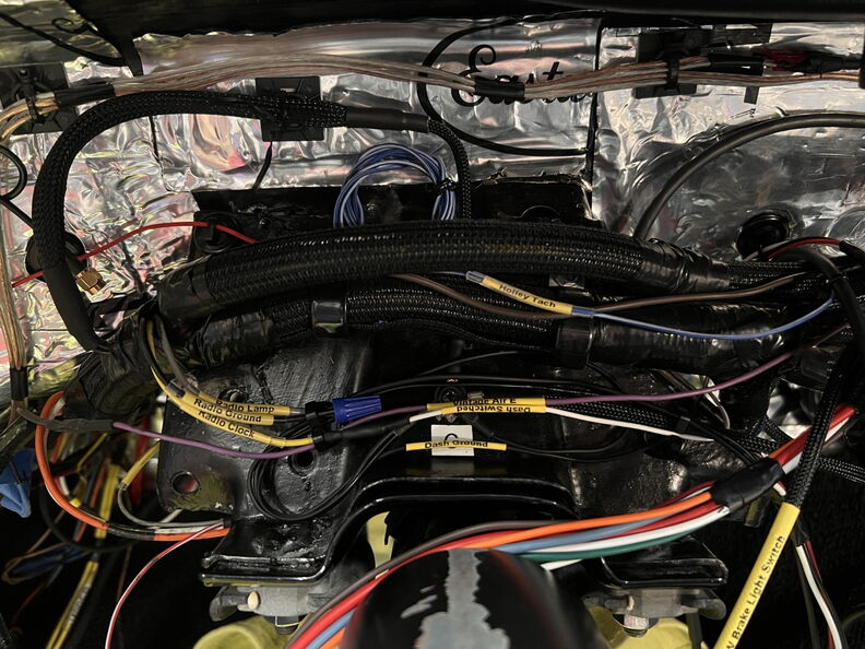

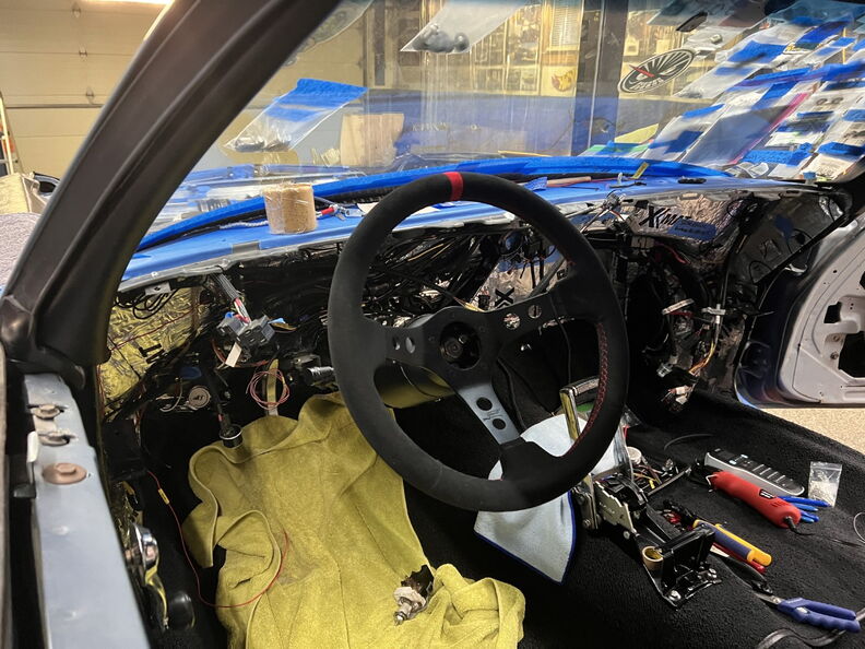

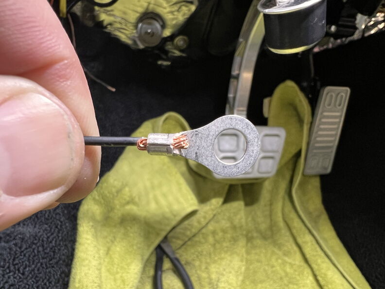

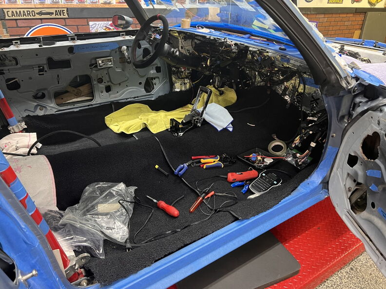

Default Holley Digital Dash Wiring (( 03-26-23 ))

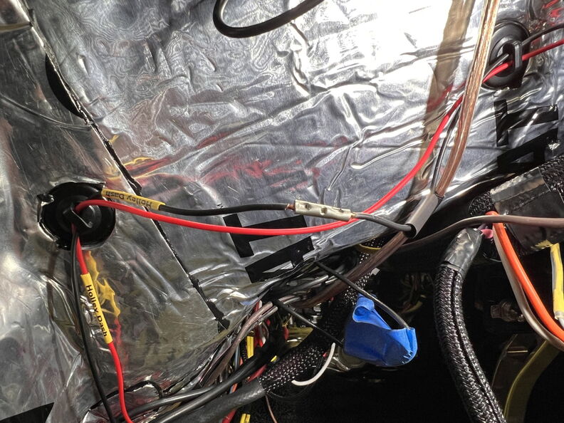

Have I ever told you guys how much I love wiring...
This time I took out the battery
I love these butt connectors
Since I am not using this ground wire I just capped it off.
I need to rewrap the headlight harness
Soon the steering wheel will be removed as it always seem to be in the way.
What a mess !!!
marty-mj

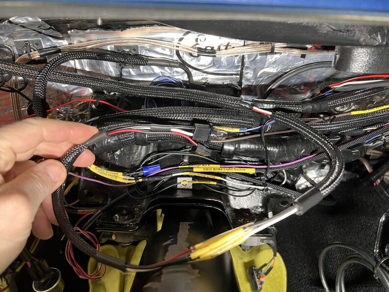

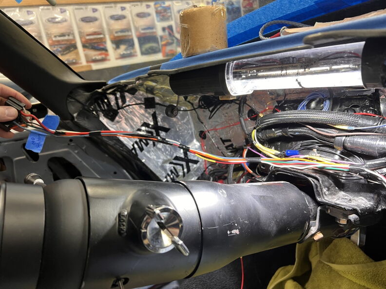

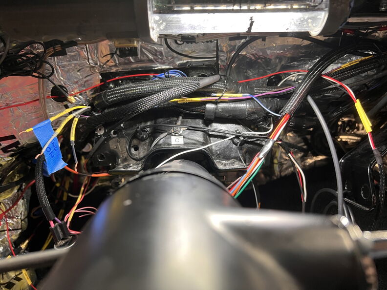

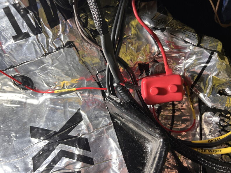

Default Holley Digital Dash Wiring - 2 Days Later (( 03-28-23 ))

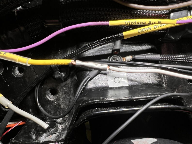

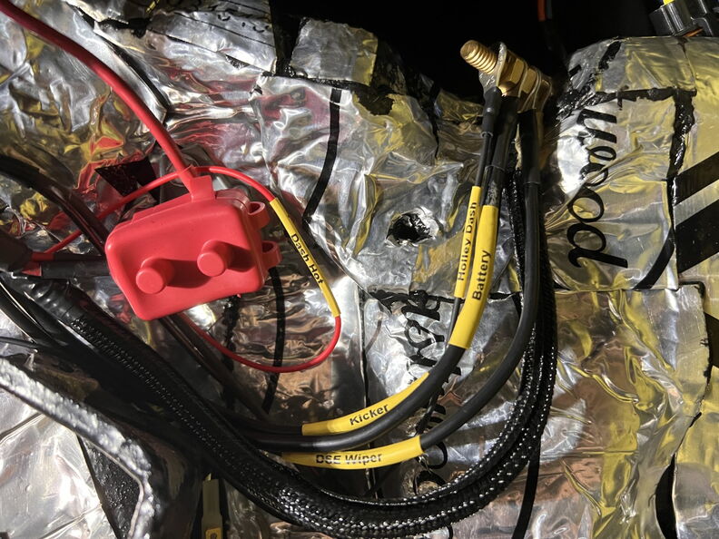

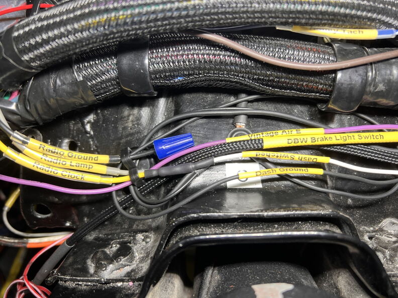

I finally had time to get back out in the garage and work on the car.
I am holding the Autometer Clock harness and trying to decide where I am going to route it.
Loom is secured down with a Mag Daddy wire clip
I wired it into the nearby circuit breaker
I relocated the dash ground ( per Holley instructions ) to the Kick Panel Ground Stud
I ran the Holley Dash wires through the Mag Daddy mounts to keep it nice and tidy.
marty-mj
