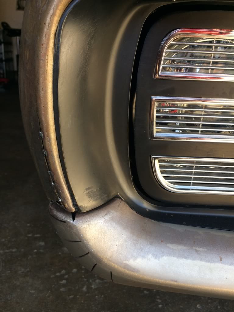

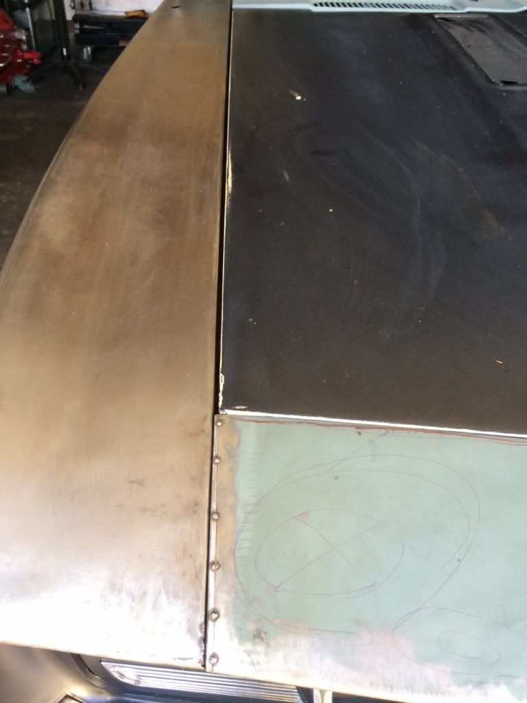

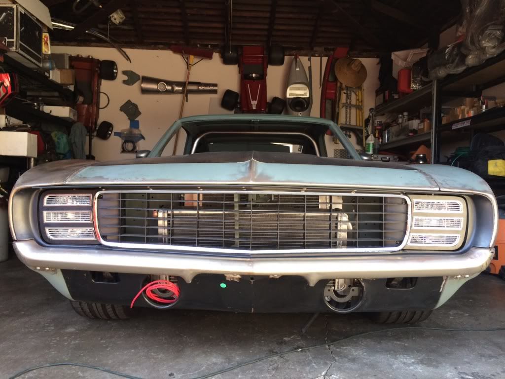

A few more pictures of the front , coming along . Still got work to do where fender meets header panel ( slight buckle ).
Hood it's there I'm just debating on buying billet hinges or stocks to finalize gap. I have old stocks in there now and they pretty worn out.
Header panel will get cut with thin dremel blade in between spot welds to get some good penetration.
